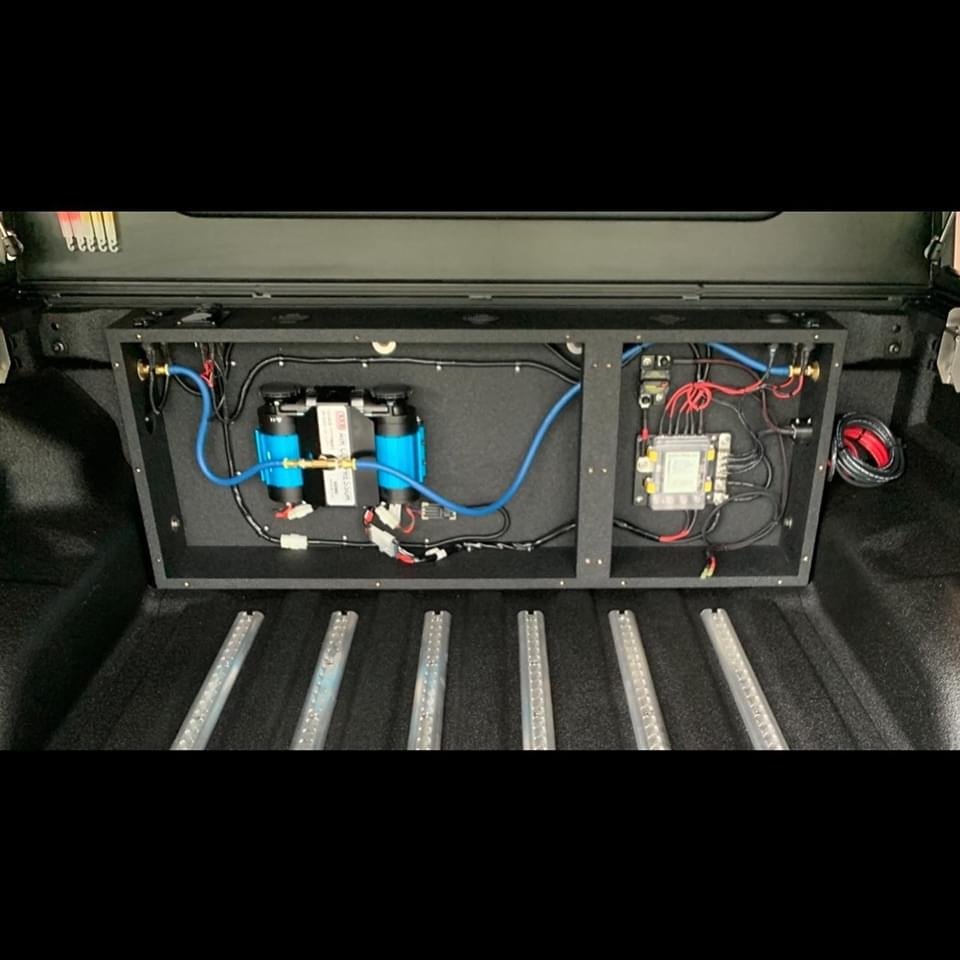

    Doing a cost writeup. Not including my labor costs, because I have no idea what those would be.
    6061 1/8" aluminum sheet ordered from here. Also got one for my tailgate.
    https://www.midweststeelsupply.com/store/6061aluminumsheet
    (2x) 55x17.5 - $140 shipped
    CTEK D250SE - $341 shipped
    https://www.amazon.com/CTEK-Overlan...&qid=1653697180&sprefix=ctek+d,aps,159&sr=8-1
    Newapowa 100w solar panel kit, 2pcs - $159 shipped
    https://www.amazon.com/gp/product/B07JX61QJ5?ie=UTF8&th=1
    BougeRV 10ft 12ga solar wires - $18 shipped
    https://www.amazon.com/gp/product/B08DCS662P?ie=UTF8&th=1
    8 gauge 25ft Red/Black wire - $22 shipped
    https://www.amazon.com/gp/product/B0895LKB2L?ie=UTF8
    various terminal connectors/heat shrink/braided loom - $40 shipped
    various nuts/bolts/washers - $10 shipped
    Total ~$650. Note, these are the prices that are listed today. When I started buying things around September 2021, things were less.
    I also have a blue sea 6 fuse panel and a 60a breaker. Not necessarily needed, but its going to allow me to add accessories like fridge, bed lighting, and diesel heater in the future.

    I have my ARB dual compressor there, but nothings cracked or broken..

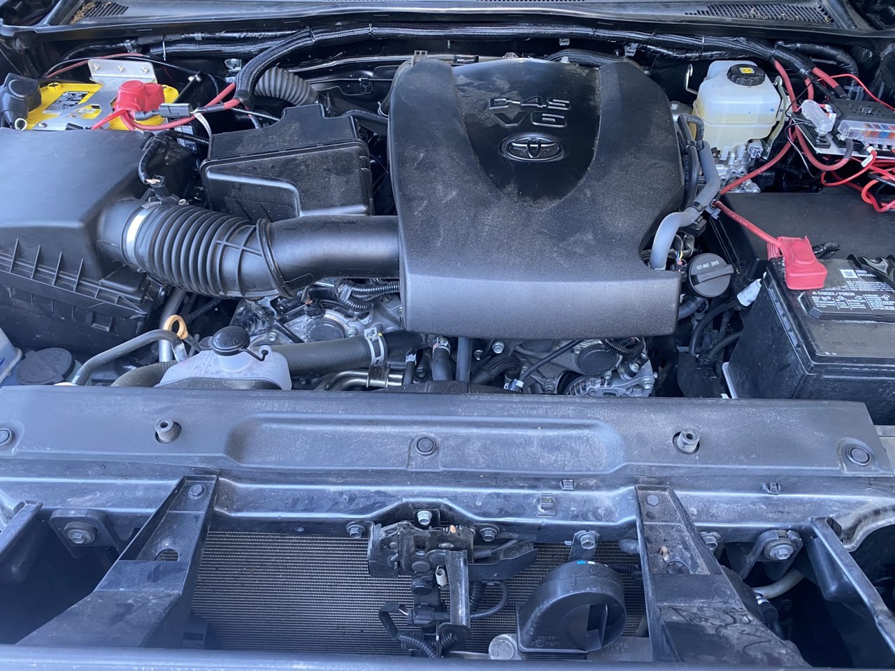

    And also widening a few lugs. But here’s the AGM battery setup:

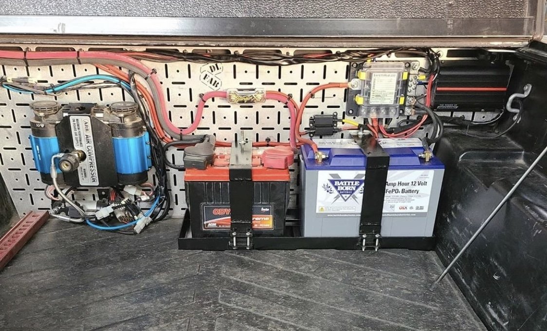

    I'm just now getting into the power side of things and trying to figure out where to set things up. Any issue with all of this being exposed? Or are you covering it in some way?

    I haven't had any issues with it being exposed. But i also dont have anything flopping around in the bed. When i camp, things are pretty much secured

    Well I really like the idea of that mounting location. As you can see from my picture, I do have a cap, but it's not impenetrable. So just curious - thanks for the respone!

    A few pages back I posted my build costs. I was copying from a few other, but with what i need the power for. I havent had any issues with water intrusion either. I also have a cap, or well GFC, but also not impenetrable.
    my inspiration:
    maybe later I'll build an enclosure, but for now its good
