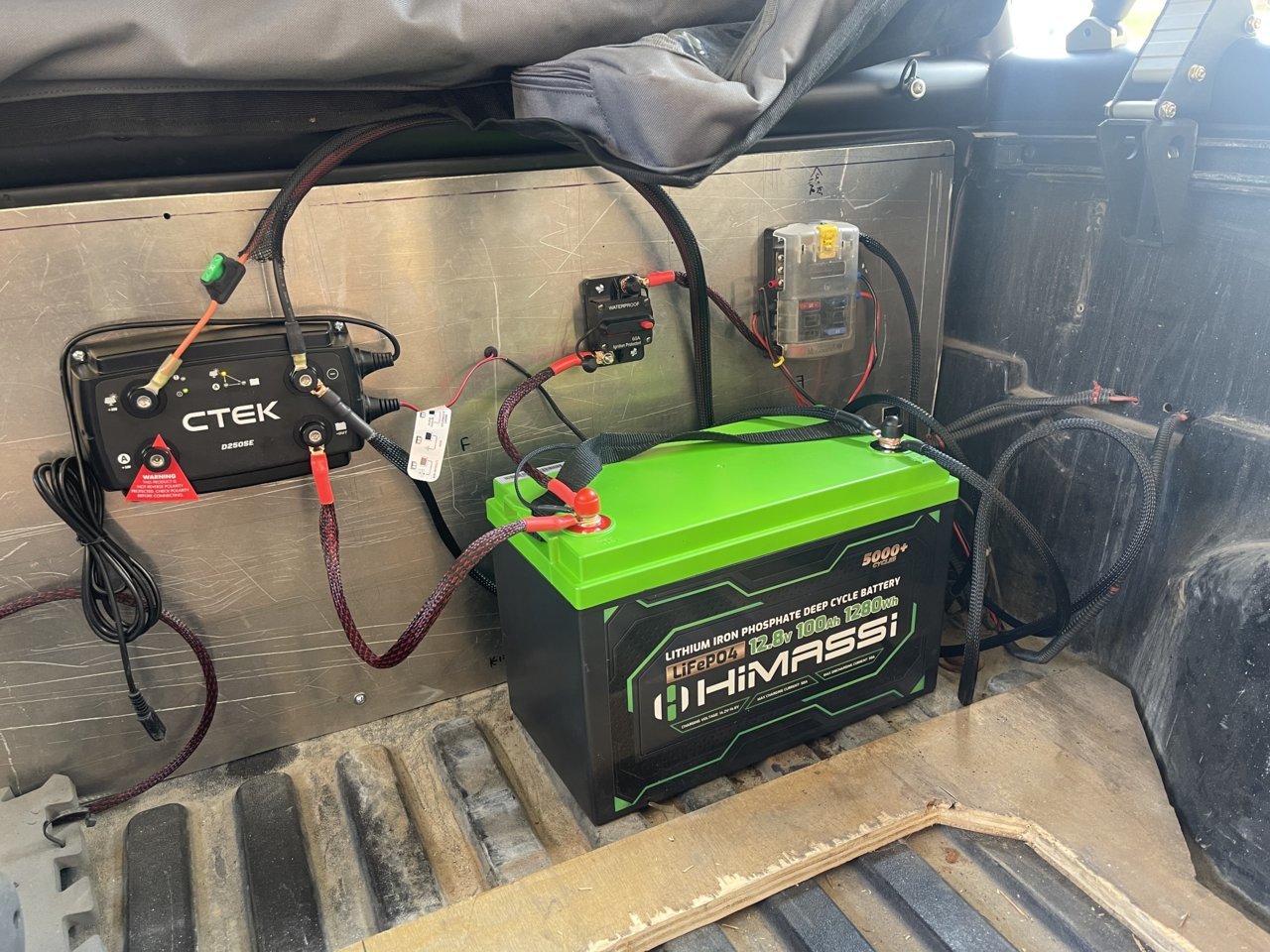

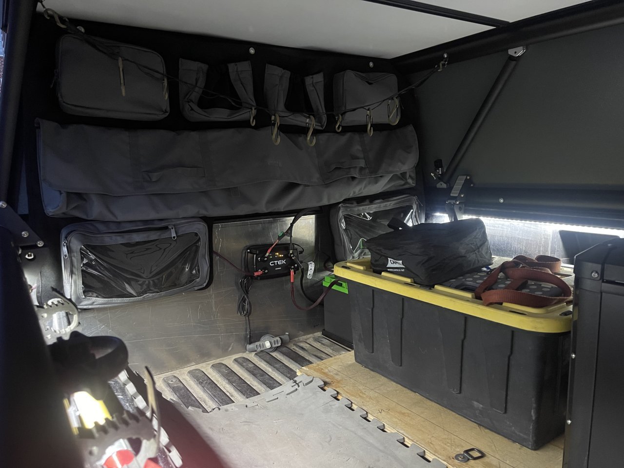

    Those are not mine. My setup doesn't really compare because I don't have my air compressor there. But thanks!
    Mine finished and kinda hidden back there:

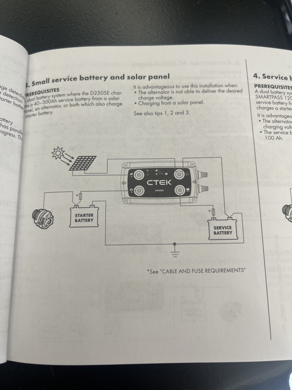

    I have a CTEK dcdc charger. It needed an ignition signal to start charging from alternator (but I attached my + to the house battery)
    Im not sure what LC is
