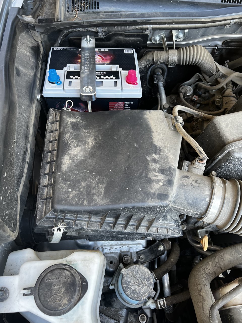

    I installed the Off-Grid Redarc setup yesterday. I don’t have a solar panel yet. So far so good. B4642198-527B-40FB-9B2F-5C9B1F9AB0C5.jpg
