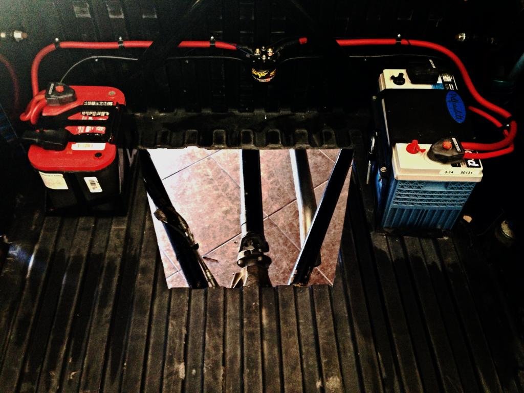

  5. Dec 9, 2014 at 12:05 PM
    #345
    tacomonazul
    tacomonazul Well-Known Member
    Mar 4, 2012
    #74163
    3,384
    Luis
    SOCAL
    07 DCSB LT/4LINK
    http://www.tacomaworld.com/forum/2nd-gen-builds/227832-my-never-end-build.html
    Finished mine, I'll switch batteries around so the optima is for the engine and the platinum is for the sound system

    I am not if you noticed or not, but there is a hole in the bed of your truck. :eek:

    Ohh thanks man! If you don't tell me I don't notice it hahah. jk jk
    It's because of the 4link suspension, the differential goes all the way up and the upper link mounts go throughout the bed

    What should I use to protect the cables in the bed?

    Protect how? I like to use braided loom. There are all different types of the loom also. Kevlar, heat resistant, burn proof, UV etc.

    Just some protection so its not just the cable in the bed, just to protect them from dirt, rocks, water all that shit

    Impact resistance, split loom. everything else, braided loom.
