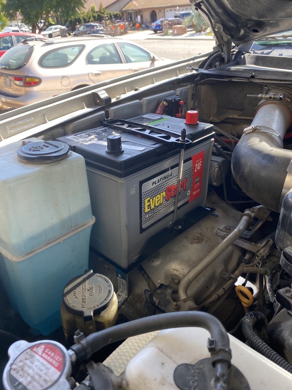

    Got the 2nd battery mounted. Went with dual Everstart AGM batteries
    Looks like the closest ground would be straight down to the frame
  11. Oct 8, 2022 at 8:36 PM
    #3591
    deadhed61
    deadhed61 :notsure:
    Oct 23, 2011
    #65723
    8,107
    Santa Barbara, Ca
    The Black Pearl
    A little lift and a little armor
    Braided line to the sheet metal wouldn't hurt either if you have radios onboard. :cheers:

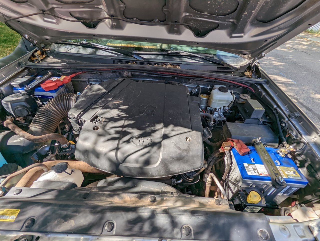

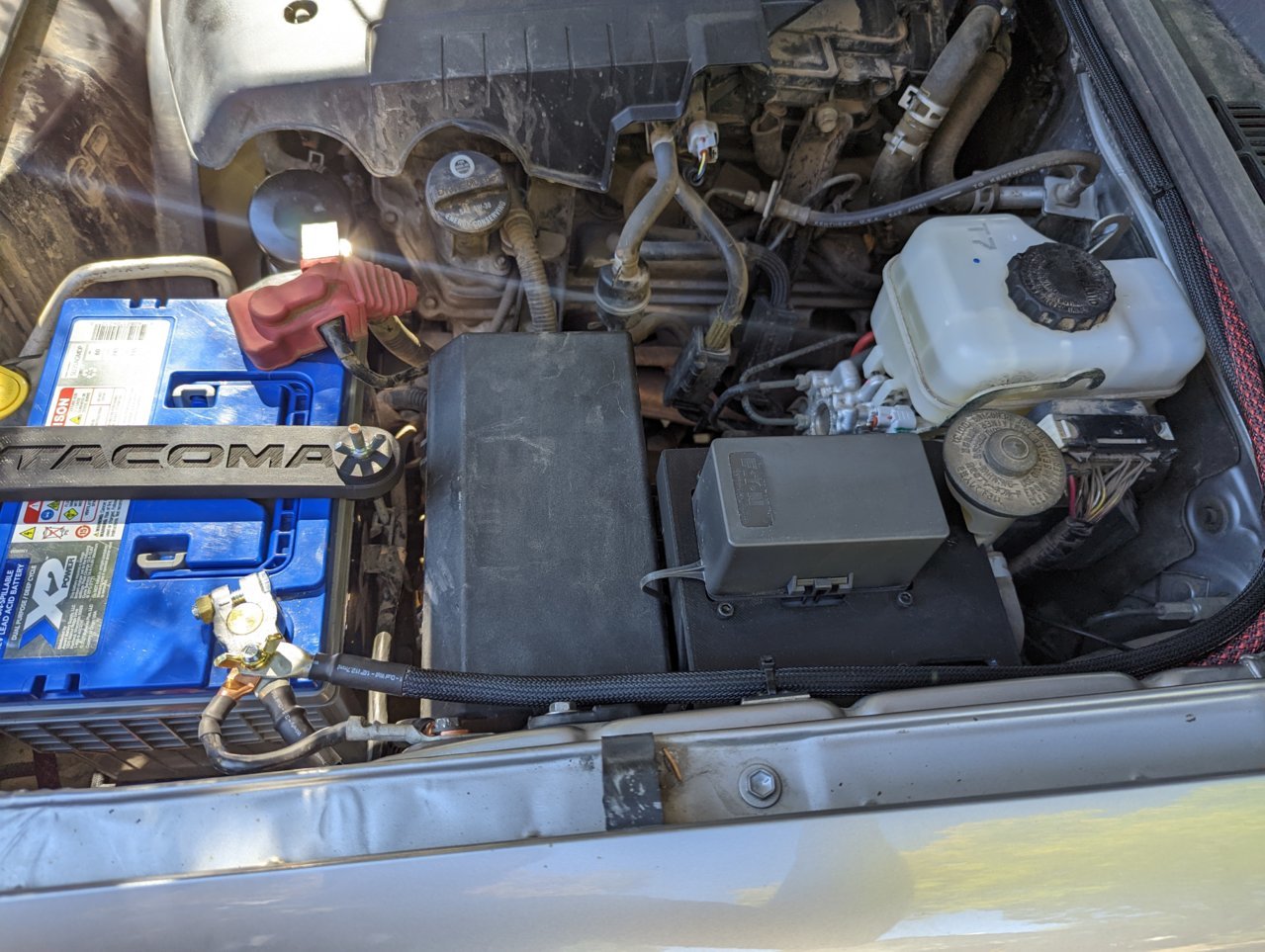

    I completely re-did my dual-battery setup recently. I designed and printed the battery holders and aux panel mount myself. The goal with the aux panel was to keep it small and clean. It also has a place to mount my clutch reservoir since I have a manual.
    TacoEspecial, JDSmith and point45 like this.

    What material/filament did you use?
  16. Oct 9, 2022 at 9:19 PM
    #3596
    twhalm
    twhalm Well-Known Member
    Aug 19, 2016
    #194983
    247
    Denver, CO
    2015 TRD/OR Manual, OME , Dual battery
    It is a "tough" PLA. TBD on how well it stands up to engine bay temps. If I notice some sagging I'll re-print in something else.

    I went from the battery to the factory ground behind the washer jug and from the battery to the chassis below the PS reservoir. There’s a bolt that holds an AC to the frame I used.

    I saw that. Ended up just going straight down to the frame.

    @anthony250f I have a 34F battery set up like yours. I probably went overkill on the grounding - I ran a wire to the back of passenger head and ran a wire all the way around to the primary battery. I haven't looked in a while - I probably also ran a wire to the chasis. I had plenty of wiring left over, so why not?!
