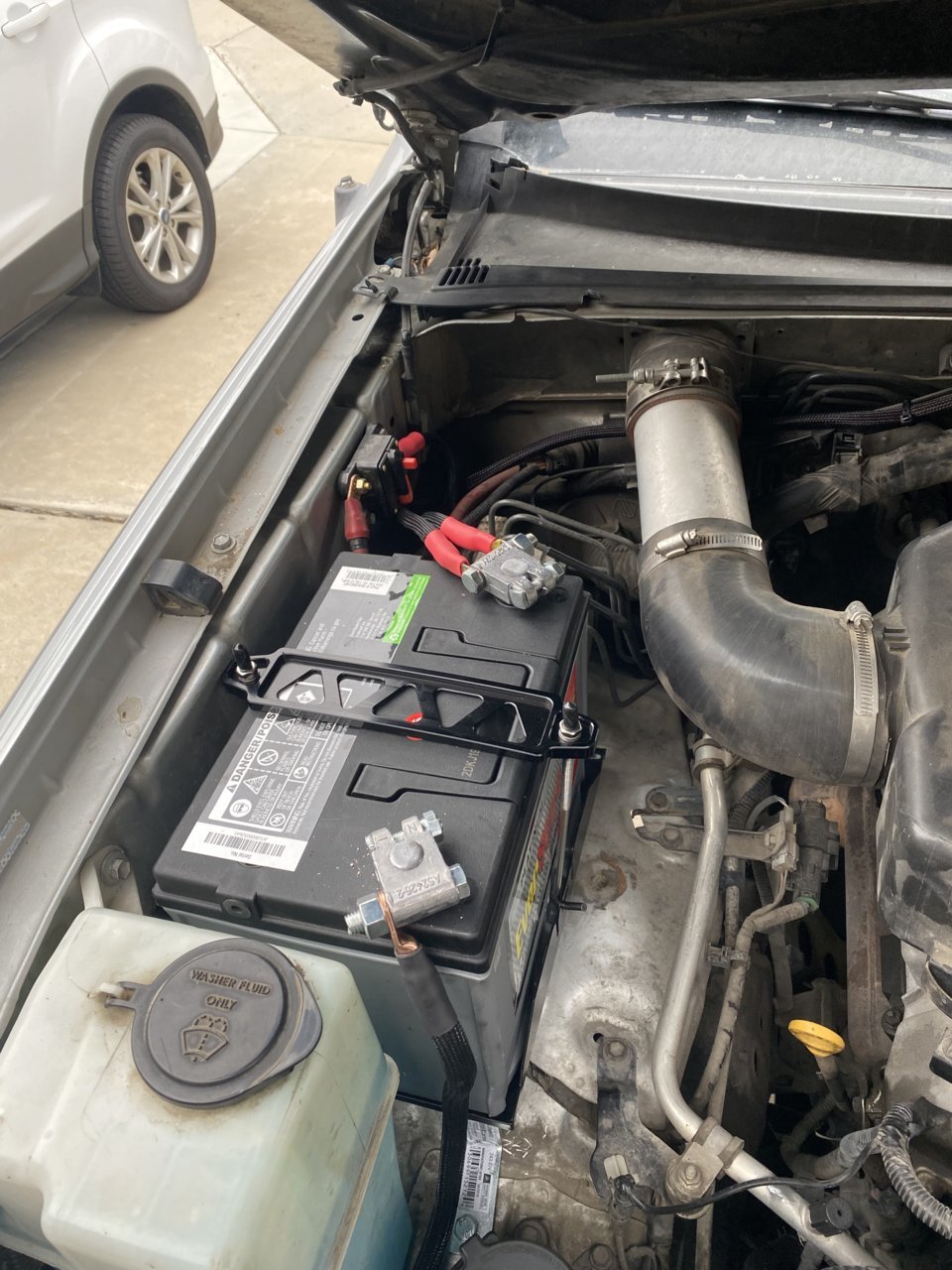

    Dual battery set up is complete.

    @anthony250f Does the air duct go through the firewall or is bolted to it? I routed mine to the front next to the radiator. I had the same battery hold-down, you will see the top bracket will move and start rubbing on the fender-wall. I ended up strapping down the battery with nylon straps.

    it does not go through anymore. Instead I bolted a flange plate to the cowl first wall and attached it that way so there’s zero vibration/sound
    the battery hood down is actually pinned sup against the fender wall. I will keep an eye on it but it seems really secure, was thinking about using the same one for the starter battery location.

    @anthony250f If you don't offroad, the bracket may not move much. Or, maybe I didn't bolt mine down hard enough. The straps are working for me and they are easy to unfasten to remove the battery.

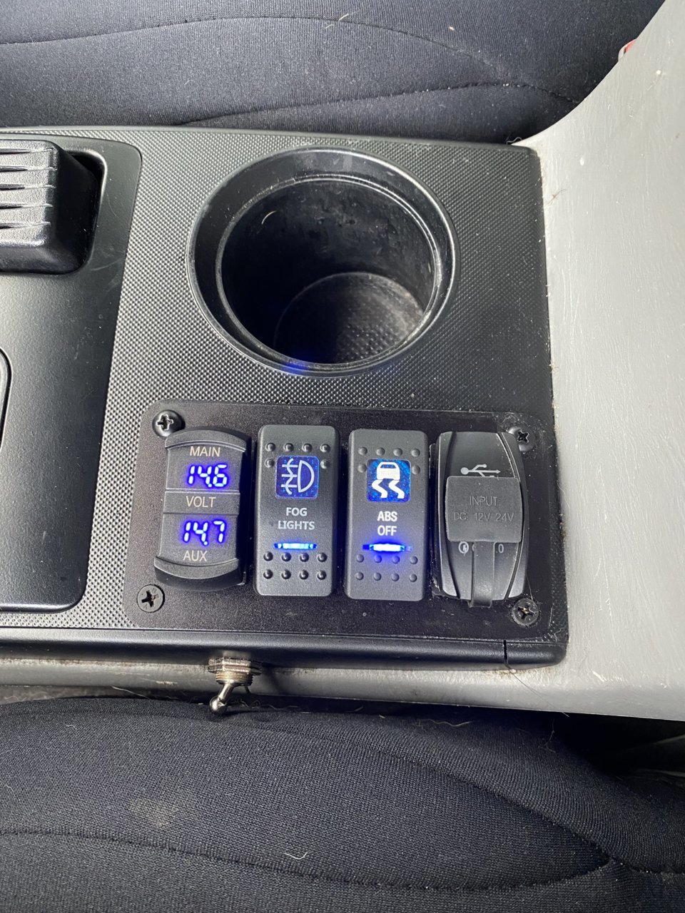

    Hooked up the dual battery voltmeter today. Had to use a relay so it was on with the ignition only

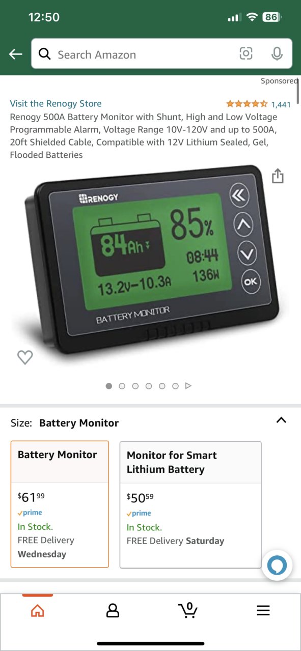

    Quick question about the Renogy/off brand battery monitors..
    how does it work when I have a starter battery connected to my dcdc charger? I know my starter battery charges the secondary battery (lithium in my case), when solar is not charging it. And the dcdc charger also trickle charges my starter battery, from solar or the secondary.
    Will the battery monitor pick up on that?

    Renogy Battery monitor available on Amazon for $62. Normally $105? Im going to snag one.

    The same shit everyone else has.
    I use one on my set up.
    Pretty happy with it even though the first one I ordered was defective

    Ordered. It was kind of off putting when I was testing my diesel heater yesterday, and I couldn't see what it was drawing. The instructions are also dumb, so that didnt help either.
