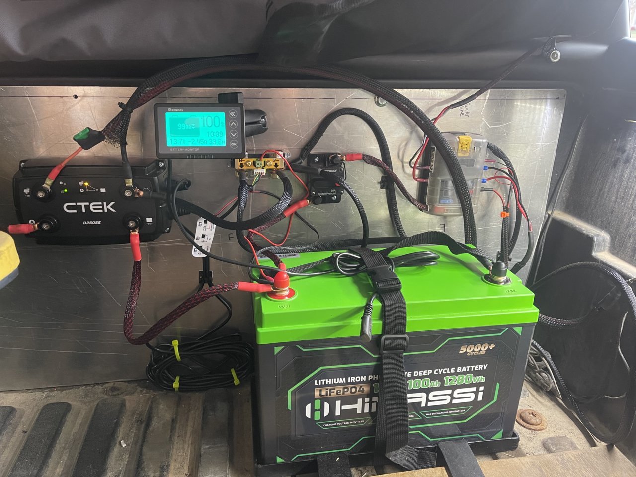

  14. Dec 9, 2022 at 9:38 AM
    #3634
    Zebinator
    Zebinator Well-Known Member
    Nov 30, 2014
    #143381
    918
    Norcal
    06 Tacoma TRD Offroad
    Whoa I need to check out more about your mod there. Really cool!!

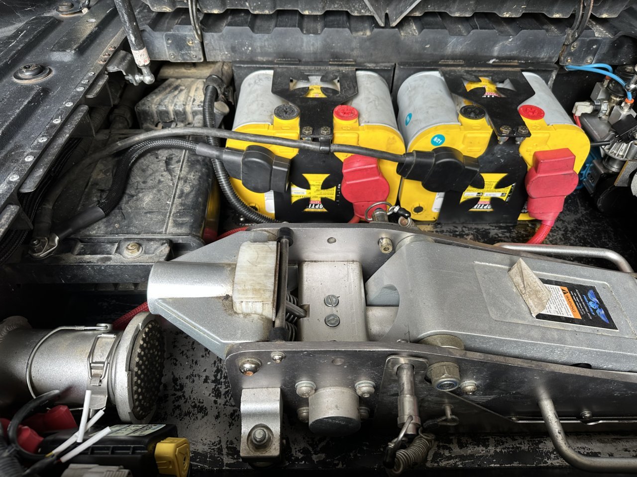

    13 Sliver TRD AC
    BAMF RCLT Deaver Fox 2.5 StopTech Dana 60 37s 475:1
    You could run 3 group 35s (I'm doing this)
    One on passenger side and 2 in stock position.
    Use 2 for aux.
    You could also use a group 35 in the passenger side and use it as your main.
    Then put a group 31 in your stock location.
  16. Dec 10, 2022 at 8:24 AM
