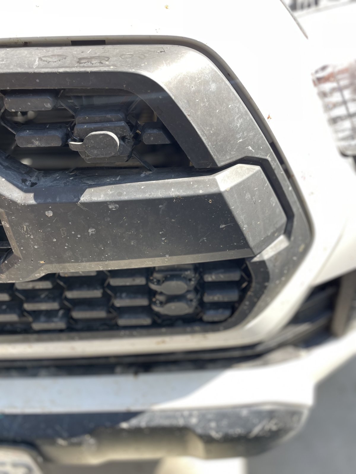

    Looking to add a a set of terminal for a set of jumper cables.
    The remote terminal was one half of an Anderson connector that was wired to the battery.
    The Anderson connector itself was mounted in one of the cutout of the metal bumper.
    The other end of the Anderson connector was a set of jumper cable ends.
    I have a good idea on how I would do this, but was wondering if anyone had a picture of this.

    I have all the parts figured out short of how I’m going to mount the Anderson connector to the bumper itself.
    Really just hoping to stare at the picture I recall seeing.

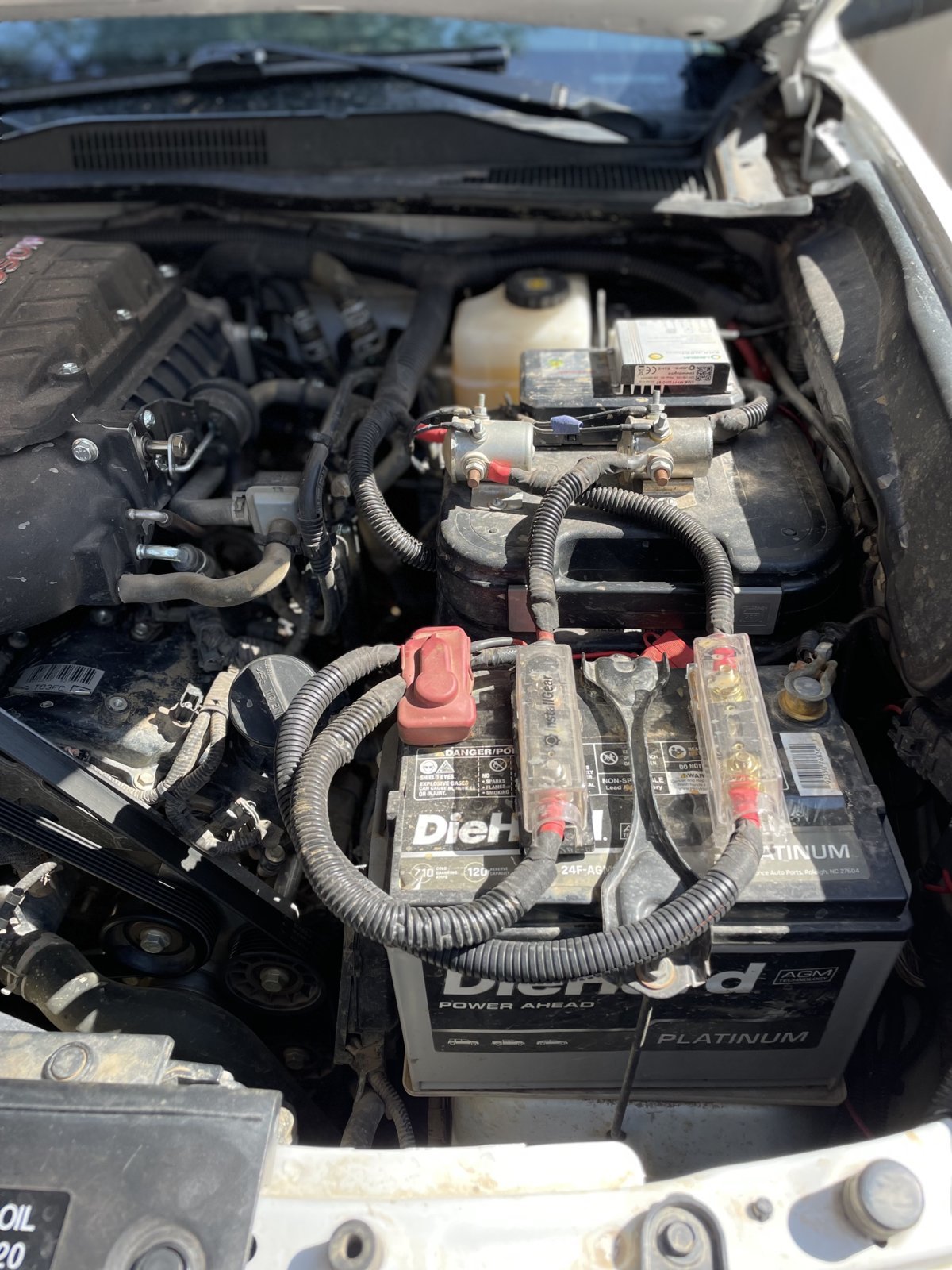

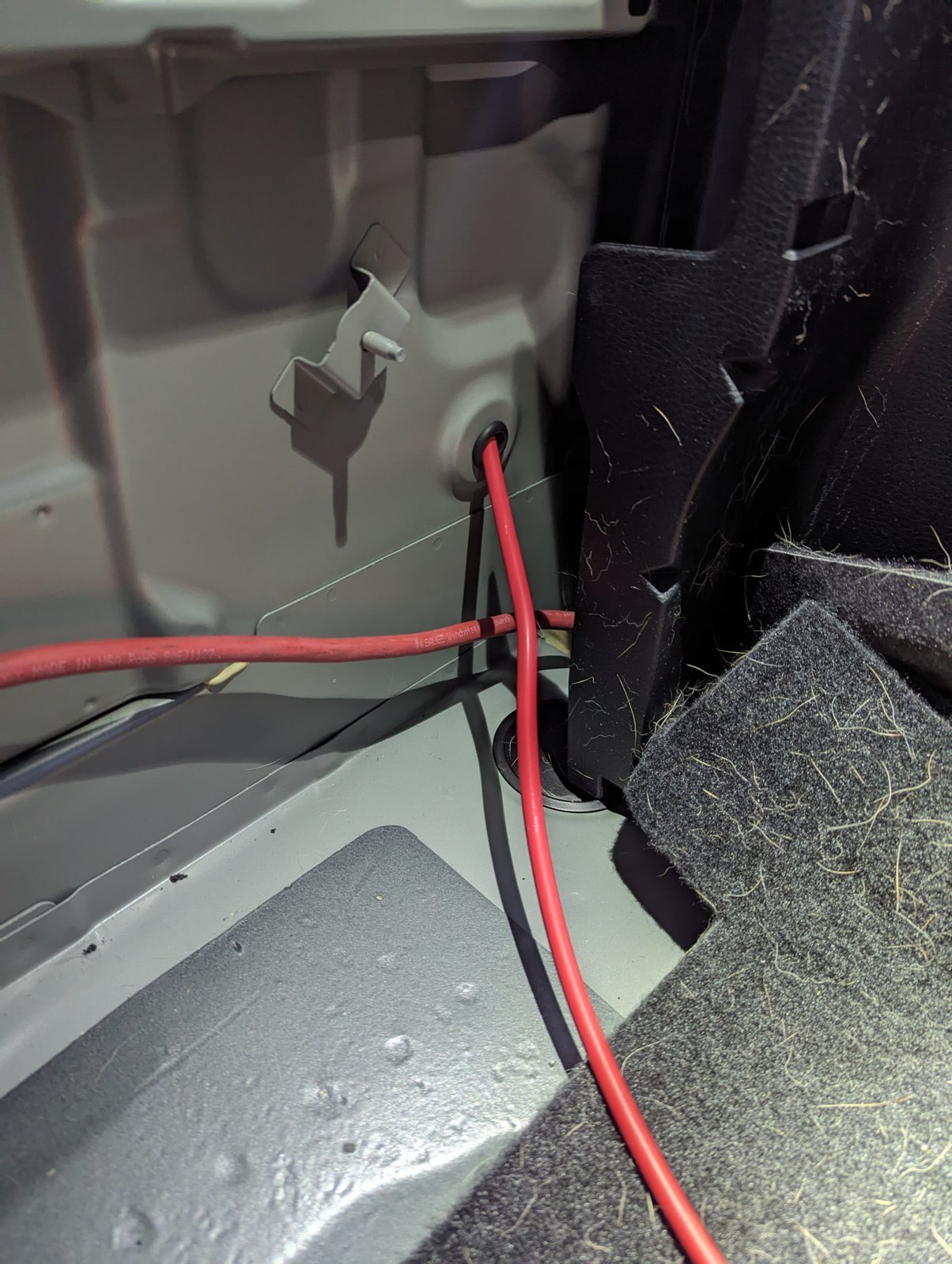

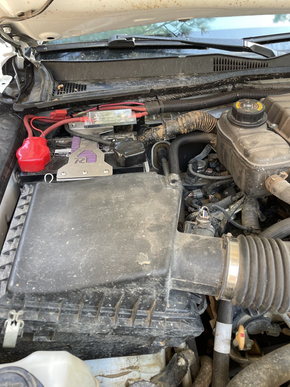

    Does this look good/do y’all have any improvements?

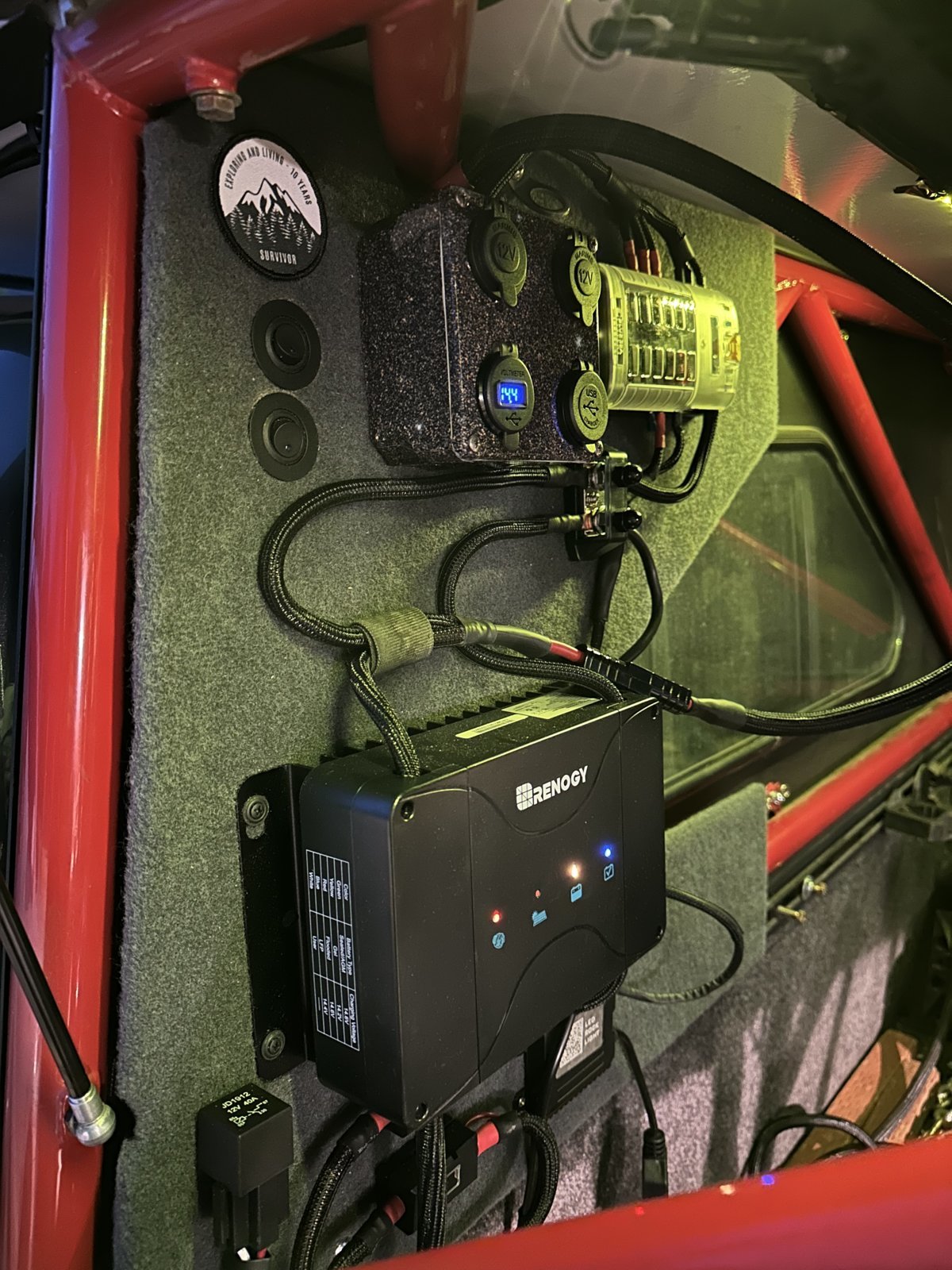

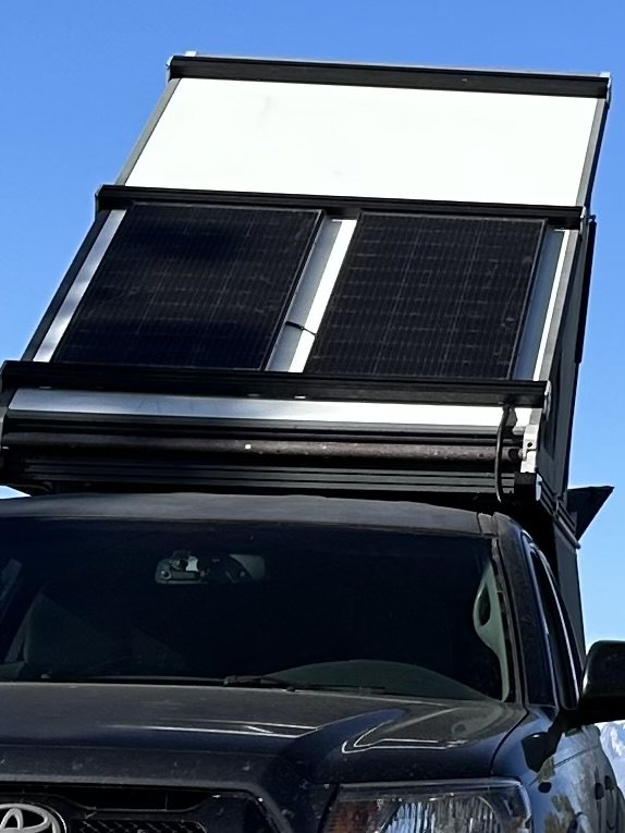

    My dual battery setup consists of a renogy 50a mppt, a group 27 X2 starting battery (also powers the winch), and a group 24 100ah lithium house battery in the bed.
    It is charged off a pair of 100w solar panels or the alternator when running.IMG_9343.jpg

    It looks good.
    I will suggest you put the fuses on the long wire between the starting battery and (DC/DC / 2nd battery) at the starting battery (or close to it). That way, if there is ever a short, the fuse will blow, and the entire wire will be dead.
    Depending on the distance between the DC/DC and the 2nd battery, the fuse should be close to the DC/DC.

    If that’s the only wire running out, where in the cab did you ground to?

    There are plenty of bolts under the seats/behind the seats you can ground to.

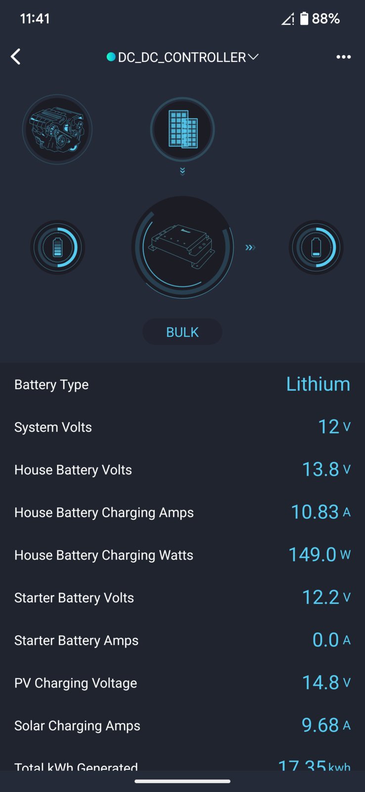

    @stickyTaco is correct. By the time you fart around with jerry rigging all sorts of nonsense, a dedicated dc/dc charger will be well worth it. They can be had for relatively cheap. Wiring a dc/dc charger will also be safer and look better than having a trickle charger hooked up to the battery. Youve gone through the trouble of having a second battery, why half ass it? I'm running all renogy stuff for the reliability vs price. I have a 100 aH LiFePO4 battery, solar panel, and a 50 amp dc/dc charger. Hook it up once the right way and get the peace of mind.
    This is a small snippet of what I get as a readout (varies depending on usage etc)

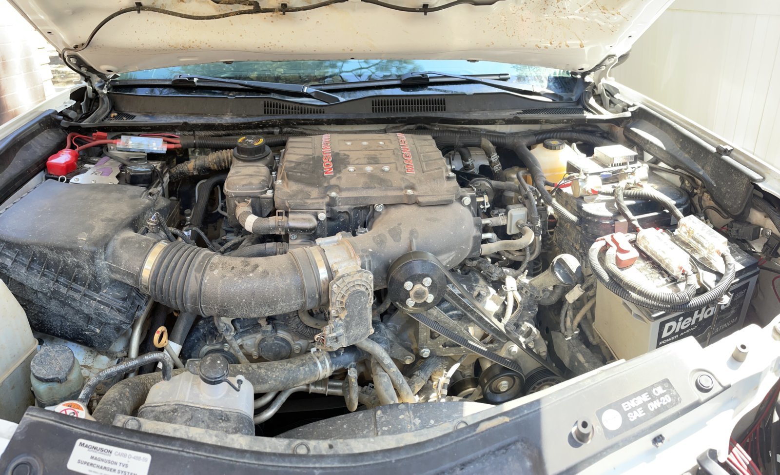

    Here's a few pictures of my dual battery set up...It's a bit of a home brew style set up with an analog connector that bridges both battery's together when the ignition is in the "on" position. All accessories (Fridge, interior/exterior lighting, misc. power, GMRS radio..etc.) are all for the most part running on the axillary battery. My onboard air is rigged up to the starter battery to be closer to the alternator but is only able to be activated when the truck is on and running. All of my accessories are controlled by an AuxBeam controller mounted on the top of the fuse box on the drivers side and the MPPT controller (mainly for a quick disconnect solar panel I use) is mounted on top of that. The quick connects on the grill are for a trickle charger (bottom connections) and a remote solar panel (top connection) so I can have the truck in the shade and move the solar panel with the sun.
    There are for sure much better systems out there like Redarc that provide an out of the box solution. I very much like to tinker and wanted to build a solution myself that is easily replaceable...etc. should parts fail (I was inspired by one of Overland Bound's YouTube video).
    As is any build of mine...it's constantly evolving as this is probably build three for electrical so far! :rofl:
