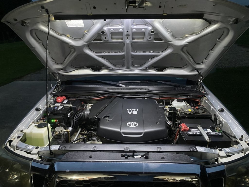

    Primary - Everstart Maxx 24F 750CCA, regular flooded, unk AH, installed 11/19.
    Secondary - Weize 48/H6 760 CCA, AGM, 70AH, installed 4/24. Replaced a Deka Intimidator 34F that lasted 7.5 years. I still have this battery, but its current CCA of 105 barely starts the Taco. The Weize is made in China and I got it mostly to see how good it will be. Out of the box, and after a charge cycle, it tested a disappointing 675 CCA, of claimed 760, but it has not gone down from that. So far, not too bad for the price, $123 on Amazon.

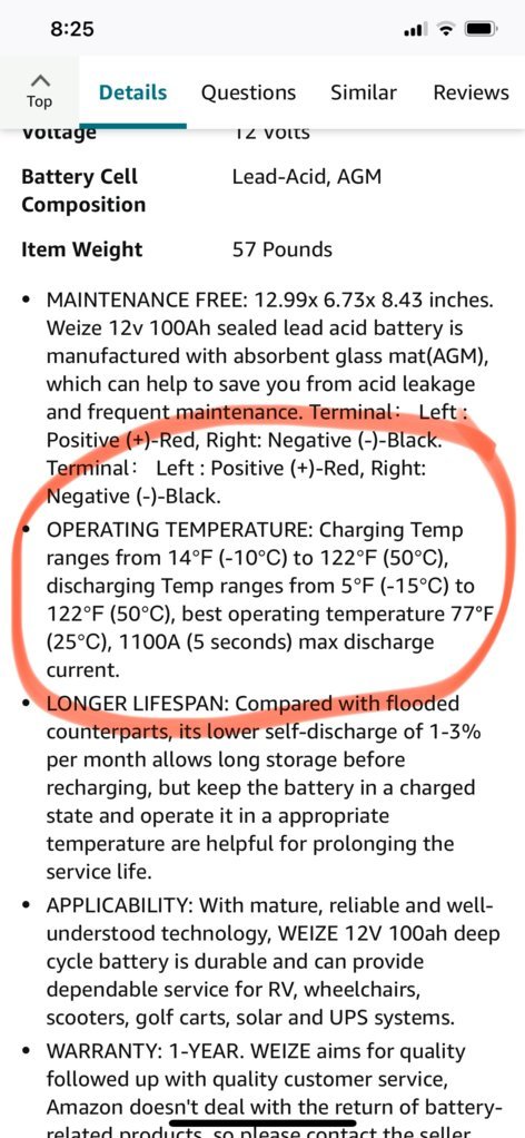

    Is the battery mounted under the hood?
    Their operating temp range seems to be too low to safely run under the hood of our trucks from what I’m understanding.

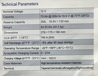

    Didn't notice that. What is temp range? Yes, mine is in engine compartment on pass side.

    Ideally that’s exactly what I want to do.
    My lead acid house battery needs replaced again because the batteries are junk and I’d like to upgrade without redoing the whole system.
    I’d simply like to drop it in the same exact location as the existing battery under the hood.
    I know a lot of people run AGMs under the hood, but I also keep reading that AGMs don’t like the heat.
    A 100ah Weize battery is only like 20$ more than a replacement FLA deep cycle from the parts store.

    @steveo27 That doesn’t show max operating temps, only the ideal operating temps, and max charging temps. The spec sheet that came with my battery shows max operating temp is 158F. I checked my battery temp with an IR gun after an errand - ambient was 84 and the side facing the engine was 125F. The primary battery was 135F. My oil filter was 180F. We just had a heat wave where high was 105F. Would be interesting to see operating temp at those ambient temps, but we are not expecting such highs again till next year.

    Which size you gonna get? They have been out of group 24F’s for a while. My 2nd battery is in same location as yours and many with same setup have installed a 24F, but it seems too high for me. If the hood folds in a bit, I am too scary-cat the bottomside will touch the pos terminal. A group 34F is what I originally had in there but Weize does not carry that size. I got the H6 which was slightly too long for my tray. It fit with a quarter-inch high insert. My primary battery is five years old, and if a 24F is not available when it comes time to replace, I may get the H7.
