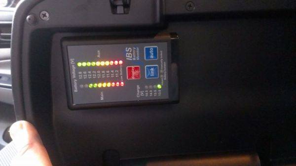

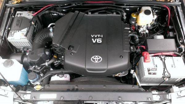

    I have all accessories(winch, light bar, rock lights, fogs, 2 additional 12v plugs, compressor, etc.) wired to my acc battery with the IBS dual battery mgt system. The IBS monitors each battery and will auto link the two if needed for additional v. I also have the option of manual linking as well as the system will shut down if I run the batteries down while the truck is shut off and allow me to always have enough power to start the truck.

    Wheres your abs module?

    Off-roads with atrac and what not have it apart of the master cylinder

    interesting location for the monitor

    valid
