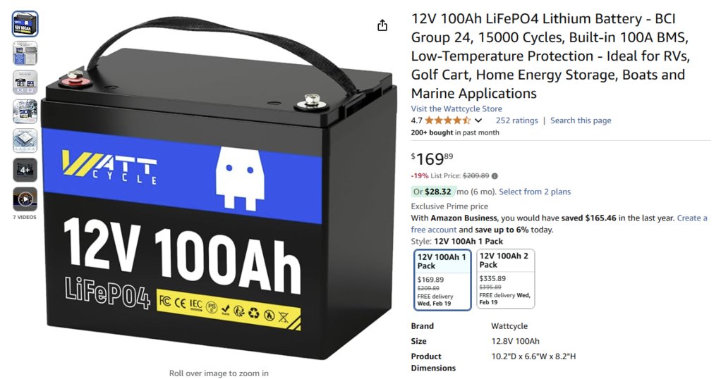

    Ummm... that statement seems a few years old to me...
    • A high quality AGM - I'm running 24F Northstars - costs $350 (X2 24F AGM) and has a usable capacity of 76Ah.
    • A good LiFePo battery - for instance, the 100Ah WattCycle recommended by Will Prowse - costs $169 and has a useable capacity of 100Ah.
    So, that LiFePo costs half as much and provides 30% more usable power. Not to mention the fact that it:
    • charges more quickly
    • can endure more discharge cycles
    • is less susceptible to over-discharging
    • weighs significantly less
    The only thing it can't do (that a second AGM could) is jump your starter battery, so there's a tradeoff there. But statements about the extreme cost and lower capacity of LiFePo batteries no longer stand up to what's out there on the market these days.
    Why do you say this? Ah are Ah, so I don't see why an AGM would be better for accessories...

    So how does that work if you have two different batteries with two different technologies? Is that where the DC-DC comes in?
    Also noticed theres about 4 different versions of that battery you link to and they're all diff prices. I assume it's just the size of the 'box'?

    Yep, the DC-DC charger hooks up to your alternator and charges the LiFePo battery (basically, takes the V from your alternator and converts it to the correct charging voltage for a LiFePo battery). For 2nd and 3rd gen Tacos, they have even to use the DC-DC charger to charge a secondary AGM, since their alternators/charging systems wont (without modification) output a high enough voltage to charge an AGM.
    Not sure what you mean. I only see two options: 1 battery, or 2 batteries?

    Scroll down to "From the Brand"...
    theres a group 24, 31 and a mini
  15. Feb 5, 2025 at 5:15 PM

    Yeah, I guess those are just form factors/cases. 100Ah is 100Ah, no matter what box you put it in, hahaha.
