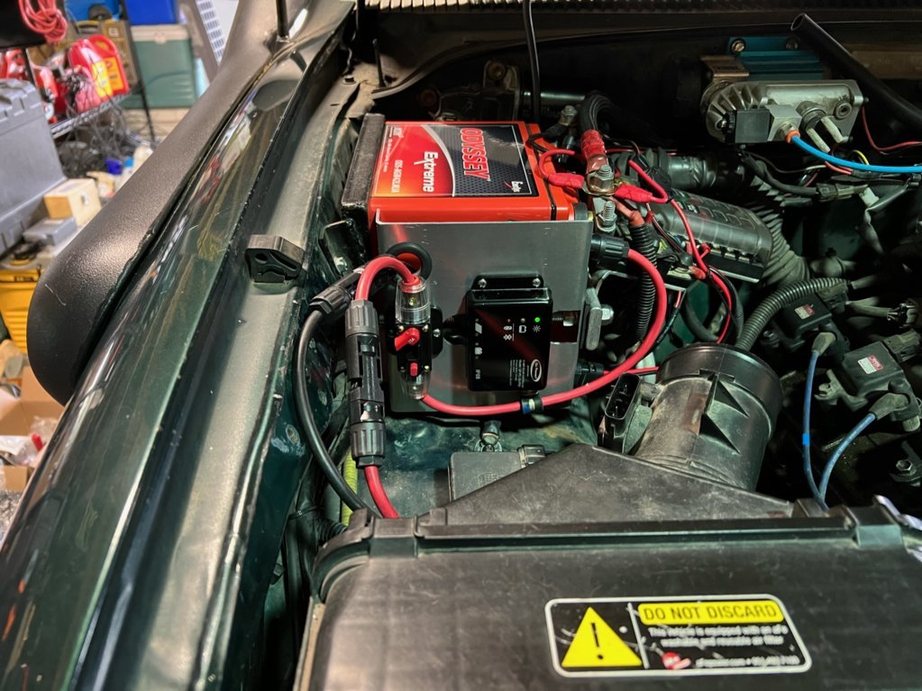

    When out, I was using a single 100watt panel and a potted GoPower PWM charge controller and it works efficiently enough to not just charge the house battery, but when the Blue Sea MLACR latches both batteries together, it tops off the starting battery.IMG_7045.jpg

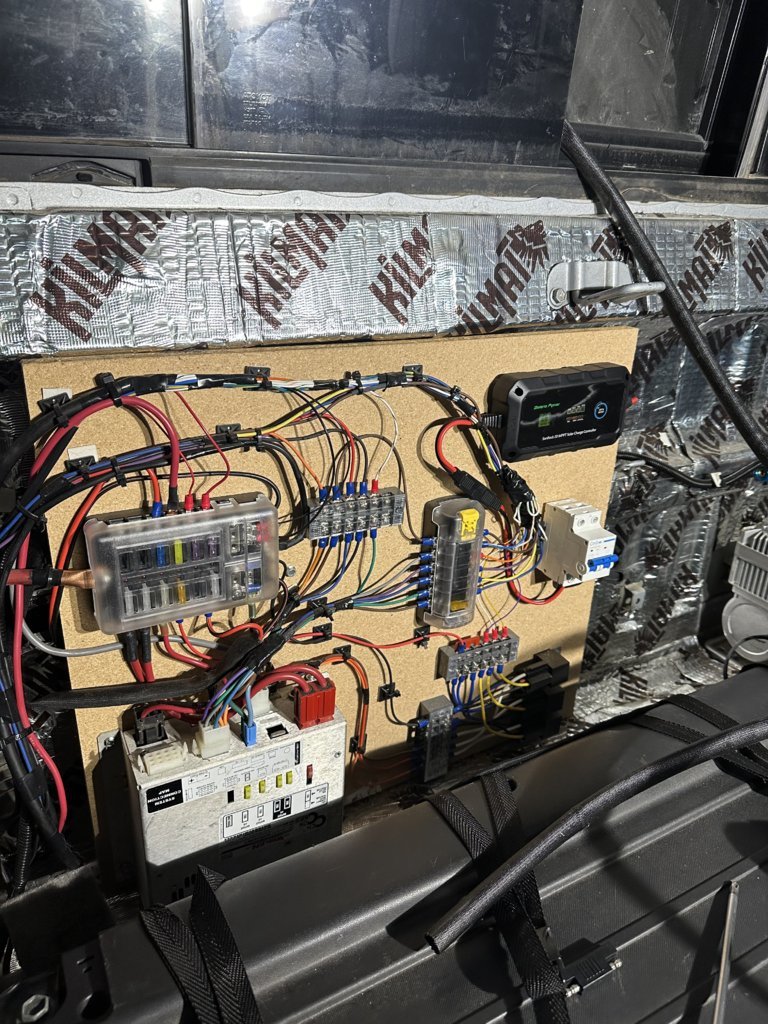

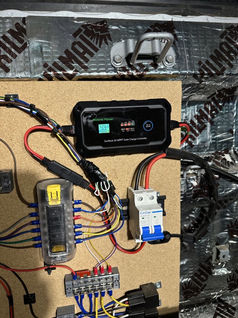

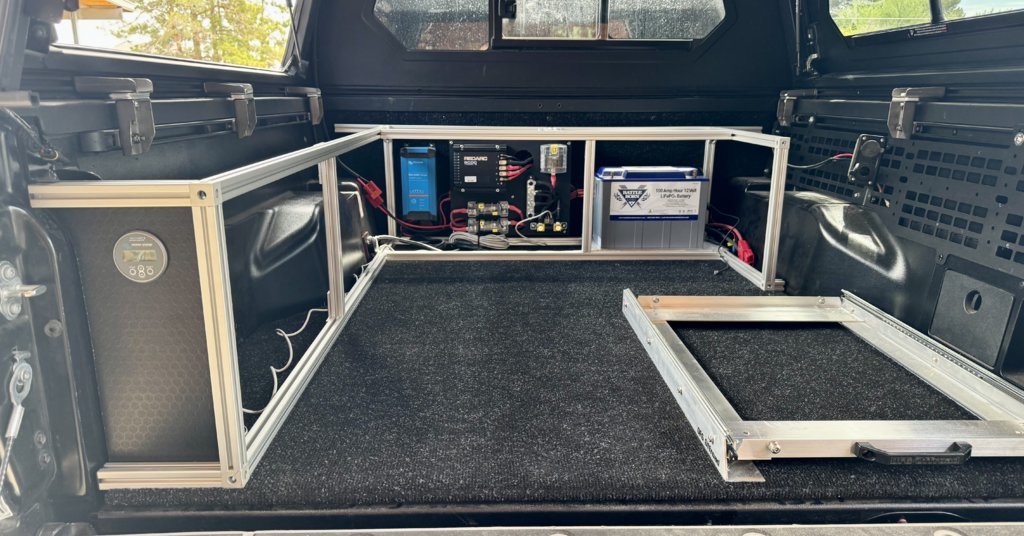

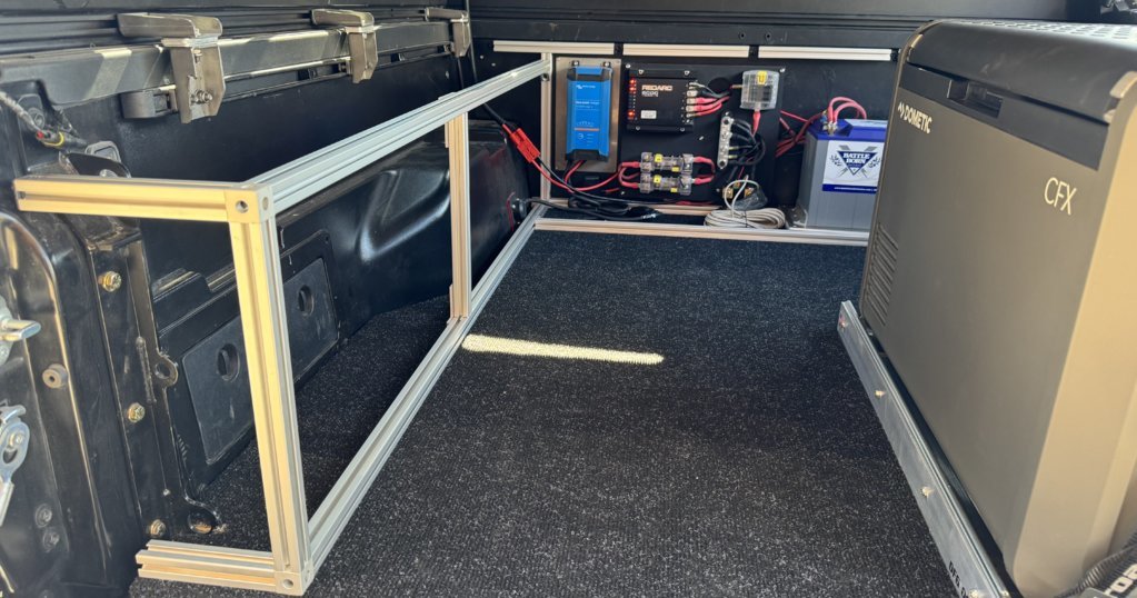

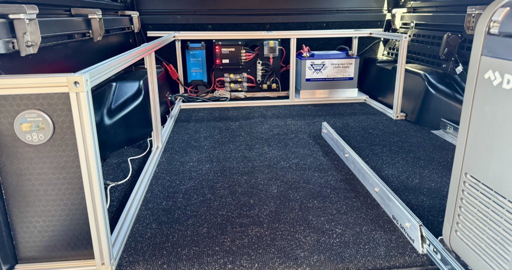

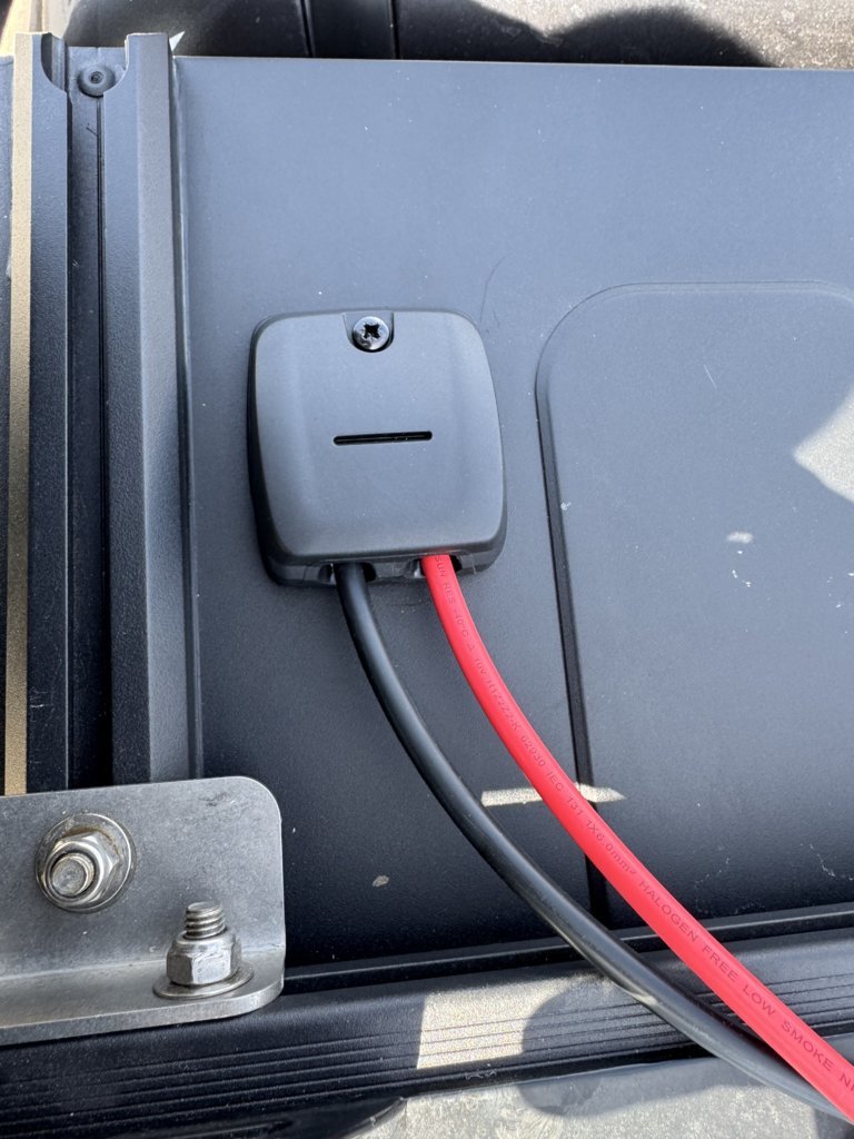

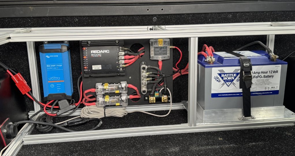

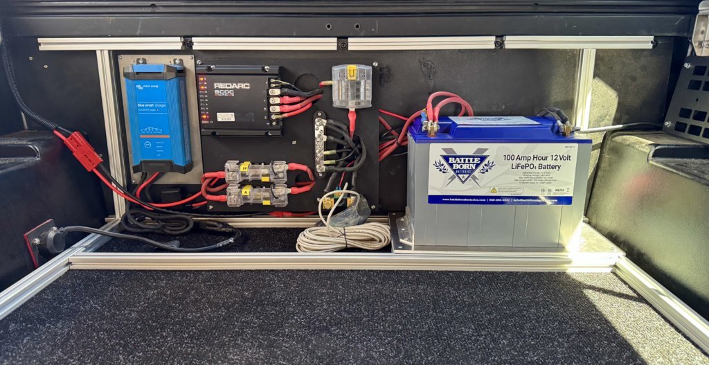

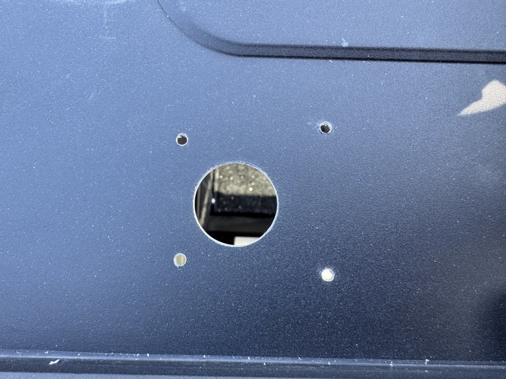

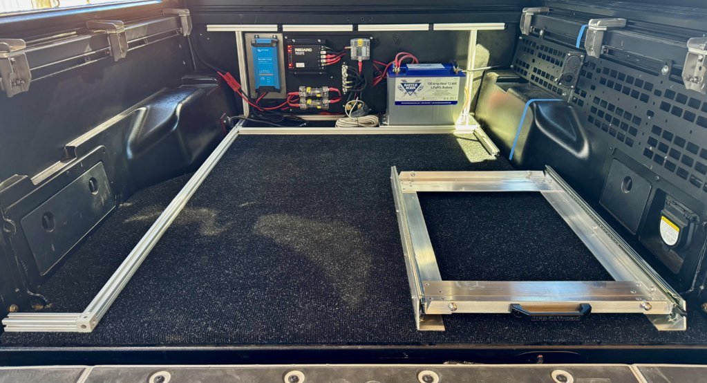

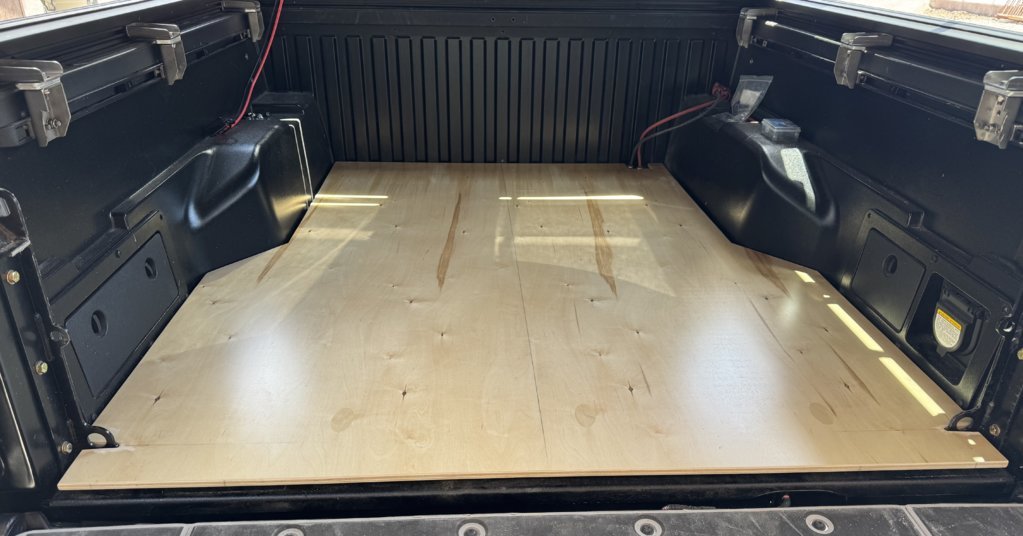

    So having had a refrigerator and dual battery system in a previous vehicle, I came to really miss the absence of having a refrigerator in my Tacoma. I've been working to correct that issue while at the same time trying to put together a system that was a bit more efficient than what I previously had.
    Probably the scariest part was drilling a hole through my contour canopy to get solar into it.
    Then I cut a piece of Baltic birch to cover the bed floor and provide a mounting base for the refrigerator and aluminum extrusion.

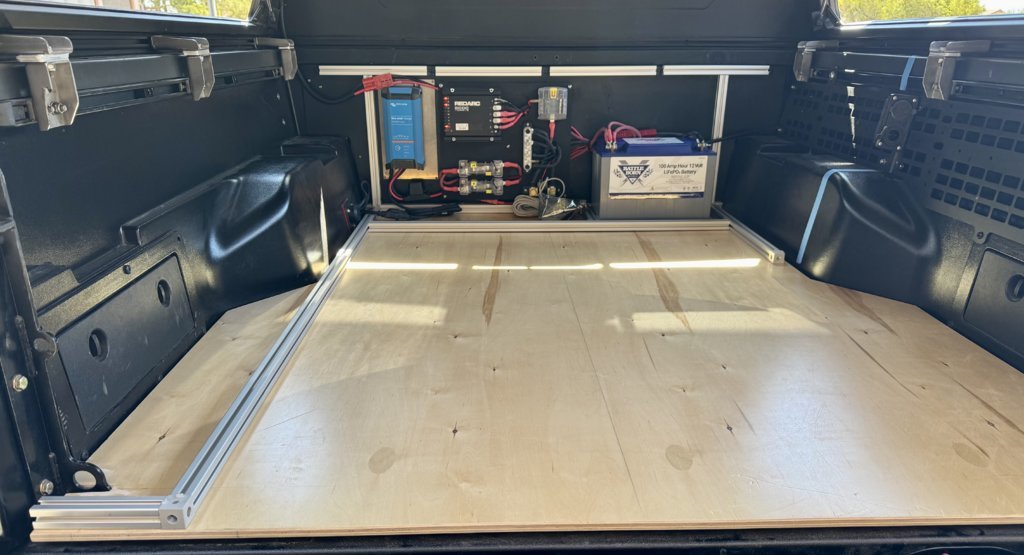

    Since i want to add some storage, I mounted extrusion to the base then will build up from there.
    So this is where I'm at so far, its a time consuming process but I'll get there eventually.
    Framed up and ready for panels..
    Tacodog, 99ranged, rob1208 and 4 others like this.

    @trezpass How did you secure the plywood to the bed? In case of a rollover will everything stay in place?
  20. Jun 10, 2025 at 1:28 PM
    #3860
    trezpass
    trezpass Member
    Dec 25, 2024
    #462942
    12
    2023 TRD PRO
    Well the extrusion is mounted with countersunk bolts from the underside of the plywood... 2 sections, the front upright portion of the bed then the bed bottom. so i got longer m6 bolts for the upright sheet of wood at the front of the bed which sits on top of the bottom section and is fastened with corner gussets. once completed the bottom piece of wood will be tied in at the front as well as the side rails, I originally planned to run bolts through the bed but the farther I got along in the build i came to realize its not budging.
