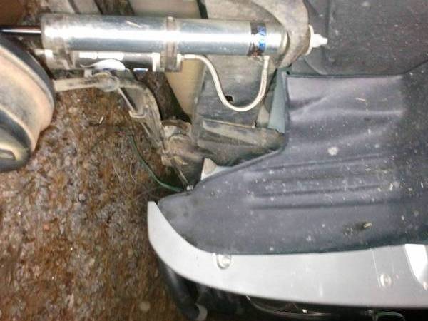

    8,414

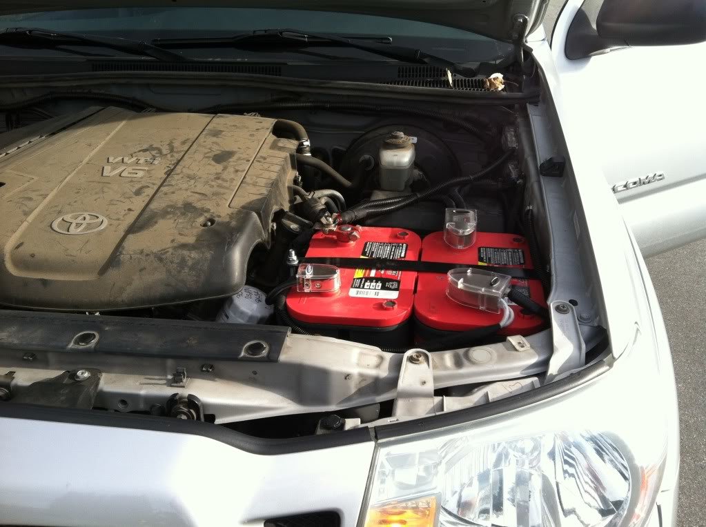

  6. Sep 22, 2013 at 3:50 PM
    #26
    skygear
    skygear                    
    Nov 6, 2011
    #66558
    8,414
    No biggie. I saw someone on another board that made one and they had a heat shield for whatever reason. I use the Stinger Digital Terminals SHT301 and the SHT303 - Makes life easier when I want to spot check the Volts.
    For all that are currious, 2 x 31M's DO fit in the stock tacoma place with some minor work.
    --relocated the fuse box back to the next hole over.
    -- cut the battery hold down tab off
    -- cut the bottom mount off the plastic fuse block
    -- cut the top of the fuse box mount off. (well to be honest, I broke it off accidentially)
    -- cut the screw studd off that the fuse box mounted to .
    -- took a couple of the clips holding some of the wires out to relieve the tension.
    I need to make a tray. That is the next thing. It will need to be stepped so the batteries sit properly/ level in the engine bay.
    Here are some of the quick shots of them floating in there.
    [​IMG][​IMG][​IMG]

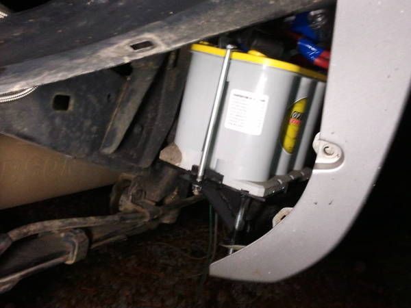

    Here's mine.
    Smaller non-spillable. 85 amp hour battery with a 150 amp isolator.
    Went with the smaller battery due to limited space (had a cold air intake taking up a lot of room). This second battery is for my rear winch and onboard air system. I found I was losing winch power all the way at the rear.
    I went somewhat over board with the strapping to ensure no sloshing around.

    [​IMG][​IMG]

    That was a 'rough in' - I needed to see if I could get them in there first. I am out the door right now to a METAL fab place locally to see if I can get them to make a plate for me.
    Scientific method
    First one
    1. Will A Type 31 fit in the stock battery location without modification?
    2. Measured, seems like it should
    3. if* I remove the pan, and cut out the factory hook on the fuse block side and replace with a wing nut battery tensioner hook.
    4. removed stock battery and it fits 'DRY'
    5. Results are conclusive
    **6. Yep, works!
    7. Fits like a glove.
    Second one!
    **1. Will 2 x Type 31's fit in the stock battery location?
    2. Measured, there could be enough space.
    3. if* I remove the fuse block and relocate it, cut the fuse block mounting stud, cut the hook tab for the battery tension system, move the Grounding point
    4. did above and they 'dry' fit
    **6. Yep it works
    7. It is a tight fit, real tight.
    Third Question
    **1. Can I make a battery tray to fit the 2 x Type 31's in the stock location.
    2. measured, looks like it, just needs to be "stepped" (two level platforms)
    3. If I make a battery tray, will they sit level and clear the hood still?
    It is a work in progress. I will say though, seems I am a pioneer in this size field for the Type 31's!
