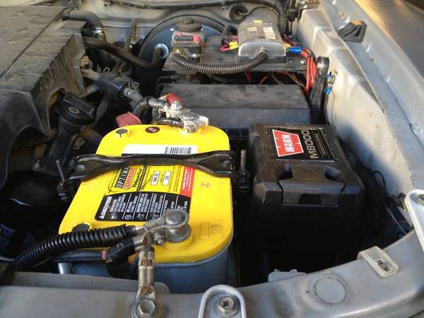

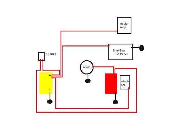

    Hey guys, I have a rough diagram of the set up I'm going for. Was wondering if I can get some feedback to see if I'm missing anything and if I messed anything up.
    I currently have a yellow top Optima in the stock location (rotated) and I'm going to replace it with a red top, then move the yellow top to the pasenger side. Audio amp, winch, and Blue Sea aux fuse panel all going to the yellow top. Upgraded 250A alternator from Bama hooked up to the red top. And the Blue Sea 7622 unit between the two batteries.
    My current set up
    Proposed wiring diagram
    I know there are more wires coming from the Blue Sea unit, but I didn't put them in the diagram. Do I need to add any circuit breakers or fuses anywhere in the diagram? Thanks

    Fuses/breakers recommended on the connecting wire between the batteries. After both + terminals. If that wire rubs through and shorts you will have both sides zapping shit.
    My next go around im going to use some breakers vs fuses. Easy to turn off for maintenance

    Thanks for the info. I see some people use 300A circuit breakers. Is it necessary to go that big? (I'll have the 250A alternator from BamaToy)

    I've always thought 80% of rated capacity. BTW, I would NOT put one on the starting battery.
    I would go with a breaker for the each leg of the battery isolator. The Winch, Amp, and Blue Sea Panel should probably have them as well. And I would ground the batteries to the same point.
    Like this:

    I'm confused. The diagram you posted has a circuit breaker (or fuse) at both batteries, but then you said not to put one on the starting battery.
    And is 80% the load pretty accurate? I'm assuming you have a 200A fuse in the diagram because that is 80% of the 250A alternator? Thanks!

    I mean don't put a breaker between the alternator and the starting battery.
    You don't want to load the breaker more than 80%.

    Ahh gotcha! Also, what does grounding to the same ground do (for the winch, amp, and aux fuse box)? They're currently grounded separately and have been fine in the last few years that I've had this set up.

    When you have multiple ground points, you may experience noise in audio systems due to ground loops. I don't worry about the winch so much as the batteries.

    i think that having 2 fuses between the 2 batteries is redundant.
    The biggest concern with fusing ones lines is MOSTLY incase of accident or an uncontrolled dead short.
    Most people mount their isolators/ solenoid so close to that first battery that there is no risk of that segment shorting out. If the secondary battery is located a good distance away , i.e on the other side of the truck or the truck bed in the rear then id agree.
    One thing id also consider looking at is the increased resistance all the additional fuses, solenoids, isolators and circuit breakers introduce. Generally this wouldn't be a big deal but if you winch allot and ur pulling 300-500 amps the resistance becomes a factor and you will see a greater voltage drop

    Fuses protect the batteries and the stuff connected to them and it would be foolish not to protect your vehicle from a dead short or battery failure. Regardless of how near or far the batteries are from their solenoid.
    A good design takes into account what you're trying to do and sizes cable, etc. accordingly so that resistance is not a problem.
