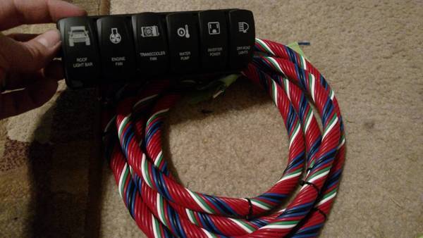

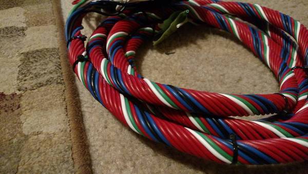

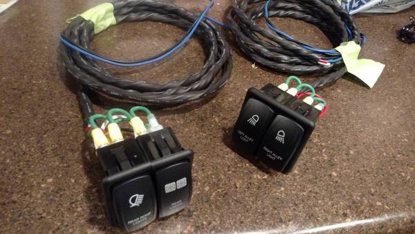

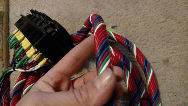

    So got in a few things today to help update my expo build and dual battery setup
    Some wiring pics..........
    Just waiting on my heatshrink to come in......

    damn that looks good... what did you wrap the wires around?

    Called concentric wiring. The core is 3 wires at 10 gauge wrapped in 1 direction and the 2nd layer is a total of 11 wires at 16 gauge that are wrapped in the opposite direction. It is the same technique that they use on race cars/trophy trucks/buggies. Pain in the ass..........

    LOL looks like it... but usually clean and correct usually is.

    True. You also need about an extra foot of wiring for every 4 or so feet of total length of the harness.

    Cost vs benefit in there. As the guy stated, sometimes you have to add additional wires to properly balance out the harness. I know to over half the client base I have currently, that extra wire in there would confuse the hell out of them. Not to mention the increase of diameter of the harness. The harness I make now barely fits through the stock nipple as it stands with just the minimal amount of wires in it.

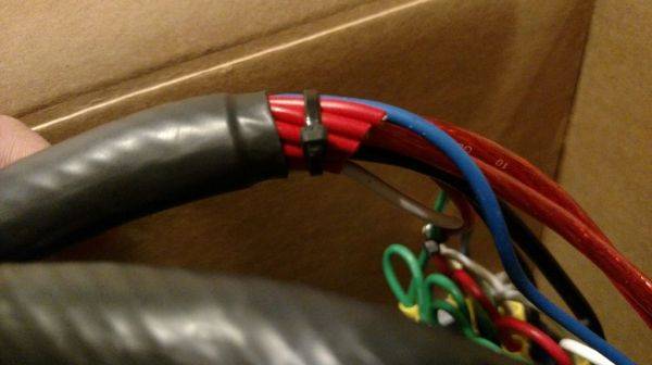

    Yeah I know what you mean. I just trimmed the filler wires at the end so they don't come out of either end of the heat shrunk part of the harness. I just got in the heat shrink today and I'll put up some pics. I have a total of 3 of the harnesses's completely done now. So only one more really large one to do.

    Oh yeah I forgot to mention........I also added another wire grommet to the firewall for all my other wiring that wouldn't fit in the stock one.
    Here you can see the extra filler wires....

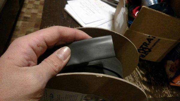

    And the Heat shrink tubing I got.....
