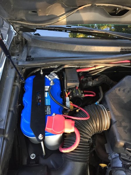

    Question, I'm going to be setting up dual batteries with the blue sea ml-acr. When it comes to electronics I'm retarded. It's capable of handling up to 500amps. I'll be locating the house battery on the passenger side fire wall and keeping my winch on the starter. My question is what gauge wire and amp fuses?

    Hey Mike use at least 2 AWG wire and I'd recommend getting circuit breakers so you don't have to replace fuses if/when it blows.
    If you're still in the area, I can show you my set up, or you can see it in this thread or my build

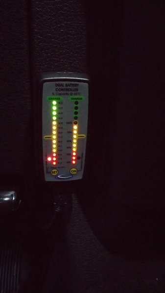

    To anyone with a national luna controller... does the cab meter stay illuminated all the time?

    Yes - how else would you know the status of your battery? You can turn the lights off, however.

    It was just a question... Not really interested in seeing how much batt power it has while it sits in the driveway for weeks on end... killing them

    confirmed on our FJ, the lights stay on the national luna controller with the truck is off.
    if the truck is off for long, you can always unplug the controller.

    I wasn't being sarcastic, but I think their draw is pretty negligible. The SET button, I think, is used to turn them on/off and turn the alarm on/off.

    Confirmed. Set button turns off the display. Says it keeps the alarms active while its "off"
    Thanks guys
