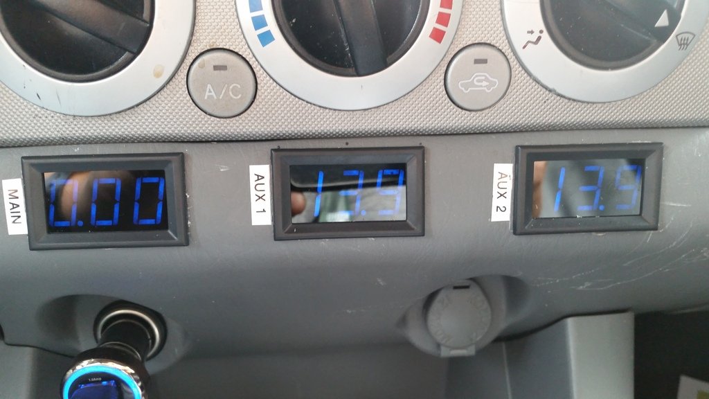

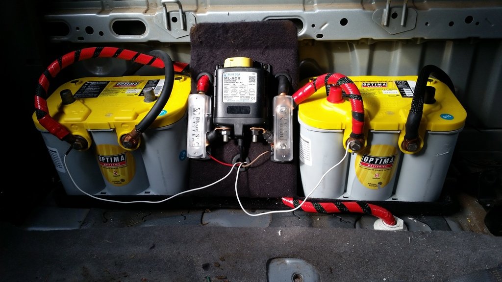

    Getting closer to finishing my Dual/Triple battery set up. I am mostly just waiting for the RFRM fuse panel now. I still need to clean up the wires. Does anyone know why my ML-ACR switch LED wouldn't be working though?

    Would this help you? From the looks of your picture, your ML-ACR looks like its connected to one positive wire and one negative, which is not what the wiring diagram shows. Your voltmeter should only be connected to the intended battery. I can't tell where you have your connections for that, but hope this helps anyway.

    Hopefully this helps explain whats going on here:
    Thank you. It will look much better once I have everything back together but that wont be until I get my RFRM.
    I will have nylon strap going through a D-ring with velcro holding these down. I left just enough room below and behind to run that.

    I'm assuming because I can't see it, that your voltmeter #1 is hooked up to your start battery. If it's not showing a reading, maybe check ground?

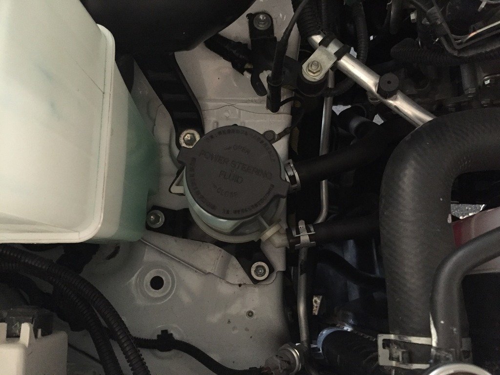

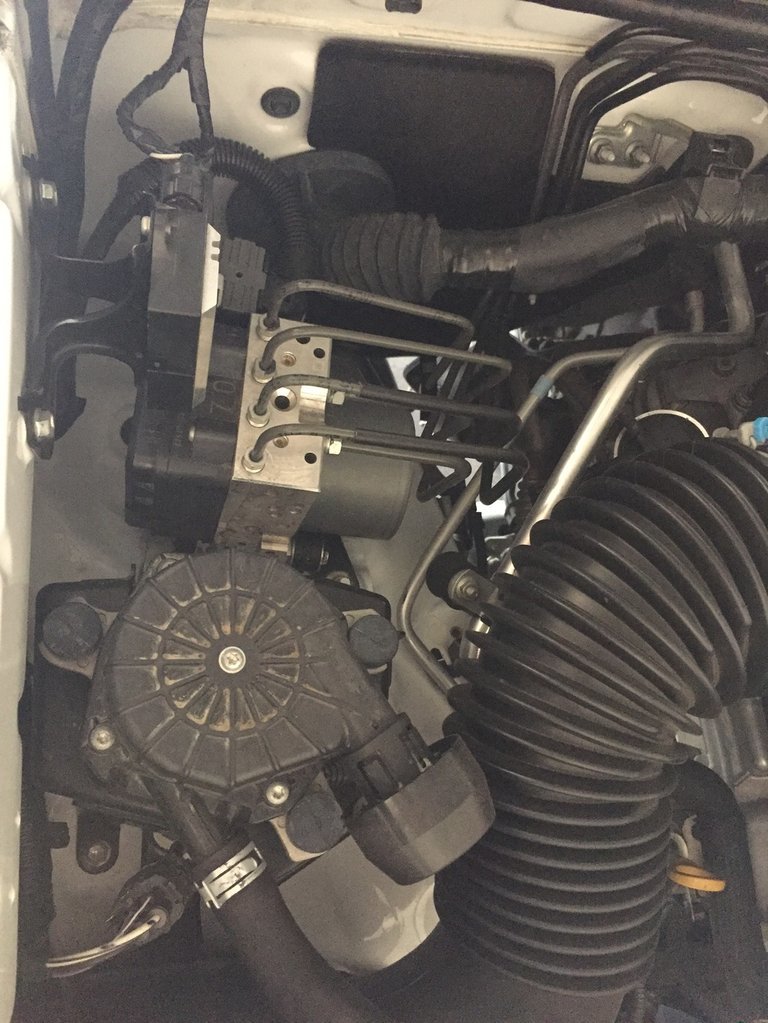

    Thanks guys! I was looking at my engine bay and looking where to put the aux battery. I can't figure out where the sweet spot. Any recommendation where to put it? I don't want to relocate to much just to make space.
