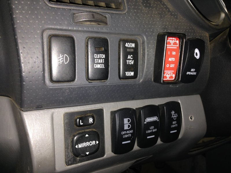

    I ended up putting the switch next to the switch blanks on the driver side (added another one there too). When you have too many switches, you gotta get creative lol
    As for the lights on the switch, both go on when both batteries are being charged. This usually happens automatically a couple of minutes after you start the engine, or if you manually connect the batteries (by the rocker switch or the actual unit using the yellow lever/button). The lights on the switch turn off when the batteries are isolated (car off or manually disconnecting). Hope that answers your question
