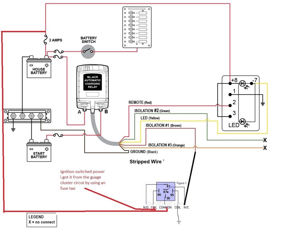

    Even with the Blue Sea aux panel, I still have crowded battery poles :(
    [​IMG] [​IMG]

    What program did you use to make this wiring diagram? Just recently started on one myself, and I started in Visio, but I'm finding it a little tedious.
    Whitecloud likes this.

    Just go to
    Www.schematics.com man it's free and stores all your stuff online so you can jump around to different computers.
    Its perfect for basic stuff and snaps lines in to your terminals instead of drawing them.
    It leaves some to be desired on technical stuff but it's easy to make work for vehicle diagrams like we use here.
    My name on that site is Tigglebitties if you want to stalk my schematics. Got a couple more in the works
    Blackout14 and docloco like this.

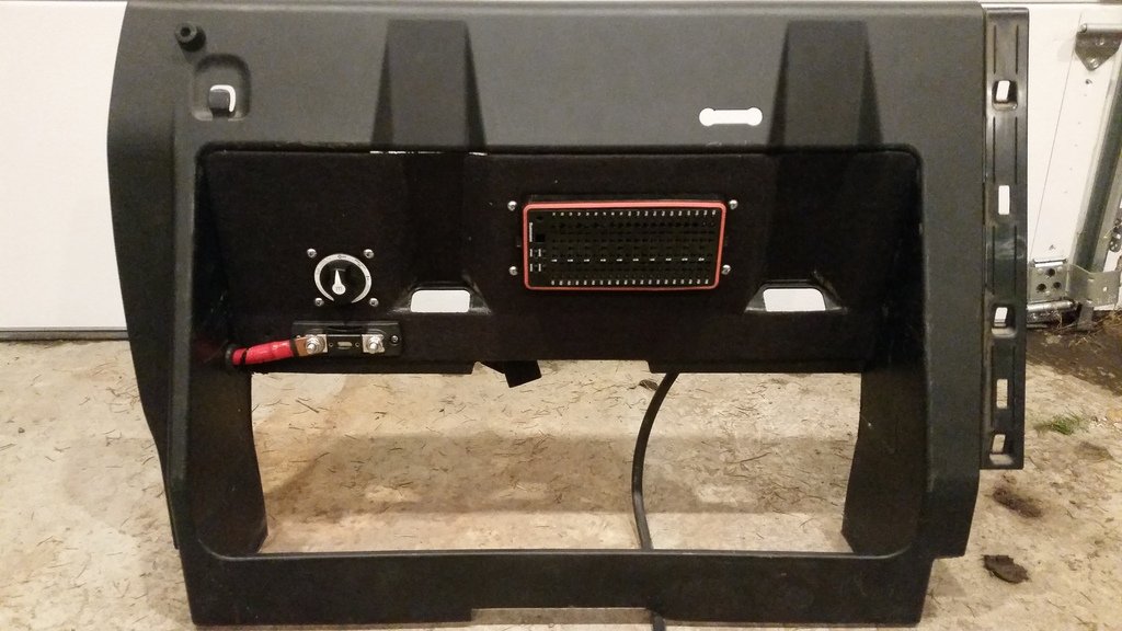

    I finally got around to getting a bunch of the wiring cleaned up. I tested the PAC-200 and it worked just as I wanted it to. I tore out all of the crap wiring I had done in the past and started running better quality wire in a more organized manner.
    The bottom half of the Bussmann is constant power while the top half is triggered by the ignition (through the PAC-200). All of it can be manually shut off with the bluesea switch. Batteries and ML-ACR sit below all of this.
