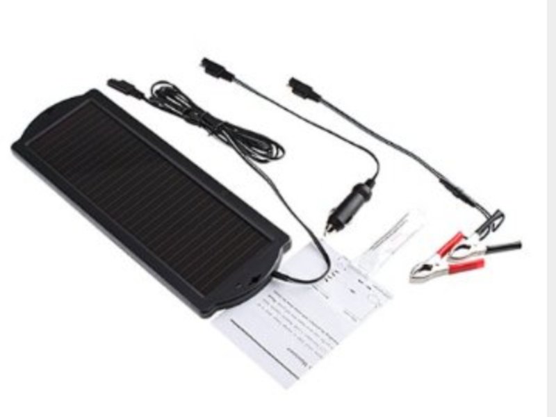

    As of now I'm just using a cheap solar panel on my dash to help battery I'm sure it doesn't do much but can't hurt.image.jpg
    I plan on doing something like this on the roof of topper.......someday

    I've thought about something like that, might just have to do it. I don't even get over 35 mph going to work and might get up to 55 once a week.

    I did a 50w panel made by Renogy Solar that feeds into a charge controller to my aux battery. It gets up to 13.2-13.5V, but honestly I don't think it does much in the way of charging my battery. Granted, the way my system was setup technically the panel was charging about 150Ah (both batteries). I read on some RV and off-the-grid sites that you really need 1 watt per amp hour for solar charging on a perfect sunlit, clear day so 100w might be able to handle one 31M in a perfect world. Nate's 100w panel might be enough for one 31M battery, but he has no way of directing the panel toward the sun and if it gets dirty it loses efficiency quickly.

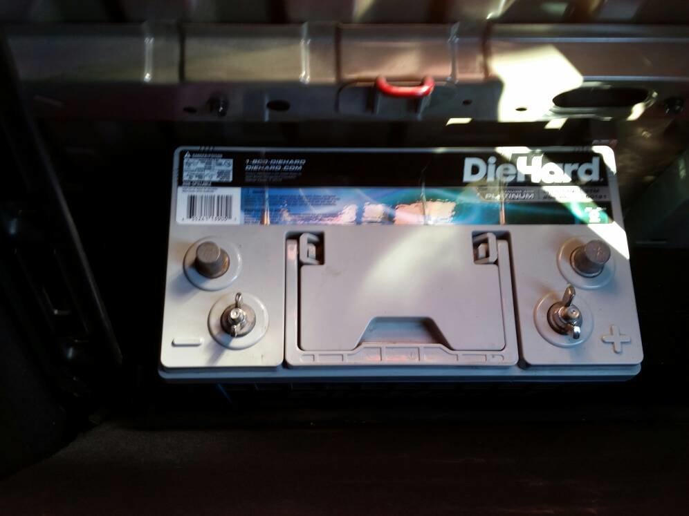

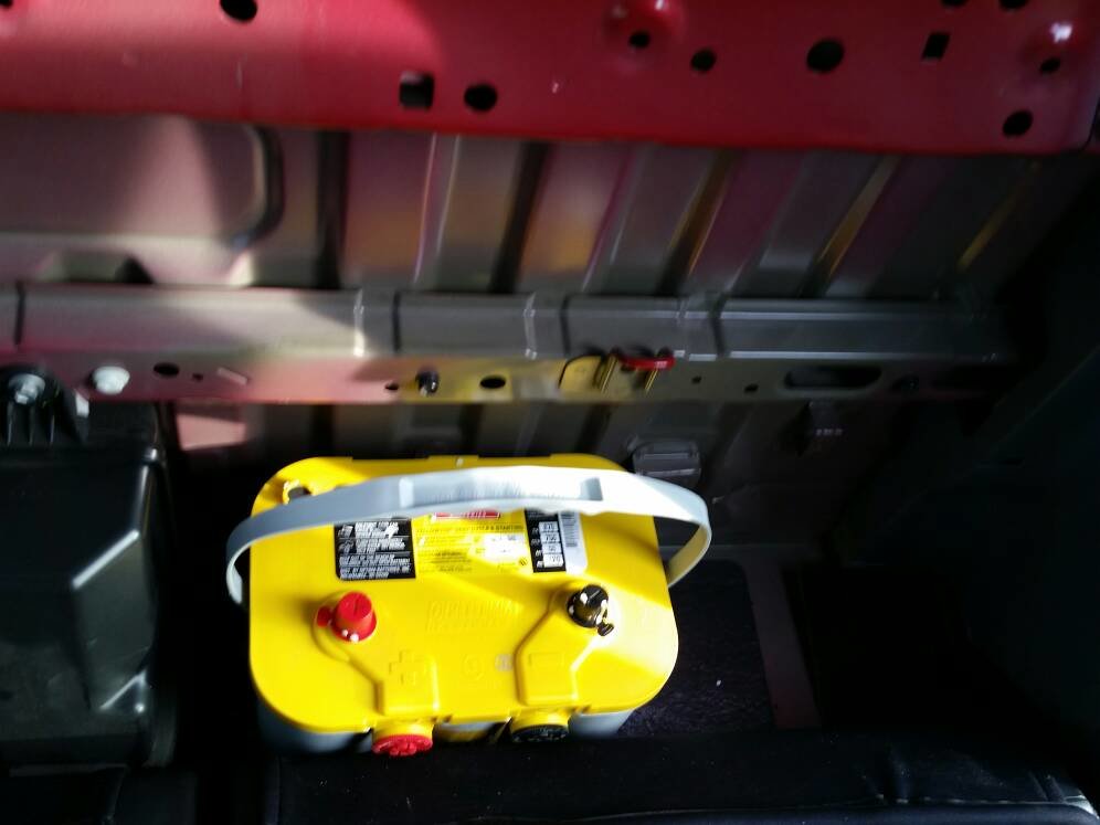

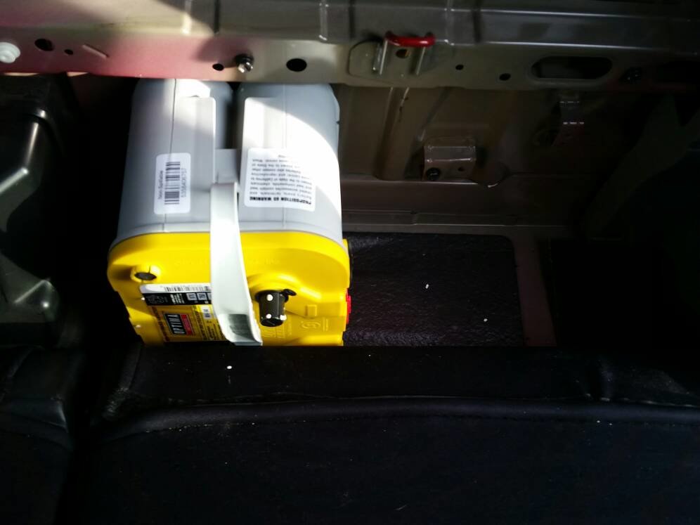

    Think about all the OEM cars with factory alarms that have the blinking LED. not worried about it ;)
    here's some test fit pics for anyone curious what will fit behind the driver rear seat. d2831608f13f8c478d5cb097aefb6e17_5ce35c34e4ea42b5d98205c067b99a5450cd3501.jpg
    ^ Optima 34/78
    ^DIEHARD 31M
    Since I have the factory JBL system I'm going to be running dual optima 34/78 in the bed. Ditching the subwoofer and amp to stick the batteries behind the seat is just too much. With it all disconnected I had zero radio....so it's staying till I go full retard with the truck. (Cage etc)

    Be careful with the side mounted batteries. I know the Optimas aren't supposed to leak.... Mine does. I'm about 2 months out of warranty and I've heard of them telling people to kick rocks so I'm not even going to try. Sticking with NorthStar and the 4 year full warranty as soon as my optima craps
