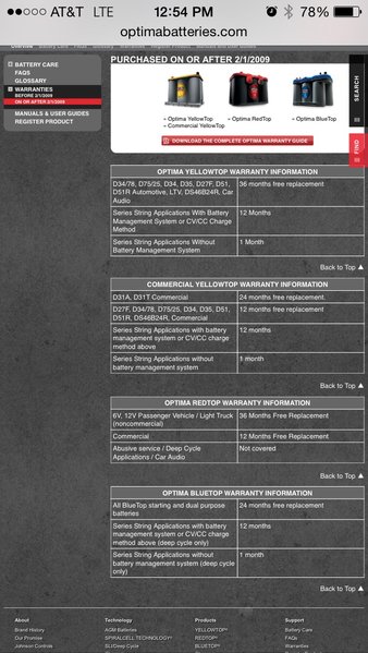

    I haven't been in here in a while but I thought I would toss out some knowledge that I have.
    ^this longer warranty is exactly why I did yellow top.
    Blue tops are basically the same thing but they are, again, basically the marine version of the yellow top. It is designed for use in boats so, if I remember correctly, it uses a different material for the contact points. I believe the shorter warranty is because of the harsh conditions that boats see on a constant basis.
    My auto shop suggested taping receipt to the battery so I used clear packing tape to seal the receipt and to attach it to the back side of the battery.
    My info could be wrong but I was told that you could have issues having a deep cycle and starter on the same system. The deep is designed to be discharged and recharged multiple times while the starter should only handle heavy quick discharges.
    A visual aid for those that need it lol

    All good info here. I'll just add that since yellow tops can do start and deep cycle duties it seems like you can't go wrong with those for our purposes if you want to go optima. You get both in one and the extra 12 months of warranty. Group 31s only have the 24 months warranty tho.

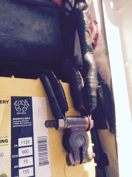

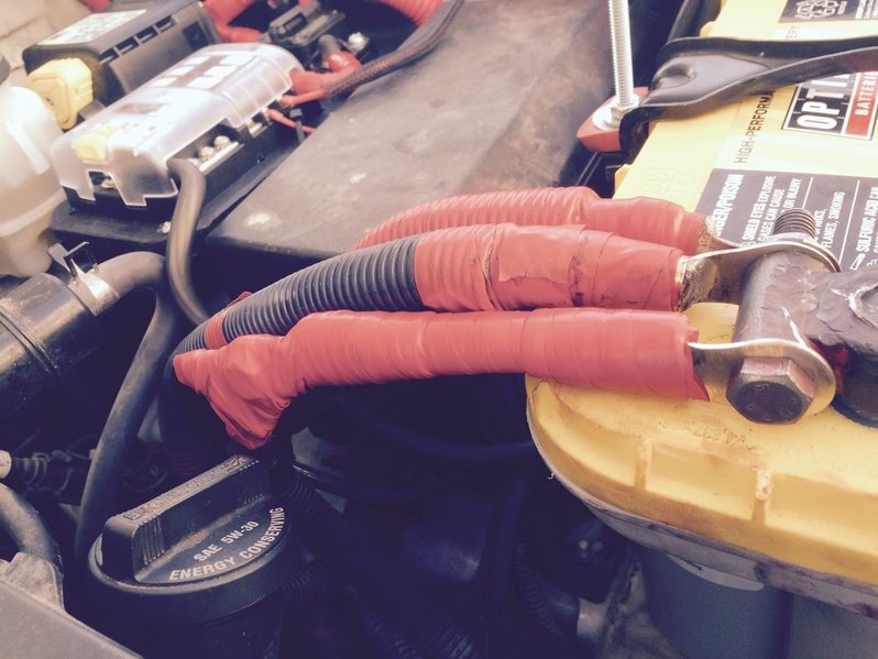

    Aaron, Remind me what you're planning... Is it 2 batteries in the bed? Or one in stock location and one in bed?
    My setup is the latter, and I went the easy route and made about a 4 or 6 inch 1/0 extender with a ring terminal on each side. One side connects to the battery and the other side I used a 1/2" or 3/4" long copper nut and bolt to connect to the starter and stock fuse panel rings. I cut off the weird end of the connector on the starter to battery drop leaving the hole intact, straightened it, and drilled out the hole to accommodate my battery connectors.My extender bought me enough distance where nothing is stretched. Everything else I replaced in the big 3/4 I left the existing grounds and added a few more.
    I haven't replaced the terminals on any cables but I'll tell you what I think they are. I believe the starter cable is 2 gauge, the factory run from battery to the fuse panel is 8 gauge. I removed the stock alternator to battery cable altogether so I don't remember about that one.... But my guess is 4 gauge. On the negative side there is a small 8 gauge from battery to body and a 4 gauge to engine block (I don't remember exactly where that last one ends up).
    Hope that helps.
    Edit: now that I look at it. Starter cable looks to be 2 gauge

    Positive connectors. Extender, bat to alt, bat to ML-ACR
    These are the grounds. The two on the right are my 1/0 replacements. On the left is the stock ground and my additional 4 gauge to my aux fuse panel. Both look to be 4 gauge.
    This is the end of my extender. The starter looks to be 2 gauge (bigger than the 4 gauge ground in above pic). And the one running to stock fuse panel looks to be 8 gauge (smaller than the 4 gauge ground)
