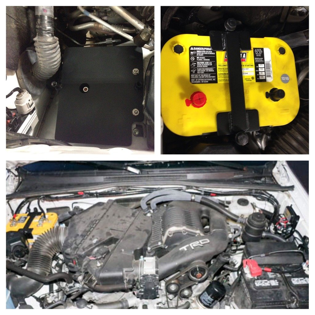

    Here's my new set-up using the National Luna components. A friend and I fabricated the second battery mount.
