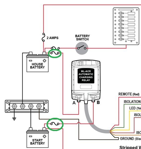

    I use a similar chart when wiring, but I'm trying to figure out what size fuses to use for the positive connections from the batteries to the solenoid/relay.

    So you have no fuses between your batteries and your bank isolator switch?
    They way the diagram I'm looking at shows, it wants you to put a fuse between the positive post on the battery and the isolator switch for each battery.
    The fuse locations circled in green are the ones I'm trying to figure out what size I need for.

    No fuses between the battery and manual isolator switch. All the power to the truck is fuse protected except for my winch because there is not much available that can handle 500 amps. I have it on a HD ON/OFF Switch to kill power in a runaway winch situation.

    Ah, gotcha. So you're not worried about the manual isolator switch melting? All the research I find is conflicting where same say you have to have fuses and others say it doesn't matter for the exact reason you said.
    Not sure if you saw my edit, but these are the locations I'm talking about.

    Yeah not worried about it frying, it's rated for much higher amps than the wire is.
    You could look into a marine style fusible link option right off the battery, if the blue sea can handle 500 continuous amps you can fuse it at or less of course.

    Hmm, what is yours rated for?
    Guess I'll just go ahead and do a 250 amp fuse for each battery. Only ~$15 a piece so it can't hurt.
