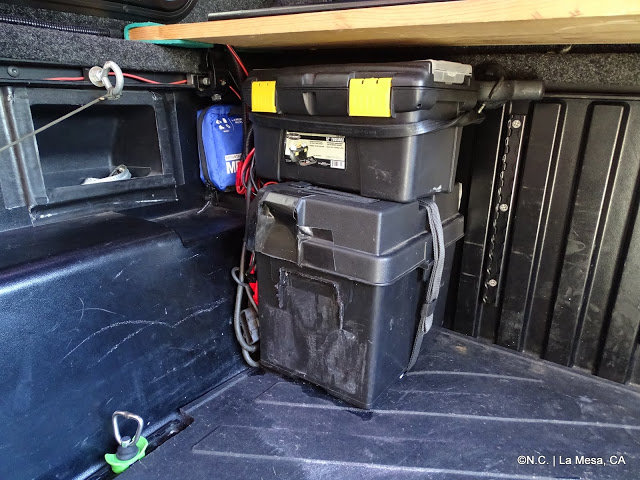

    Added #6 about the two little tabs to press down. Will take close up pics on Sat or Sun.

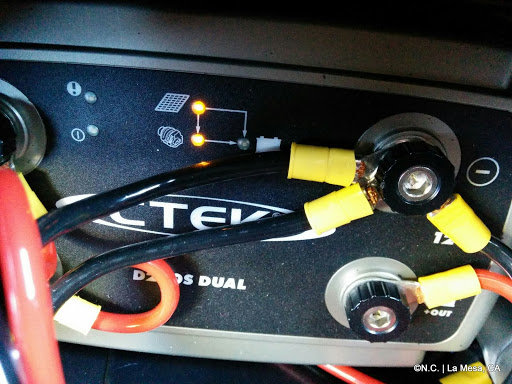

    Neat system. For really off the grid efforts? Your system got me looking at the CTEK battery charges/reconditioners. I am considering buying the 3300 model.

    Can you take a better picture of your ctek device?

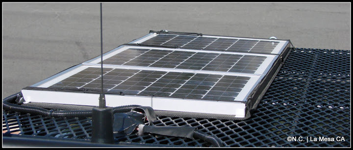

    Dual yellow tops with ATO holder, promarine controller and solenoid, 200 amp alt same as most setups. Found some flexable solar panels for the roof I ever get a fridge.
    Just added a Redarc gauge to the pillar.

    That is the milage I get too. Got any pics and a link to the panel's that you have??
