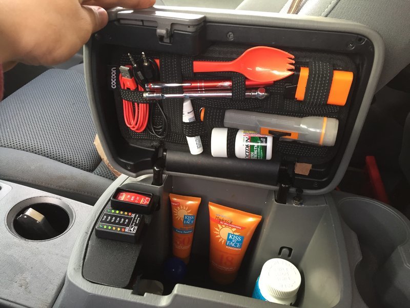

    This is my setup, I have enough lights starring me in the face while driving, so i put mine in the center console. its easily monitored when i just leave the lid open. also the dual volt meter is grounded to a pin switch so it only turns on when I open the center console :thumbsup:

    Damn, I need a emergency spork too.

    Looks great! I'll be doing something similar.
