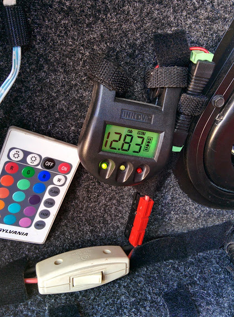

    It's a volt meter. It will read whatever voltage it is exposed to. I have one in my dash. Upon truck startup my alternator puts out 14.2 for about 1-2 minutes, then 13.8-5x volts thereafter. My aux battery is setup very different as I'm using a DC-DC converter to isolate and charge.
    I have the same voltmeter in the truck shell where my aux battery is. voltmeter lives on the wall and at a glance I can see battery health. Super simple and works great. I once metered the draw of the voltmeter using an ammeter and it was in the milliamps, nothing to worry about, so meter runs 24/7/365

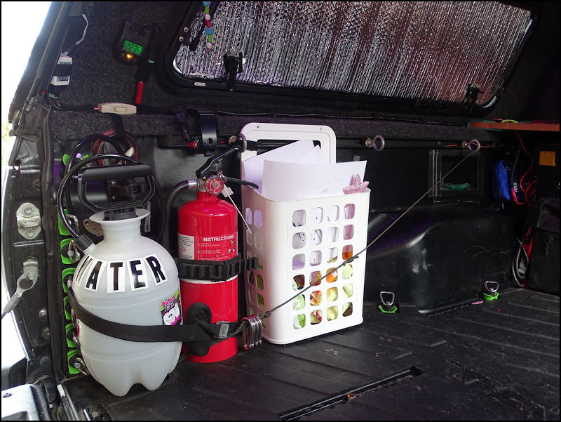

    One is the dash is plugged into standard +12 socket. I took the second one in the back of the truck and disassembled it to get rid of the bulky socket connector, and I just wired it to a smaller barrel connector. It's held onto the wall of my shell with some velcro. I like this arrangement, because it's out of the way and easy to see.
  11. Mar 29, 2016 at 3:51 PM
    #1031
    Crom
    Crom Super-Deluxe Member
    Jun 22, 2009
    #18782
    9,654
    Nick
    San Diego, CA
    2009 4x4 DCSB Camp Supreme
    Millions
    Here is a picture.
    Please excuse the velcro mess. I've since cleaned it up. :)
