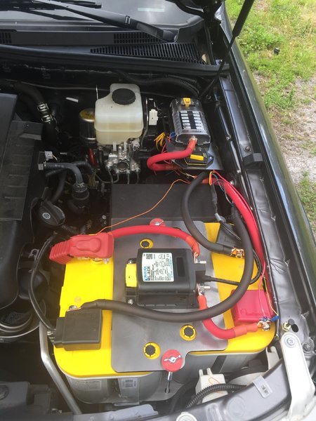

    Here's my setup. My starting battery has been relocated to the passenger side tray. My aux. battery is in the factory location with the Blue Sea fuse box nearby to power aux. loads. My winch is hooked up to my main battery as recommended by most winch manufacturers.
    I am aware that my Redline hood struts are not mounted per the instructions. I did this for a little more clearance from the battery. However, they will fit just fine without doing this.

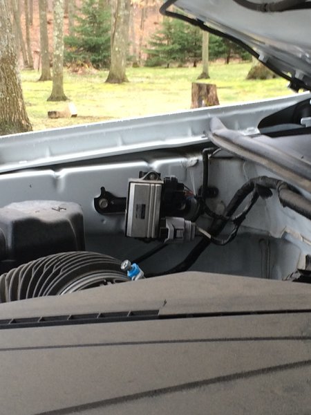

    Not sure what this is called in my picture the silver electrical box I'm not seeing it relocated in any pictures

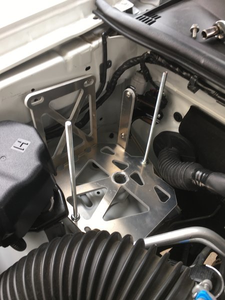

    I honestly didn't come in here to sell a product... but here it is...
    I manufacture this battery tray. As you can see, the "fuel resistor" you are referring to simply relocates to the integrated tab on the back of the battery tray.

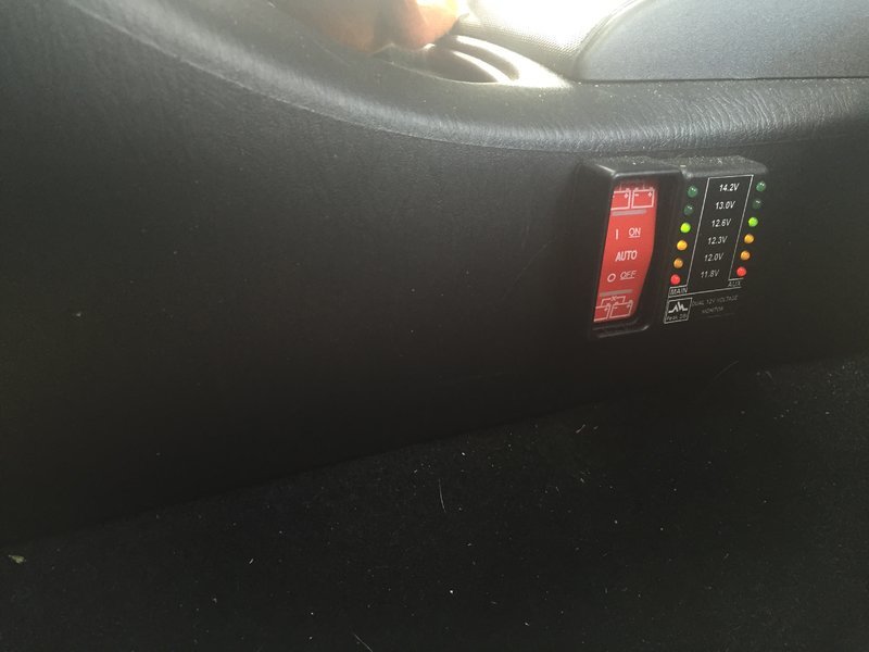

    Some pics of my auxiliary battery install (She's a desert runner). Deka Intimidator AGM as aux batt; conventional Interstate as primary. Painted where custom air ducting is going to be routed. (Need to ground aux battery to body and engine - currently connecting only to primary batt neg termainal.)
    Both Cole Hersee relays (200 amp #24213 as isolator; 85 amp #24059 for aux batt accessories) are controlled by single DPDT switch. Each battery is hardwired to a Starter switch on fender wall. I can direct either battery to the starter; combine them both; or disconnect them both. Used 1/0 wire to bring alt juice to a distribution block since I couldn't connect two battery lugs to alt bolt; it's just to short to do so.
    Battery switch, Blue Sea #6007. In off position, the knob slides out, providing an extra theft measure. Used 2/0 wiring - I swear engine turns over easier with either battery than with the 2AWG OEM cable.
    DPDT switch on center console. Sierra International TG19520. Currently wired for manual operation; in future I plan to wire the isolator to ignition-on power, but will keep it wired to the switch to have option to turn off isolator manually.
    It got dark on me. These are cig lighter Drok voltmeters. Cheap and come in three colors. Accuracy appears to be .05 volts off, but they don't have to be super accurate. Left voltmeter is on aftermarket power strip connected to aux batt; right meter is OEM cig lighter port.
    This has been one of my longest car projects to date. Probably took longer than swapping out an engine on my sister's 03 Matrix! My bro and I did that over two half days. This project took some 4 weeks over 2-3 hour week nights and some Saturdays and Sundays. The cable cutting-to-length; the crimping; the re-wiring the of alt and starter cables; the DPDT switch installation; the starter on/off switch; the 2nd battery tray install; the add-a-fuse holder for the aux battery; and got side-tracked doing a how-to for taking apart the fuse box to replace the alt fuse. And I still have some loose ends. But for the most part it's done and it's quite a rewarding feeling. Reading through this entire thread probably helped the most as did some youtube videos and websites.
    If anyone lives in the area and needs a crimper or some lugs, or some pointers, you're welcome to stop by my garage.
