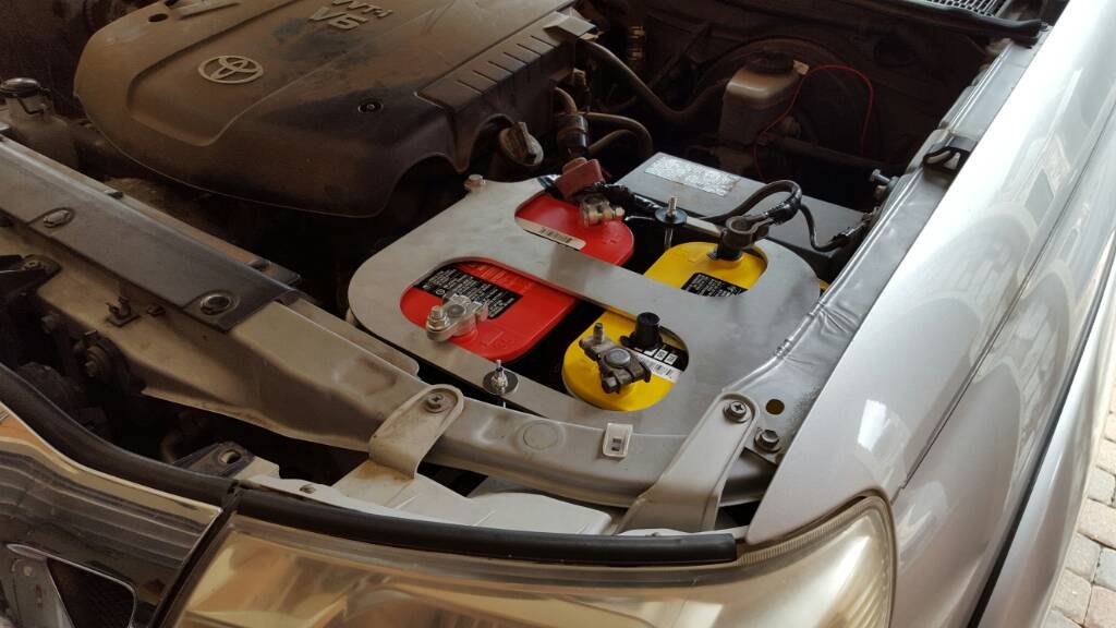

    i have a dual drivers tray with one yellow top and one red top. the acr usually wont separate them till i come out in the morning and stick the key in to let the electronics warm up for a minute before cranking it over.
    @HeliMedic i summon you! :bowdown: please explain to us exactly what is going on with the ML-ACR.

    @adanfon nailed it in the post below this one. The ML-ACR will disconnect the batteries when it detects a voltage lower than 12.75 for more than 30 seconds. In a perfect world, with fresh batteries, and no draw on either battery, your ACR should stay connected for quite some time... 12 - 16 hours... depending on temperature and other factors. With old batteries or any sort of draw whatsoever, you'll see the ACR kick off fairly quickly.
    On the flip side, the ACR will connect as soon as it detects a charging source above 13 volts (your alternator)... with one caveat. The ACR allows the starting battery to recover from the cranking process for approximately 30 seconds and then it engages, allowing both batteries to benefit from the charging source.
    So, it is completely normal for your ACR to stay connected all night if you're not drawing on the batteries at all. If it isn't, you may have less than healthy batteries.
