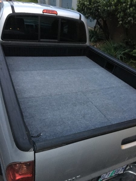

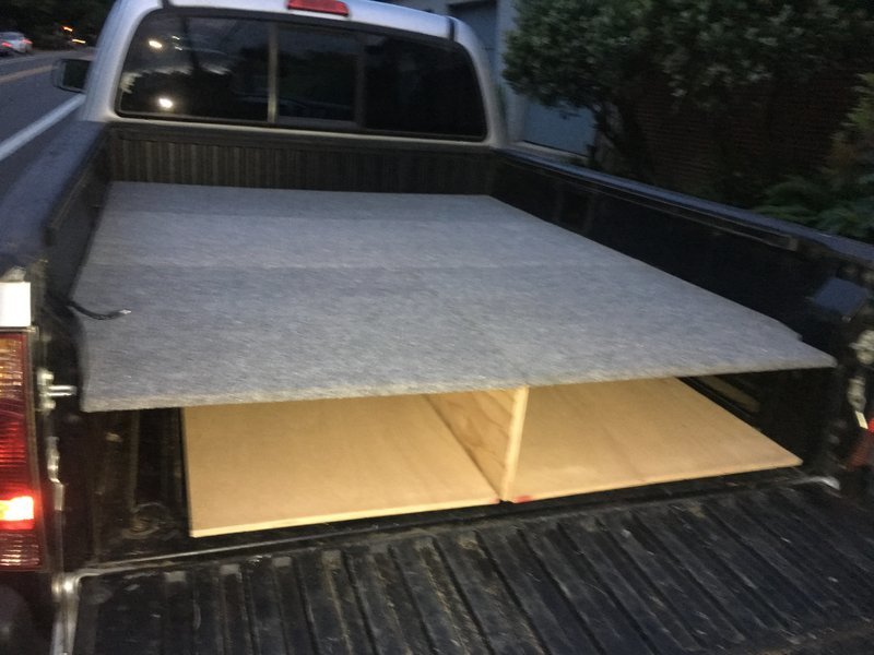

    I'm a rock climber. Bought my 07 AC 4x4 V6 back in January. Just did a fairly simple build-out so I can live out of it for climbing road trips - leaving in 4hrs for a couple months on the road.
    I'll post a couple more pix soon, but this is what I have on my phone right now.
    First, what you guys care about... the dual battery. Cheap-but-works route. I don't need a ton of capacity. Just charge phones, laptops, batteries, toothbrush, blender (cause road-side margaritas... well, you know).

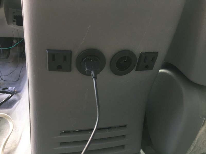

    So - Xantrex ProWatt SW600 Sine-wave power inverter (~$150) goes under the drivers seat. Be a little careful with clearance of the seat wires but it fits fine. The 1000W would fit too, and power a better blender :) Kinda wish I did that when my Nutribullet wouldnt fire (its 600W but the Xantrax is really 540W), so I bought a Ninja blender.
    Ground the inverter with an M8 bolt under the drivers kick panel using 2 (body and neg term) 29" 4GA cables from Napa. Run power to the front with 4GA (really 6GA) pyramid cable from jet.com for $15/25' after coupons - any good power cord works.
    Now heres the part you will like. The second battery is a group 24 deep cycle (I used from Adv Auto Parts with coupon codes for $60 instead of all the more expensive options. Its good enough for me but any group 24 fits). Remove the air intake hose, replace with a $20 Spectre Performance Air Filter. $15 metal battery tray from Baxter Auto Parts fits the spot with a tiny bit of dremel work. The two bolts from the ABS, and one bolt from the old air duct keep it secure - its a tight fit for a hold down, so either a strap, or a small bar I got a O'Reileys Auto Parts and some 8" J-hooks worked for me.
    I mounted a PAC-200 next to this, and got some 'xscorpion' fuse holder w/18' 4gu wire on one side for $10 each - 3 of these (bat -> car ; start bat -> PAC ; bat -> PAC). Then just a few custom-length power runs using the pyramid cable (car audio store crimped them nicely for me for free).
    From the Xantrax, I ran 'indoor' and 'outdoor' 110V AC and 12V DC. I put two 110V and 2 12V plugs into the back of the center console.
    In the little 'pocket' in the back I put 110V (house plug with a marine cover plate) on each side (pix later). And I put in dual 12V marine plugs on each side. This was a bit of a pain with clearances. Doing it again I might just drill the 12V into the side of the truck (I actually did do this with a Blue Sea dual 2.4A USB plug I bought - which is $35 on Amazon - a lot more than the $4 marine 12V sockets I put in the pockets). If you really want to do this ask me cause there are some gottchas.
    The back has a canopy (which I hope to find a high-top version on CL one day use as a replacement).
    Under a sleeping platform I build a 'drawer' for one side and a 'slider" for the other. Slider is for longer items and drawers give some organization.
    5/8" plywood covered with Home Depot carpet make the sleeping platform. There are little 'pockets' on either side to get access to the small space behind the wheel wells. The plywood is split into 3*2' sections for convertability. The back section is screwed into a pieces of 3/4" plywood center support. Front (tailgate) part is cut in half so its easily removable/convertable to
    1) carry tall items
    2) remove so I can sleep lower (under platform) if I a solo and want less storage but more headroom
    3) without drawer/slider I can sit and have a little table or be able to sit up.
    Nothing super fancy or expensive but works for me... I hope.
    Drawer/slider bottoms are 1/2" Shop Birch. Sides for drawers are 3/4" Shop Birch Plywood ripped to 8" high. Slider is same ripped to 2.5" high.
    Now to hit the road!
    Jeremy

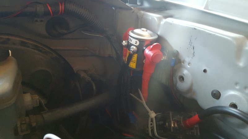

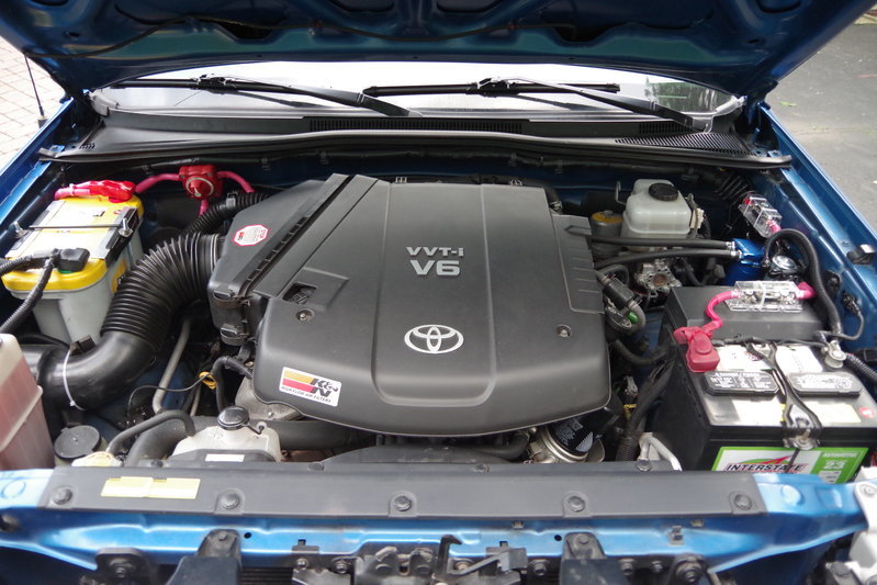

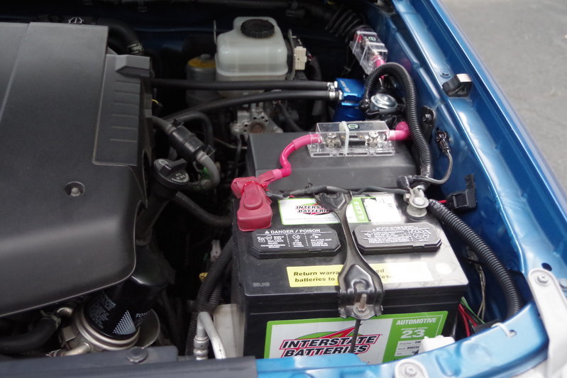

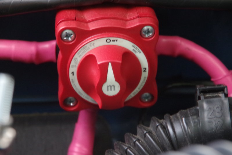

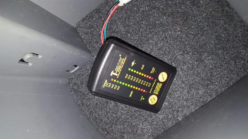

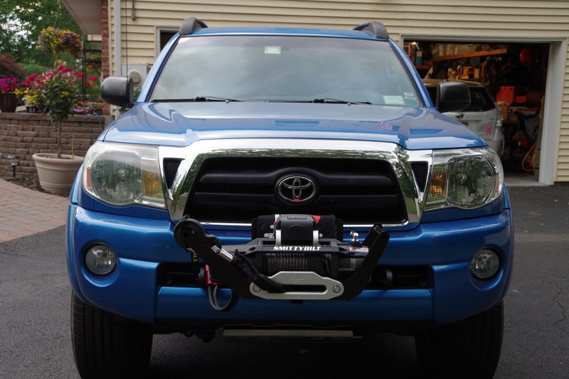

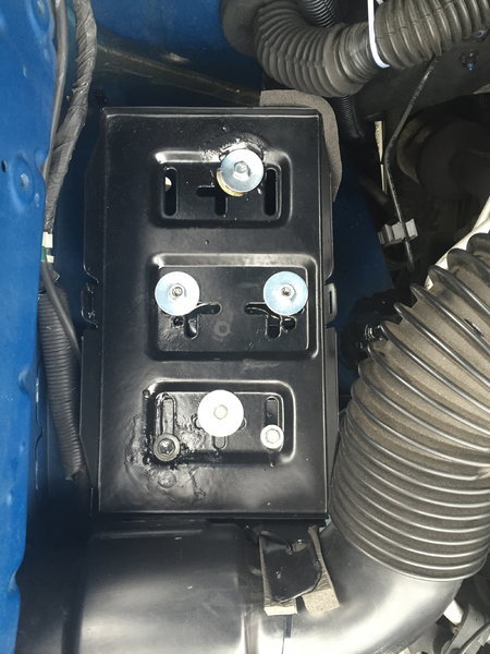

    Simple dual battery setup using a solenoid to separate the Starter Battery from the Auxiliary Battery. Starter Battery is a 24F regular flooded battery by Interstate bought at Costco. Auxiliary Battery is Optima Yellow Top D27F.
    Solenoid is attached to driver's side engine bay and can be switched on/off from an in-cab mounted dash switch. Circuit protection for both batteries are 200 AMP ANL fuses.
    27F Battery Tray is by WirthCo, from Amazon, mounted on passenger side, using available mounting points on the fender.

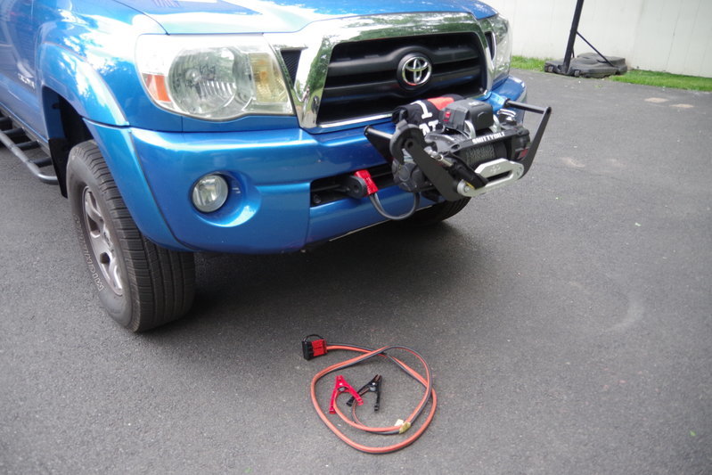

    Auxiliary battery provides power to a Smittyybuilt X20 Comp 12k Winch mounted to a Warn 26370 Multi-Mount Portable Winch Carrier. For safety, I connected a switch between the outbound Auxiliary power to the external winch power connectors.
    Blues Seas #6007 4-position switch. I can switch power to (1) Front connector or (2) Rear connector or (1+2) Both connectors (at the 6 o'clock position, hidden by switch knob) or turn everything off.
    Here's the portable winch mounted to the @Mobtown Offroad front receiver. It connects to the Auxiliary Battery via a Warn Quick Connect power connector. This same portable winch can be attached to the rear tow receiver and connected by a long ass Warn 32966 Quick Connect 24' Cable that I snaked along the frame rails to the engine bay.
    Here's another view of the Winch electrically connected to the Aux battery. Also on the ground is a Jumper Cable that I added an off-brand "Anderson" Connector (same as the Warn Connector, except for a plastic tab that I had to Dremel off, and 1/3 the price, from Amazon) Now I can jump start another vehicle without opening the hood.
    I hate everything remotely related to electrical work. So, surprisingly, everything's tested and everything works.
    Thanks everyone for your input and suggestions.
    @Crom @docloco @qnyla @bjmoose @CVYota @Chuy @MJonaGS32 @Iggy. @HeliMedic @HolyHandGrenade
    I used a little bit of everyone's ideas to come up with my setup. I think I spent more time researching and asking questions than the time it took to install.

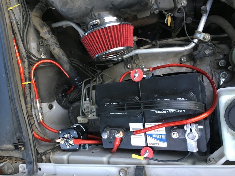

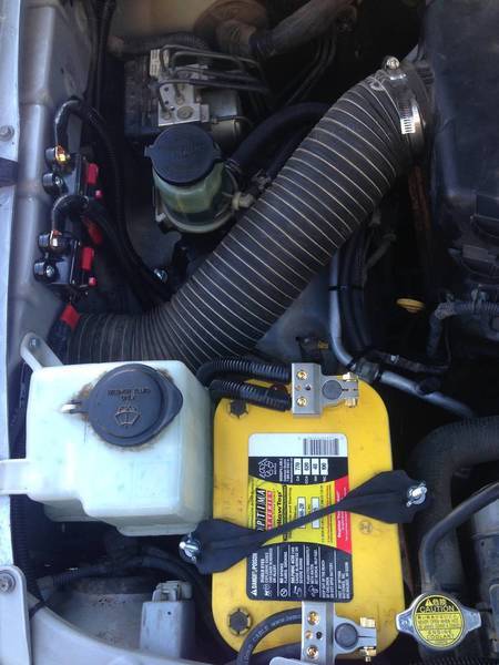

    Here is my setup. Finished it a few weeks ago and works like a charm so far!

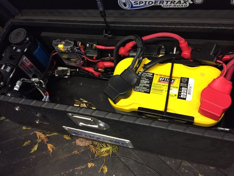

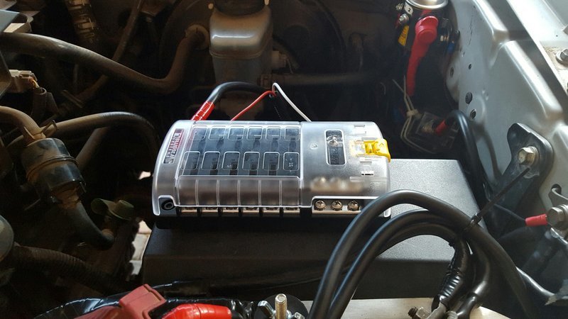

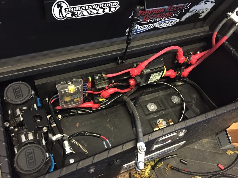

    Finished up my dual battery setup. Worked with @Iggy. to get this done. His help and wiring skills were essential to making it happen. image.jpgimage.jpg
  16. Jun 20, 2016 at 10:01 AM

    Its a Betterbuilt toolbox. I forget the size. I can measure later. It fits nicely between the wheelwells with enough room to put my dirtbike wheel on either side for hauling it. Worked out perfect for the battery setup.

    Check out the build
    It turned out great! That location was perfect considering the alternatives.
