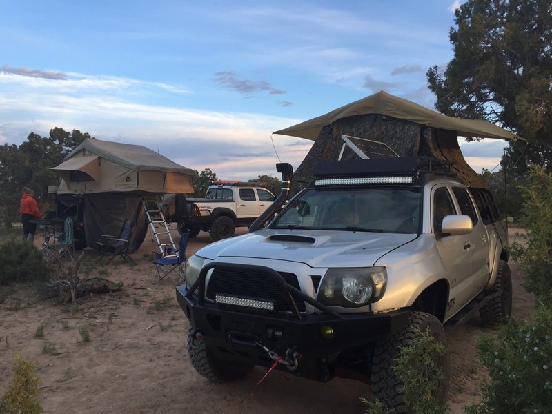

    Nice. Yea I'll add it when I get to a PC later in the week. Work trip in Ohio for the week
    This is what I have on my truck. Made an adjustable mount for it too.

    I like it. Having the tilt will def help maximize direct sun exposure. I don't have a rack to mount to, so I spent a lil more for the flex panel.

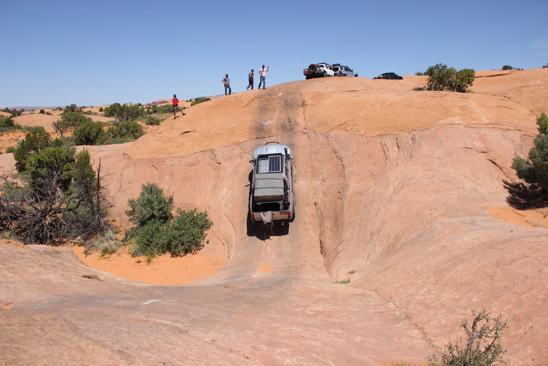

    Yup. Looks like a LOT OF TILT

    Lol. What a beast!!
