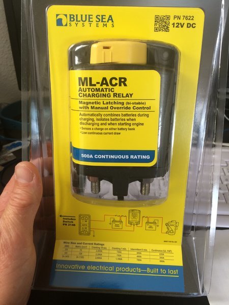

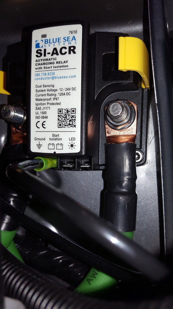

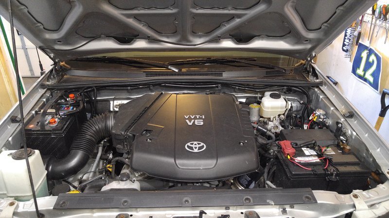

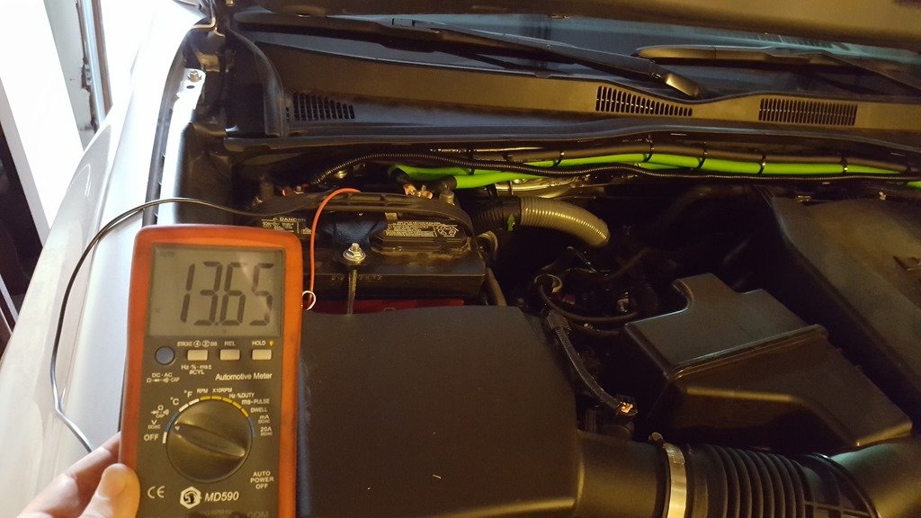

    I've read through most of this thread, awesome, most comprehensive dual battery info I've found. Here's where I'm at.
    image.jpg Thanks to info on this board I follow the consensus the Blue Sea ML ACR is the way I want to go, picked one up for $155, which isn't bad considering the prices on them are steadily going up north of $200.
    I've had an Odyssey PC1200 installed for more than 10 years and it's been awesome, but last 2 trips out I've drained it with my fridge while sitting for 24 hours plus, thus the reason I know I need an improved setup. I'd like to do a 100 watt solar panel and a Morningstar controller, but that's for another time.
    I'm running a Cadillac eldorado alternator putting out 120 amps at idle, and my wiring had been cleaned up and accessories are on a Blue Sea fuse block, so basically I'm down to adding the second battery and wiring it all up with 1/0 awg welding cable.
    With all this comes a pretty basic question-
    Is there a good reason not to run a 10 year old battery with a brand new battery, am I smarter just biting the bullet and installing 2 brand new at the same time?
    I don't know if I should pull the old one from the main battery and make it the accessory battery, or just run it as the main until it pukes then drop the second in its place and put a new one in the accessory battery spot, or if it will kill the new one faster no matter where I put it with the old one on its way out.

    Interesting question. As I had not really thought much about it, I did a lot of googling. There doesn't seem to be an issue with mixing old/new batteries. There is an issue if you are running a LiPo battery as it requires a special charger, but for regular starter/deep cycle batteries there really isn't a lot info on running new and old at the same time. My guess would be as long as the old one is still holding a charge their shouldn't a problem. I would imagine if it was an issue there would be more info about it around the interwebs.

    I was exactly where you are, about 6 months ago. I worried over this same question. Like you, I chose to use an ml-acr and 1/0. I decided to go with two brand new matching batteries. In a way, the decision was made easier when GB came along for Northstar AGMs because good batteries are not cheap. I also liked the idea that the batteries were evenly matched. Potentially anyway, they would take a charge and handle a load similarly. :notsure: if that matters or not or if this behavior changes as a battery gets older.
    Frankly, I think either way can work. But something to consider is that 10 years is at the long end of any batteries lifespan, including Odysseys.

    Def agree, 10 years is starting to push it, especially after discharging it a few times. Probably gonna do a new one added to the old, but don't think I'll take too long getting the second installed. Mainly this is an issue of me being cheep and trying to be green, don't wanna ditch a battery that still holds a charge.
    I may even buy a new second one and have it on the shelf and kill the old one, if it won't hurt the new running it with the old.

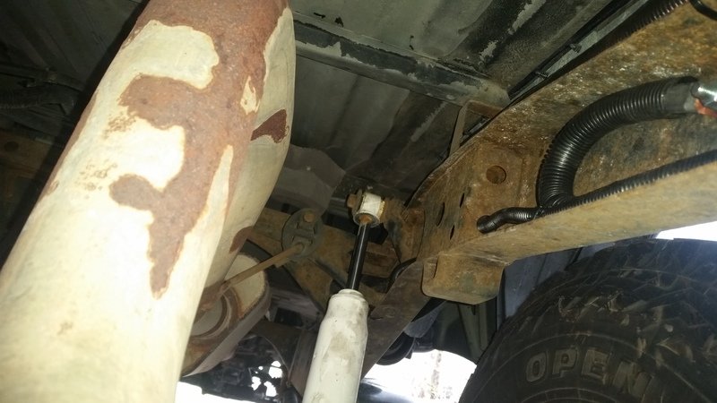

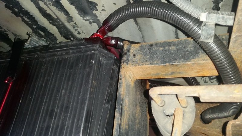

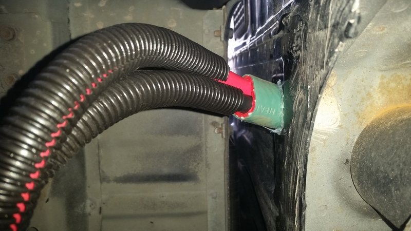

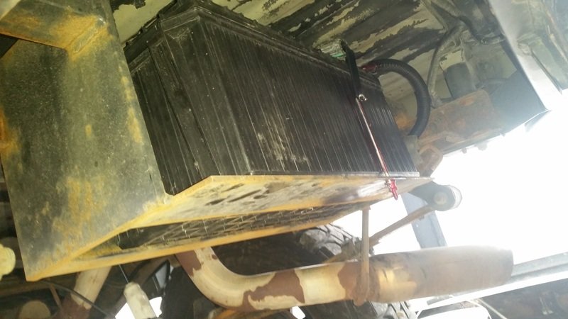

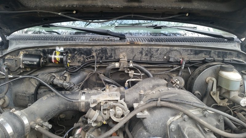

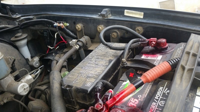

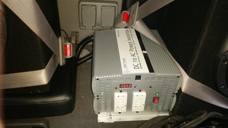

    Im running a interstate SRM-4D deep cycle R.V. connected to a stinger heavy duty battery isolator. And then routed through the frame from the spare tire area. I have a custom battery holder\frame reinforcement cage welded into hold the 117 lb beast of a battery in place. Then its wired with 0 gauge wire for maximum power discharge into my sine wave 6000 watt invert-er with GFI grounded outlets. Then looped into a mini breaker 1 foot away from the main battery so i can jump the smaller truck battery from the mega RV battery if needed. But my isolator system only discharges the big battery when using the power.
    The rear cage.
    The side wiring Fully loomed!
    and continuing through the the frame up to the cab. If you look close you can see the positive cable in the top of the frame. The body lift made it easy to do this and again fully loomed !!
    going through the cab up to the invert-er.
    the mini breaker and charge wiring. Sorry dirty engine bay after wheeling with my gap guards off what a mess!
    Finally my stinger isolator and invert-er.

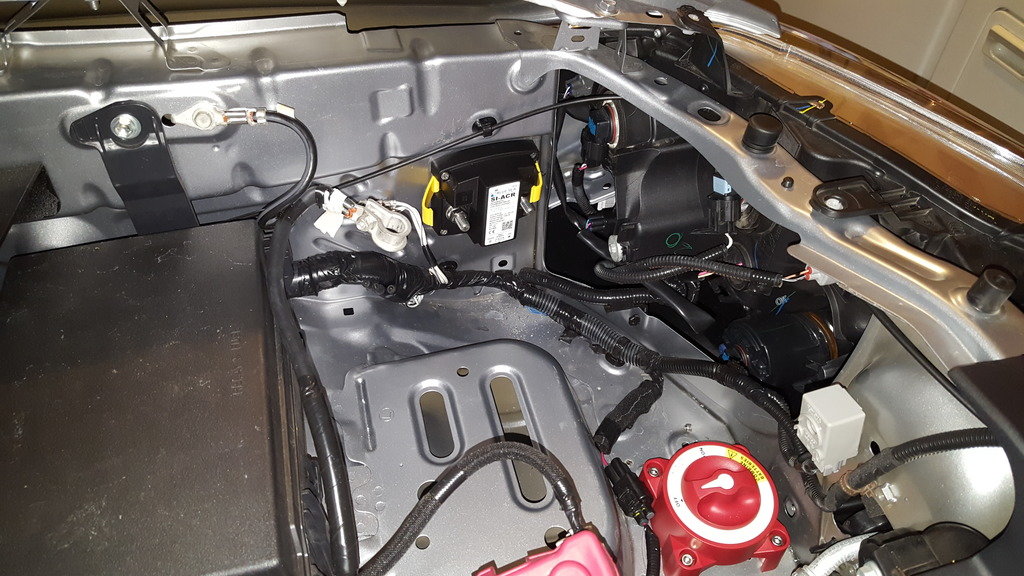

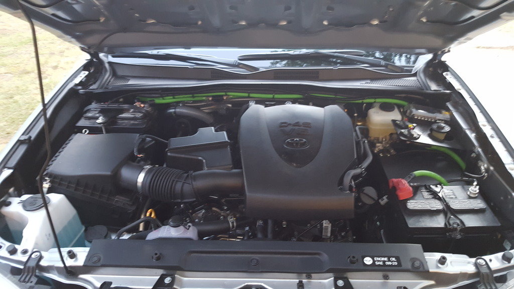

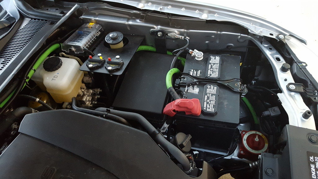

    Dual Batteries Blue Sea Fuse Panel
    Finished my set-up last week:
    Blue Sea Add-a-Battery Kit/Fuse Panel/285 Series Breakers
    Offgrid Engineering Battery Tray
    Pelfreybilt Fuse Panel Mount
