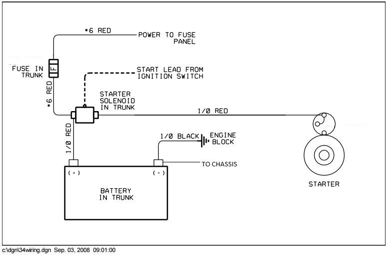

    Do they make these that will support high amps? I'm trying to move my battery to the bed but didn't wanna run winch and battery cable to bed. Was gonna run winch cable to power post under hood. Then 1/0 from post to bed.
    Bad idea ??

    Not a bad idea.
    There are no amp considerations to take into account with the power block because you are not relying on amperage to run though it. You are relying on the block to hold the two wire connectors together. It is the contact between the connectors that will carry the amperage. The power blocks come in different size bolts; so, one can argue to get the one with the largest bolt because that will require larger connectors which will have a larger contact area which will support more current travelling through the connectors.
    But, do you need the power block? Aren't you using a battery isolator? The winch cable can be connected to the side of the isolator having the aux battery cable. Or, do you only have a one battery system?

    I do only have one battery currently. Only issue that I can't et around is I wanted to use a marine switch for the winch to turn it off, and I wanted to add circuit breaker in the bed for the battery. If I do the power post way I can't really do the circuit breAker. I already have a power post by the fuse box for the factory power wires and some fuse lines for lights and stuff.

    You shouldn't fuse the wire going from the battery to the starter. Initial amp draw can be as high as 700 amps on a 4 cyl. That will eventually fry the fuse. The proper way to wire a remote battery is to install a remote high amp solenoid near the battery. That way the wire going to the starter is only energized when you start the car. The wiring going to the power post can have a fuse or circuit breaker. See sample diagram below.
