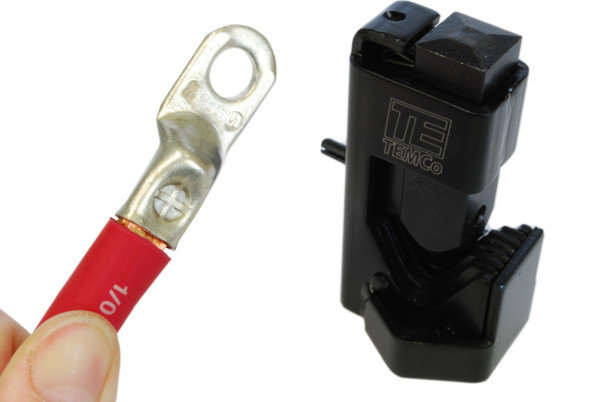

    How do you guys reccomend crimping on a lug for 2 gauge ? I do not have a crimp tool

    You will need some type of crimping tool to crimp properly.

    In the past I've used channel locks to squeeze on the center line or if the fit is tight enough you could just solder it and not crimp at all.

    ive done the soldering method before I had access to a hydraulic crimper, heat up the lug (inverted) with a torch then pool up a bunch of solder inside the lug, then cannonball that b**** in there lol

    Go to a battery shop.
    Got my Deka AGM battery here and they cut and crimp cable to length.
    https://deepcyclebatterystore.com/
    In the El Cajon industrial area, near the Santee boundary.
    Or, head east to Lakeside and I'll crimp it for you.

    Thanks for the offer. Ended up buying this. Used one before and it worked great

    I've got one of those, work great.

    How many times are you suppose to hit it with the hammer? Lol
