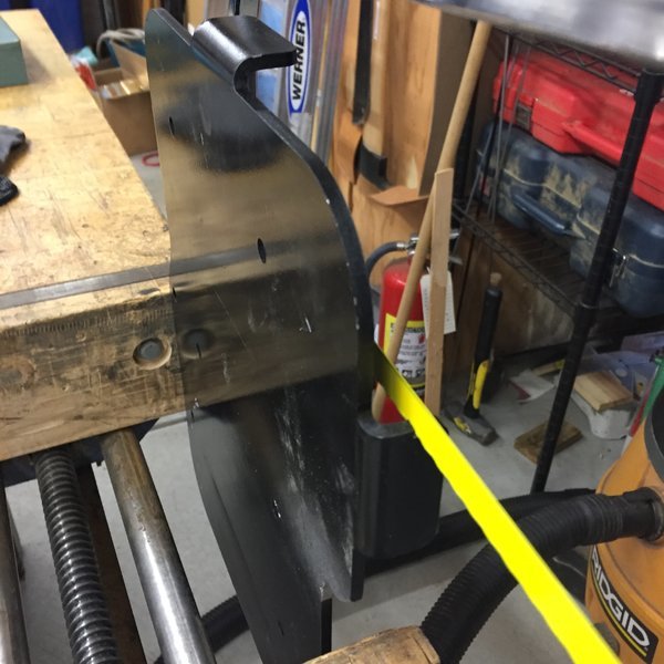

    Hello forum,
    I just finished installing the Armor Tech Offroad (ATO) Dual Battery Tray for two Optima Group 34 Batteries and thought I'd share some notes from the experience...
    First of all, the pieces from ATO are beautifully cut (water jet?) and precision bent - fit and finish was great (well, small problem with fit, but more on that in a moment) and I had a couple questions and the guys there were super friendly. Would heartily recommend this product, and ATO as a business from that interaction.

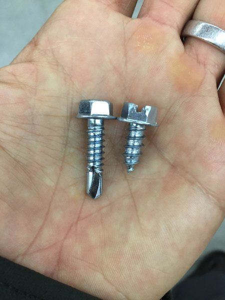

    One minor issue out of the box is that (as with seemingly all aftermarket stuff) all the fasteners are imperial. Needless to say, i've given up on trying to keep the truck metric, but this will continue to bother me. The hardware kit also came with these long self-drilling/tapping sheetmetal screws, but the battery stands on a little shelf welded to the fender and it's not long enough to take that whole screw body... and i own a drill... so I replaced them:

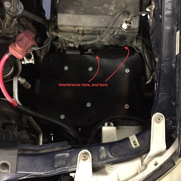

    I am not the most patient guy so I planned ahead and painted up the parts well in advance of when I was going to have time to do the install so i wouldn't be tempted to jam them in there still tacky. There is a bottom plate that goes in with standoffs that attach the actual battery tray. You kind of have to eye-ball the fitment and I didn't do a great job with this the first time... There's a single bolt that locates the center forward corner of the tray down low against the fender. But then you have to eyeball the tray to make sure it's parallel to the fuse box, but i found that dead parallel caused interference with between the battery and the headlight. Sadly, i found this out *after* drilling the first set of holes. I also found that the rear out-board tab that holds the battery was a little too tall to not hit the fuse box, so it had to be slightly trimmed, and the plate interfered with the original battery hold-down tab. So that also meant a little grinding.
    So much for nice hard paint...
    If you look closely in the image you can now see the rear-most tab is a little shorter and tucks in line with the face of the fuse box. ATO's instructions say to remove the little tab on the lid of the fuse box directly above the plate's tab, but i found that to be unnecessary. Also, you might be able to see already how incredibly tight it is going to be up against the headlight, and the main wiring harness entering the lower corner of the fuse box. Last thing, I also had to do a very gentle bend of the aluminum pipe coming off the radiator (or heater core?). Eek. Everything tightened down with Loctite, time for batteries and wires.

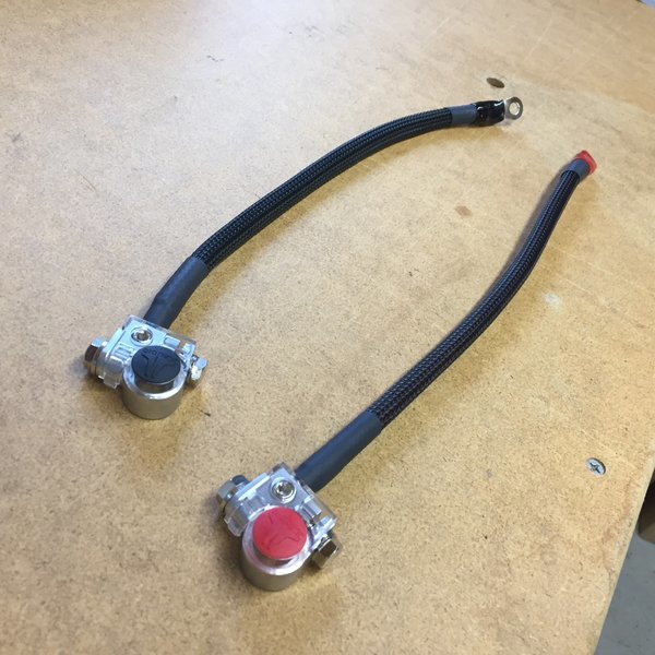

    The battery install is part of a larger plan for this truck that will involve radios, lights, and the like, and I'd been looking for a good installer to do the wiring for me. A friend in the emergency services world suggested some "tips" for figuring out if the installer is good. Do they use thin-wall insulation wire, wrapped in a loom? water proof connectors? heat shrink? solder or crimp? Etc etc. This is one of those areas where i definitely would err towards buying the best, cry once. I was pointed to Santa Rosa Cartronics (for those of you in the north bay area) and was really impressed with the quote - expensive, but doing all the right things. I got my two Optimas from them, and they whipped up some temporary interconnect cables - pretty nice work:
    When i get the lights, radios and power distribution ideas all sorted, I'll be back to have them do the "grand wiring."

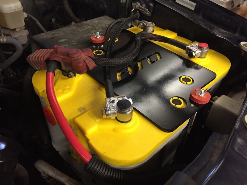

    Here it is all installed.
    You'll notice the outboard battery is basically touching the back of the headlight. Hopefully that doesn't cause problems in the future. I'll have to remove a battery to change the bulb, but I think that's the only practical downside to locating the batteries here.
    The positive terminal is now a janky mess, but hopefully i'll have this in at SR Cartronics soon to have that all cleaned up. Planning on a BlueSea ML-ACR, solar charger, house/main battery selectors for various systems... Gonna be fun. Here's a little teaser of where i plan to put some of this stuff:
    Time to go bend some sheetmetal!

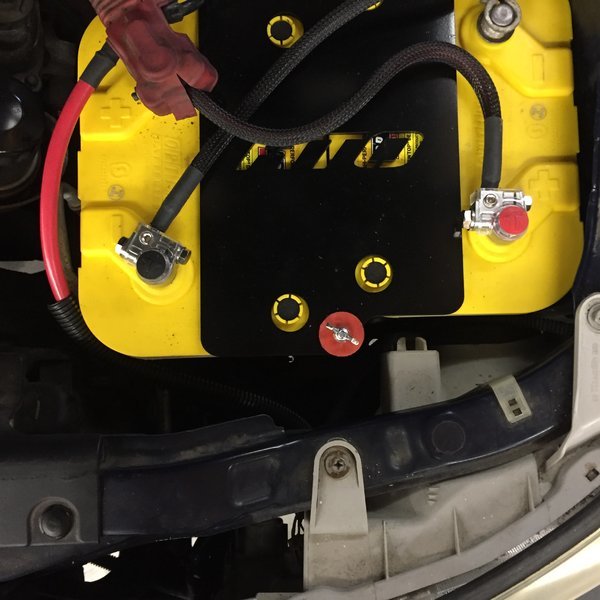

    Did you ever route that hose anywhere? I am in the minority as you are with the ABS module on the fender. I'm torn with going this way or relocating the power steering reservoir. My only concern with the different hose would be passing smog. Have you re-smoged with that different hose on? SMOG guys can be sticklers for any little thing that isn't 100% stock on the air system.
  20. Oct 27, 2016 at 6:58 PM
    #1320
    Chuy
    Chuy Well-Known Member
    Aug 4, 2008
    #8328
    4,134
    Lakeside, CA
    07 V6 DCLB 4X4 Sport
    Silver Taco
    Kinda hard to see in the pic, but air duct faces down at the bottom of the pic. I zip tied it to the upper rad hose. I hear you about CA being sticklers with OEM emissions. My smog is due next year and I'm prepared to remove aux battery and re-install the OEM air duct system. Should only take 10 minutes max, then I'm good for two more years.
