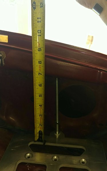

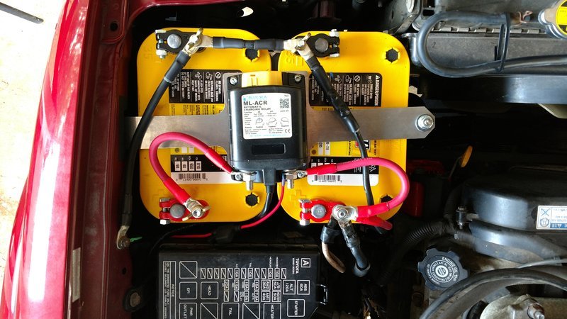

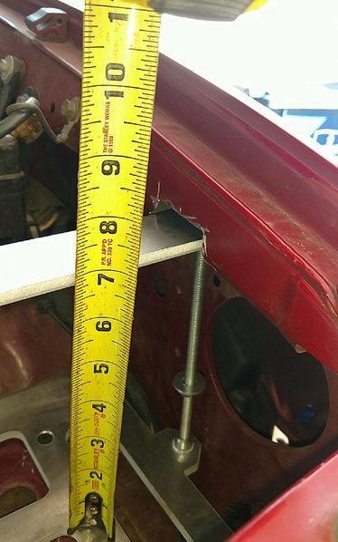

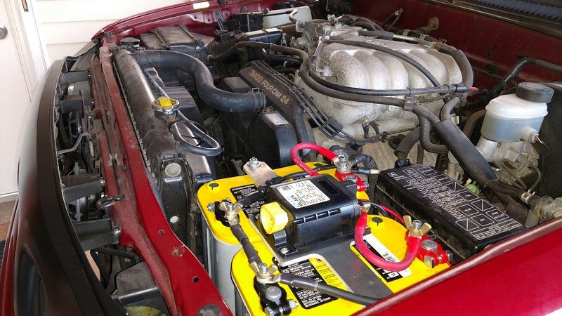

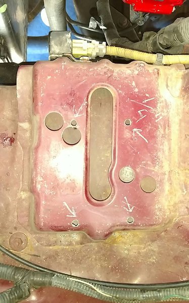

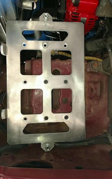

    Finally got around to getting my dual battery set up installed. Dual Yellow Top 35's, Blue Sea ML-ACR 7622, Off-Grid Engineering Plate and Tie-Down. Before tackling this, I completed the "Big 3" upgrade using 4 AWG welding cable and I replaced the alternator with a BNR Parts rated at 200 AMPs that is powder coated red. It took some work getting the plate and tie-down to work in my first gen but Matt at OGE has excellent customer service and helped me figure it out. I'm also waiting on a Peak DBI monitor to arrive from South Africa to install next to the switch.
    I had to drill four 1/4" holes for the plate

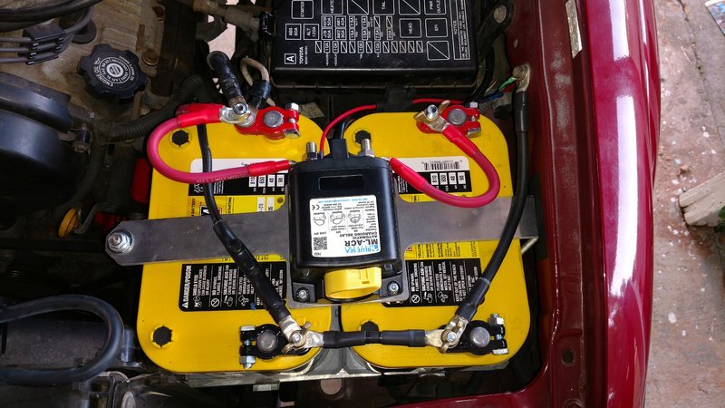

    The width between the all thread tie-downs was a little wider than the fender well allowed. That made the height of the group 35 batteries push the strap up too high, but I made it work. A 13mm stubby Gearwrench made this easier.
    VZM.IMG_20161101_120128.jpg VZM.IMG_20161101_140537.jpg IMG_20161103_170816860.jpg
    Here it is installed, the OGE tie-down strap makes mounting the ACR on top very convenient. I used a universal coolant overflow reservoir instead of the OEM and relocated it to the passenger fender well. I'll clean it up a bit more in the future.

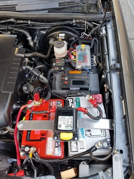

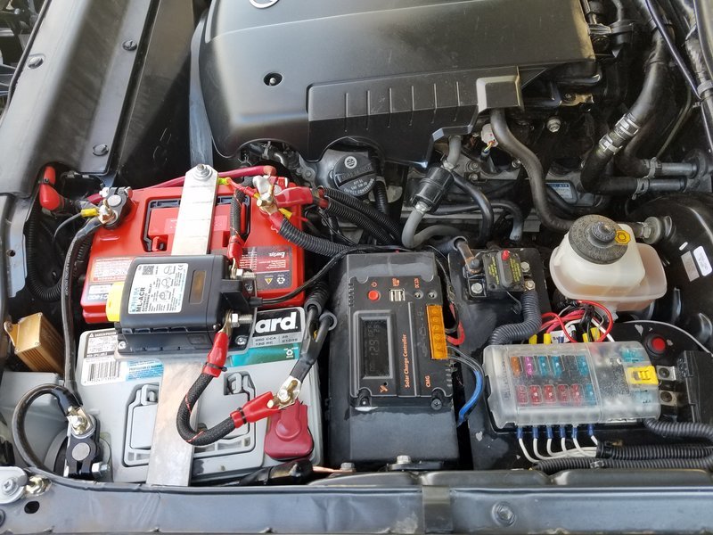

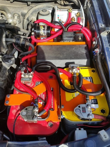

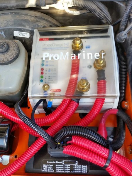

    This here dual battery set up is with dual Optimas. The dual battery Stage 4 wiring kit and SSCS Kit was purchased from @BamaToy1997. Great products!!!!!
    Dual battery wiring Stage 4 kit and SSCS Kit

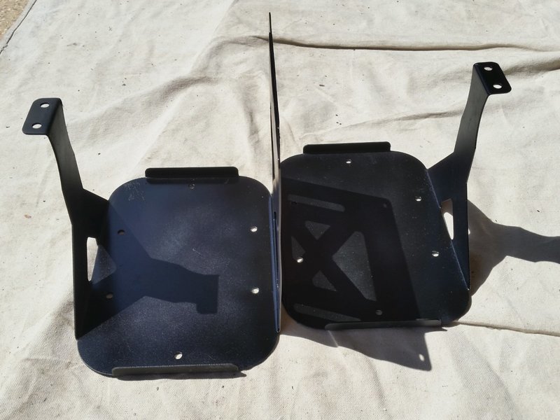

    I didn't want to spend a lot of money for a dual battery tray, I purchased from Ebay for less than 20 dollars a piece. Then they were modified and welded together. So my dual battery tray cost about 50 dollars after welding and paint.
    The orange bracket that is supporting the SwitchPro, ProMariner Controller and Stinger Solenoid was fabricated by myself. It bolts to the drivers side fender at 2 places and bolts down at the bottom of the wheel well. So there is no vibration/bouncing of the components.
    Dual battery install.

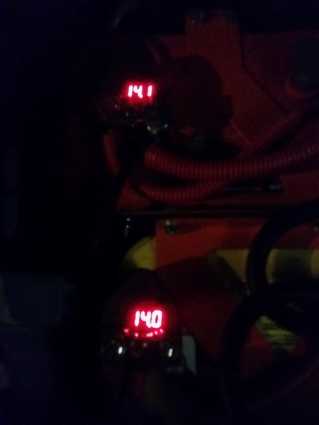

    Digital Voltage Meter battery terminals.

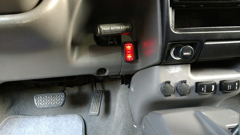

    I also installed 2 digital voltage meters inside my cab. Top is start battery and the lower is accessory battery.

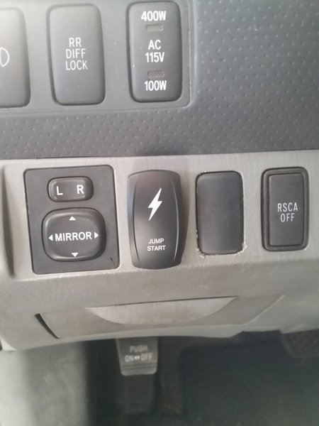

    The SSCS Kit (Self Starting Control System) is used when your start battery is dead, you push and hold the Jump Start switch and turn your ignition to start your engine using your Accessory battery, then release the switch after engine start.
    This is my first major write up of this install. Just never got around to doing this. This mod is not an easy thing to do if you are like me and only have general electrical skills. My friend is very knowledgeable in this area and helped out a bunch. Couldn't have been possible without him. I did not want any wiring or components interfering with the removal of the top of the fuse box. As you can see, all the wiring is run around and underneath the fuse box. Easy access in case a fuse replacement is required....

    Very nice! That is a very crowded space. No room to spare that's for sure.

    Would like to know more about that bracket you fabricated. Very nice!
