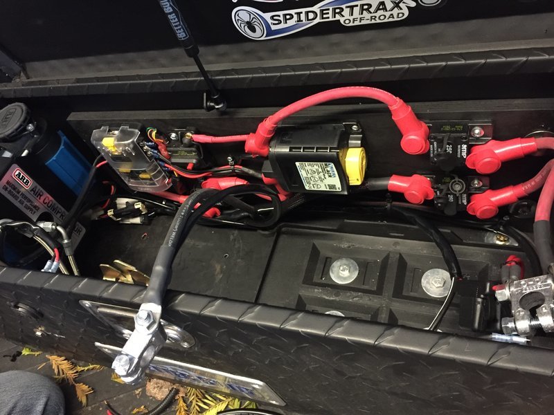

    Just FYI. If you go with the blue top optimas, you only get a 2 year warranty. If you choose the yellow top, you get a 3 year warranty.
    I know the additional post is nice on the blue top, but with the milspec terminals you are using, you should be fine.
    I chose to go for the extra year of
    warranty personally. Just my .02.
    running a bunch of power wire through the truck my only suggestion would be to add circuit breakers. We put a bunch of them in my setup. Probably overkill, but id rather go overkill then have shit catch on fire. Check McMaster Carr. They had some good ones for a good price.
    And don't forget good terminal ends.
    Luckily i had @Iggy. helping me. He is a wiring nut! :DIMG_2684.jpgIMG_2686.jpg

    Like that? ^^

    That's an insainly cool setup with battery in back, and dual compressor to boot!! Any write ups on your setup?
