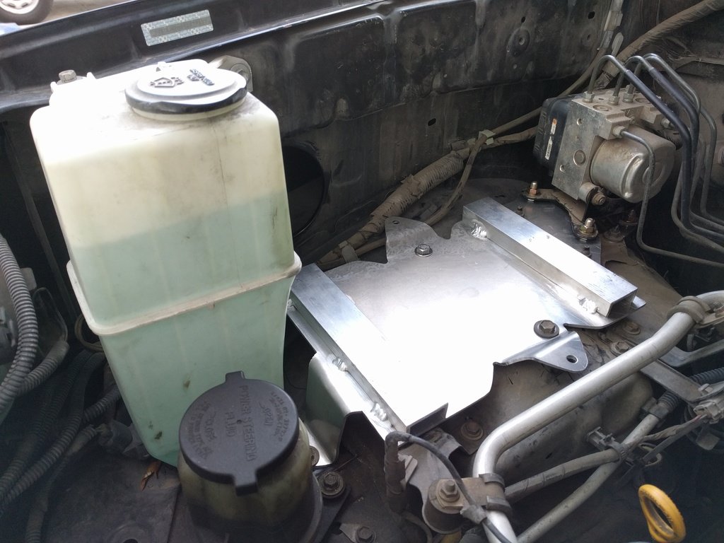

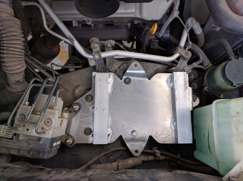

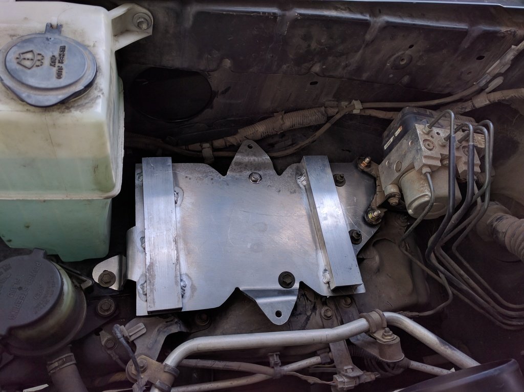

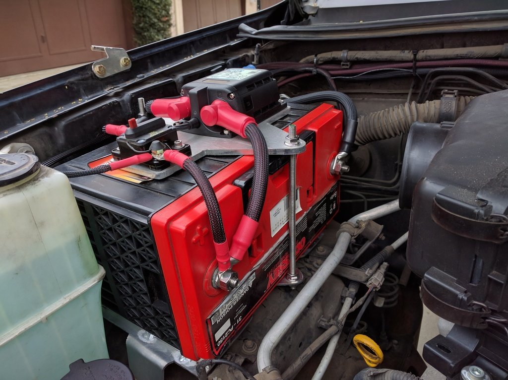

    Mine is nearly complete! Here are a few in process shots
    Bray1197 likes this.

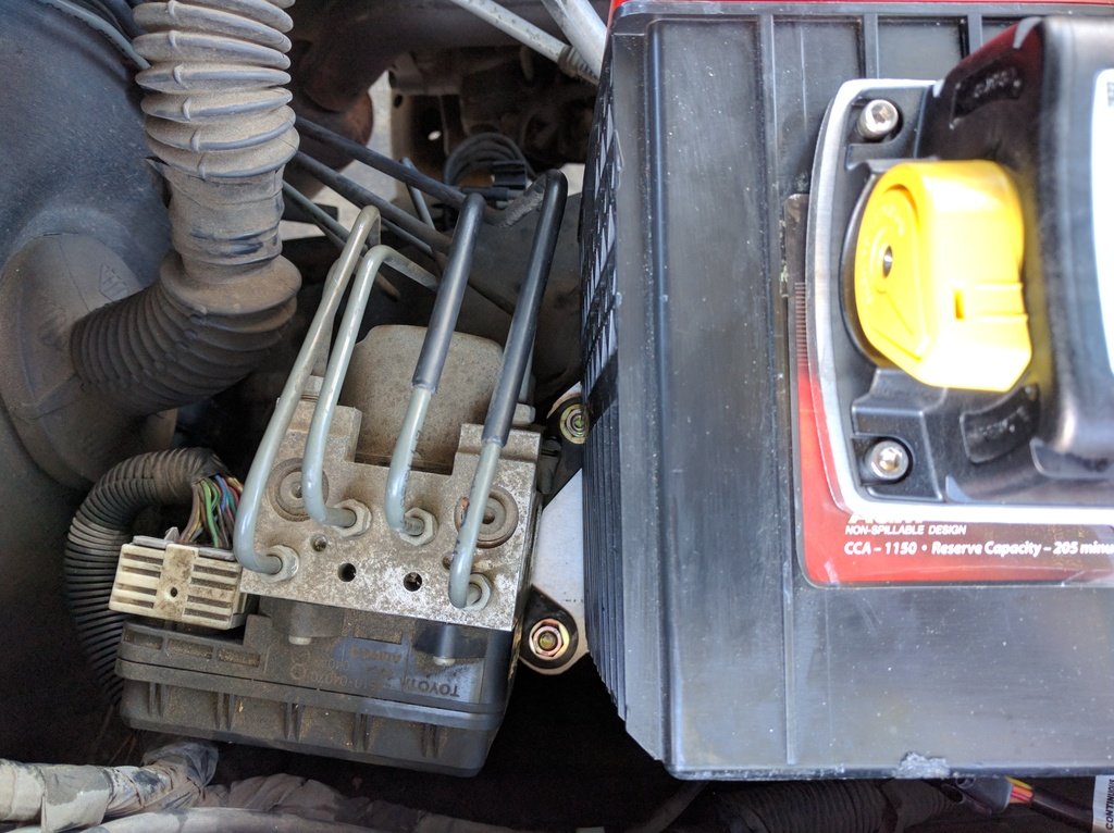

    I had to relocate the ABS module and remove the snorkel to make everything fit, but the group 31 odyssey battery fits!
    You can see the ABS module has been scooted over about an inch
    Bray1197 and Thelgord like this.

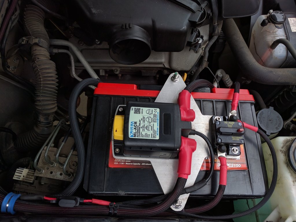

    Probably just leaving it as is. Someone else previously added a flex hose to pull in some colder air. I might do that. Look at these:
    https://www.tacomaworld.com/threads...-batterys-thread.295653/page-58#post-12632228
    and there was another one, I think Chuy. Only reason for removing the intake hose was because the ABS module was in the way of where most dual batteries go.
    Fixed, had to use a different host.

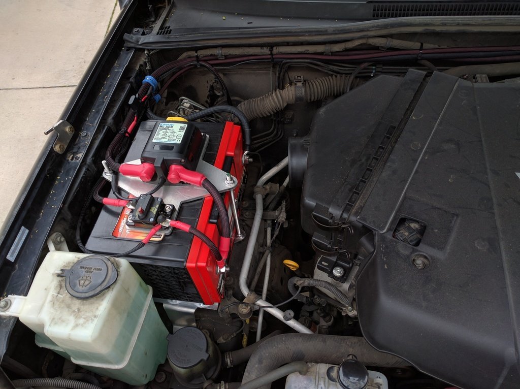

    With the battery, ML-ACR, and power supply breaker installed! The switch for the ML-ACR is in the center console, I still need to make a little bracket to hold it in place.
    I ran power all the way to the back of the truck and mounted a 12 circuit blue sea fuse panel in one of the side utility boxes. I added some cheap Amazon LED string lights with a wireless remote and strung them up inside the flippac :)

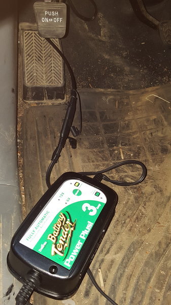

    I found this 3 amp 4 stage charger at costco on sale for 30$, I ran the plug into the cab of the truck. Cut the grommet and sealed it back up with silicon.
