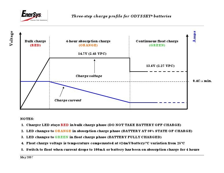

    If your charging system is going down to 13.8V then you are correct Toyota may have implemented a smart alternator.
    AGM is charged like a wet cell lead-acid. You notice the 3 primary stages and the voltage and current at each. he bulk-to-absorption voltage is 14.7V typically for AGM and 14.6V for flooded types, but that's not hyper critical.
    This is the profile for an Odyssey AGM. I wouldn't get too wrapped around the axle on the exact voltage and current. Unless you design your own charger it's unlikely you will match them 100%. You can only do your best.
    You will have to do some experimentation or research to know how it's working and what you'll have to do for dual batteries. Your charging system is still doing a higher voltage at some point to charge the starting battery. With a smart alternator it may do something higher than the traditional ~14.4V like dumb alternators. It might actually be fine to just parallel the two batteries.
    You'll have to see how the charging system reacts to a DC-to-DC converter, since it will need to still be generating sufficient power for it to work. Even with a DC-to-DC your aux battery may not recharge if the current is too low. Remember that voltage and current are related by power. If the smart alternator has dropped its voltage that means it's also probably generating less current (less power overall).
    If you boost the voltage the power in must remain the same as power out, so current goes down proportionally (13.8V x 10A is 138 watts and will be 14.8V x 9.3A 138 watts out). When you do this the charging system may react and go back up. You'll want this to happen because during bulk particularly the current needs to be high enough not to starve the battery.
    In any case the converter will probably help smooth the charging on the aux battery so that it doesn't see the ups and downs.
