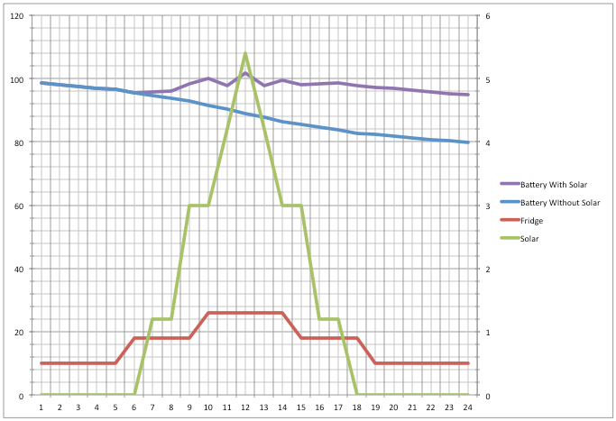

    There may be some advice to be found for RVs and boats on the amount of charging you need compared to battery. All I can offer is my opinion and experience, which is limited to very simple electrical systems. I run a fridge, winch, ham radio and have chosen to keep the stock system just about completely stock. Point is YMMV.
    What you have to think through is how much charging you have available and the details on how it's made available. Our stock alternators are either 90A, 100A or 130A depending on what options you have. For the sake of argument lets just say we are using the upgraded towing and offroad 130A for the time being. This number is the rated capacity of the alternator but that doesn't mean this is what you get in all conditions. In fact this amount of current is generated only in a very small window of engine RPM and temperature. If the alternator is spinning slower than the rated RPM or the temperature of it is warmer then the output is reduced. This can be very significant. At idle the alternator might be half it's rating.
    So you need to run the numbers for how much energy you will take from the batteries, both normally and under a worst case scenario. Then assume how much the alternator will generate and you'll then know how long it will take to get back to 100%.
    Let's say you eat up 40 amp-hours of energy over a day or two running a fridge. If your average RPM is maybe 1500 while driving on the trail and that puts (in theory) the alternator output at 80 amps then you'll need at least 30 minutes to return the bulk of the energy. It will actually take longer than this to reach full charge but for the sake of argument you get the point.
    The main reason for this is the truck itself uses power to run the ignition, lights, radio, etc. So even if you have 130A at the alternator only the excess that isn't used by the truck will be used to charge the batteries. I honestly couldn't say how much this is. The truck itself is probably 10A or 20A but headlights will eat a lot of energy, A/C or heat (the fan) would, too. My guess is that at night the truck probably doesn't have much excess current to give, so factor this in.
    Now if you suddenly need to winch yourself you don't want the alternator trying to also charge the aux battery. Same with running lights or a radio. You just need to know what the various draws will be and think through scenarios and probabilities of thing happening. IOW, list the things that are essential, important, optional, etc. When you run through the list you'll come up with anticipated needs that you compare against available power.
    You /need/ the truck to run and start. You would probably want to have a fully charged main battery under all conditions. I personally left the stock system intact, which has a constant small draw to the ECU and stuff. So there is a limit to how long I can leave the truck without starting or charging. I know from experience that this is actually several weeks, but it's not forever. So as long as I don't leave lights on I'll be fine.
    My fridge draws about 2 amps when running and I know that when it's really hot outside it will run as much as 50% duty cycle. That means it's running 5 minutes, sitting idle 5 minutes, within any 10 minute period. So that means it's using about 1 amp-hour in hot weather. Since I run a 65 A-hr Odyssey I can in theory run 65 hours between charges. In reality you can't really get all the capacity from a battery since that means running it to 0%, called a full discharge. This is usually measured at 10V on the terminals. Besides this being bad for a battery it's also not practical since my Engel shuts off below 11V anyway. In reality I can get more like 45 to 50 A-hr before nothing will run anyway. My rule of thumb is 36 hours before I start thinking about charging the aux battery. With larger batteries you can go longer obviously.
    Since the ML-ACR will prioritize it takes some time before the aux battery is even brought online. Normally this is only a minute or two since starting doesn't really take much energy and the battery is usually at 95% or whatever. Once the parallel batteries are connected then the clock is running.
    KEY POINT - Our stock systems can handle a second battery without much worry just as long as you realize that it will take some uninterrupted running to get the batteries both (or all) back to fully charged.
    Toyota selected roughly a 1:1 ratio of max alternator to battery (a 27F being about 100 A-hr). In my case I have about 130 A-hr of battery so I haven't moved it very far. If you leave the stock battery in place and add a big deep cycle you might go from 1:1 to 1:2, a 130A alternator with a 100 A-hr main and a 100 A-hr aux. That's still not excessive or too badly imbalanced IMHO. There's a point where your expected load does exceed alternator, but that's probably going to be with an inverter or lots of lights that may be running when the engine is running. That takes away current that could be charging.
    Where you start to get into what-if would be having a run down aux battery and a sustained winch session that also draws down the main battery. You could end up with two dead batteries and a real PITA if you stall or something. The likelihood of this is extremely small but it's not impossible. That's why people chose to add solar so that a second battery doesn't just run down but can still serve redundancy to back up a main for winching or if it dies in the field.
    BTW, part of the reason I prefer to have the winch on the main battery is because the aux battery in my truck is likely to be discharged and I don't want the alternator to fight with the winch if both want lots of current. I'd let the aux battery stay discharged if I had to winch first thing in the morning. Also a winch is more like a starter so if someday I want to put in a real deep cycle I wouldn't want to have to rewire things. Plus I like being able to isolate the aux (back-up) from the main should winching cause a failure perhaps to the alternator or wiring. I can decide to shut off the fridge and force the ML-ACR into isolate, cold beer being only slightly less critical to survival, to preserve the charge on it.
    If you have 100W of solar that can generate, say, 6A of charging current then you can significantly extend your times between starts. But you have to watch average charging here, too. That 6A will only occur at noon with bright sun and cool temperatures. Over the course of a whole 24 hours a solar charging system will only generate during daylight, so automatically you get about 50% knocked off and if it's hot the panel efficiency goes down, at low incident angles it goes down.
    You can probably assume a 100W panel will give you more like 2 or 3 amp-hours during the day and so you get more like an average of 1 or less amp over a 24 hour period (e.g. returns 24 A-hr, which is probably a high estimate TBH). That means if you're lucky it's going to offset a fridge running. But even if it can only keep up with 1/2 the daily fridge consumption that's a serious advantage over nothing if you want to leave it parked for a day or two.

    The solar part got me thinking so I put together a hasty spreadsheet to demonstrate how solar helps. It's not exact or anything since the formulas don't really act right when the battery fully tops during the day. But you can see the difference between having it and not at the end of the 24 hour period. There are a whole lot of simplifications and assumption in this... FWIW, it's based on a 6A charging current and a 2A load with various duty cycles and efficiencies.
