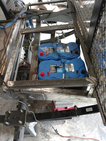

    Do you disconnect or unlatch the batteries when you are using this? I'm about to pick one up.

    Yes, I manually disconnect the batterys with the ML-ACR

    2014 Super White DCSB 4x4 TRD OR
    LOTS OF MODS
    Cool thanks!
