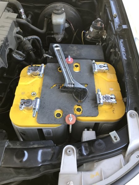

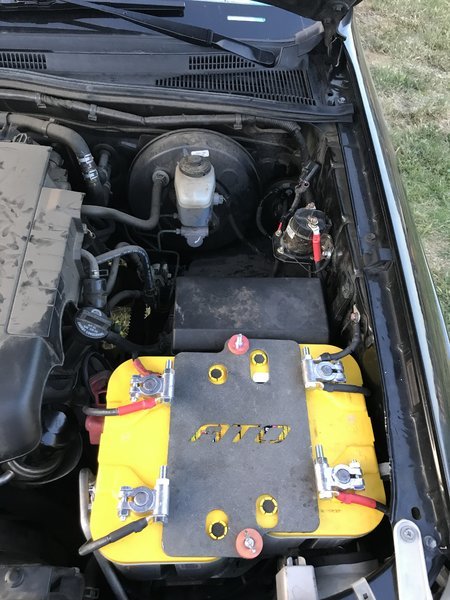

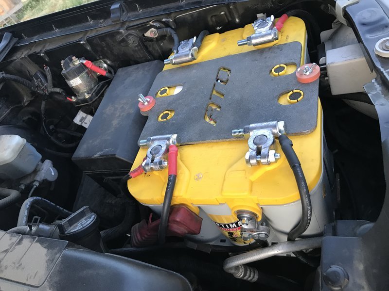

    ATO with painless dual battery setup maybe eventually I'll go blue sea, but I got the painless for the right price
    ATO pre-wiring
    new terminals
    Finished minus 1 wire for manual connection
    tetten likes this.
