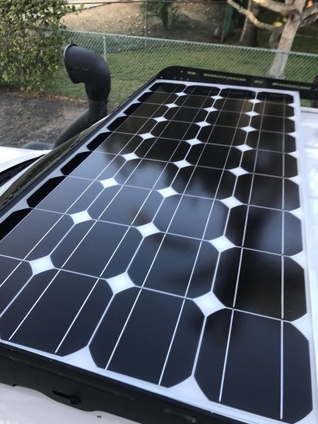

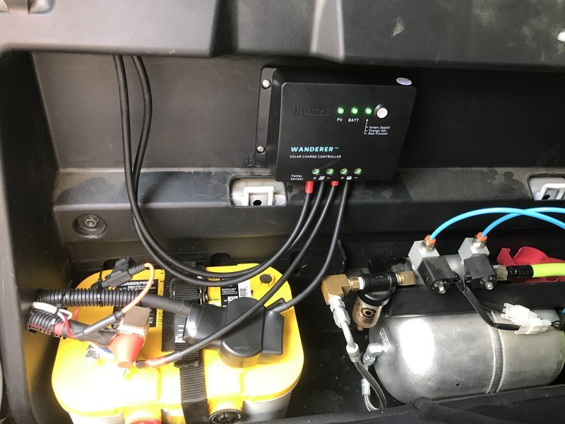

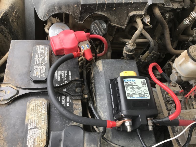

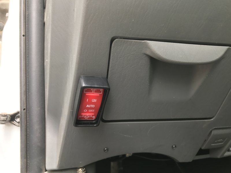

    Finally got my dual battery setup completed!
    100 Watt Renogy panel mounted under Prinsu crossbars:
    Wired to Wanderer charge controller, then direct to house battery:
    1/0 wire from house battery up to the ML-ACR + aux fuse panel for all accessories.
    All wired up to the in-cab switch:
    Tested out on two 4-day trips now and I couldn't be happier with the setup! Now I just need to test my ARB fridge's ability to keep ice cream frozen in 80 degree heat!
    Thanks to @Nate87 for the help!
