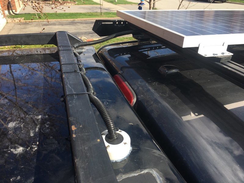

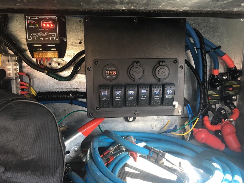

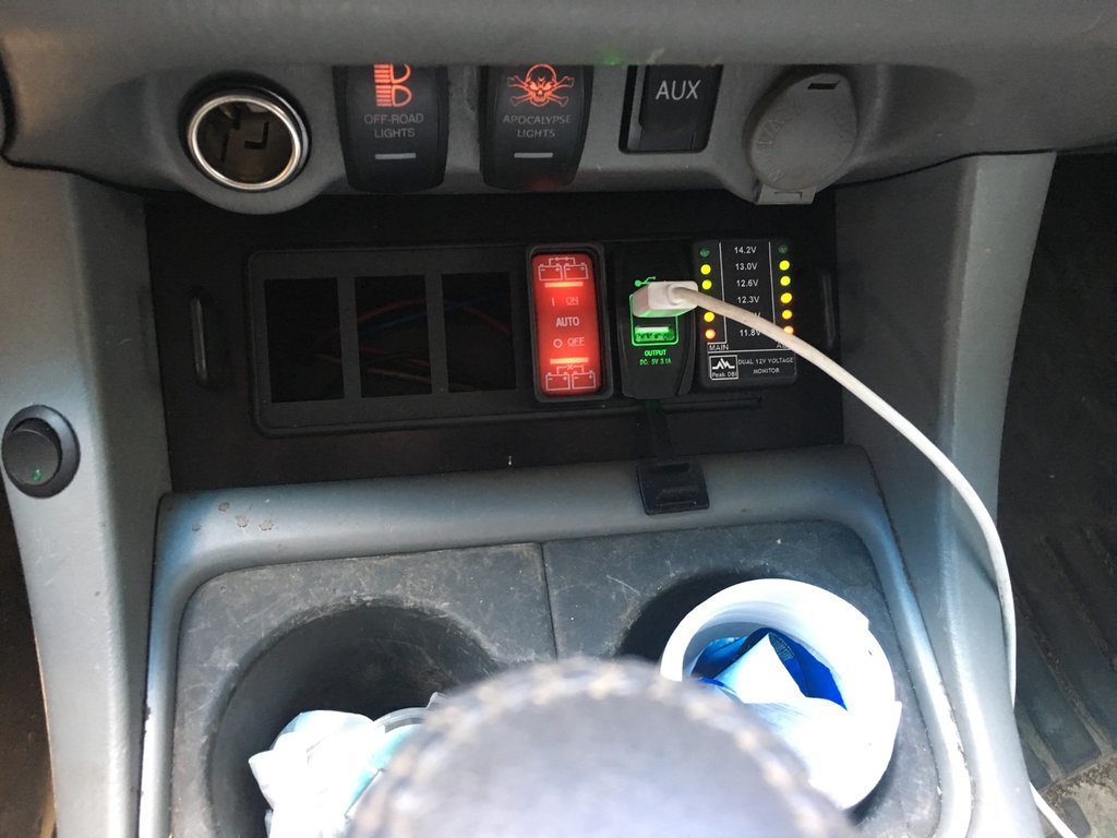

    Thanks. Took a bit of time, but very happy with it. Can run my fridge all day while driving, and when I park, my solar setup should top off the battery enough so the second battery doesn't shit the bed. I have run the fridge for 4 days on solar alone. With this setup it should be no issues.

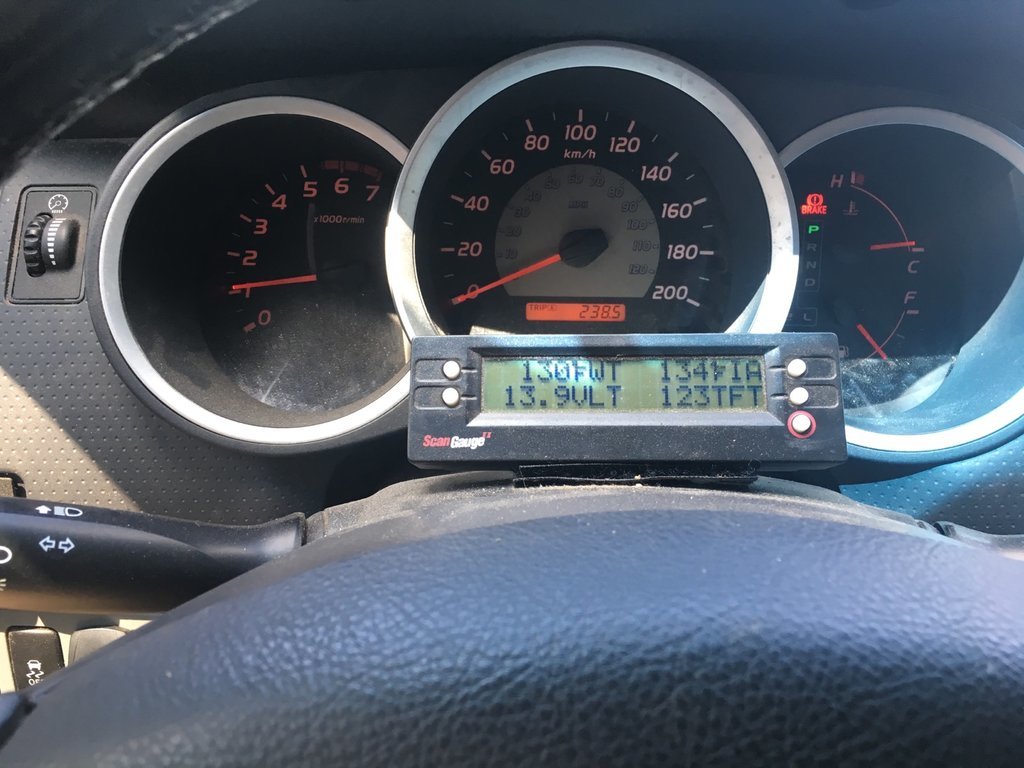

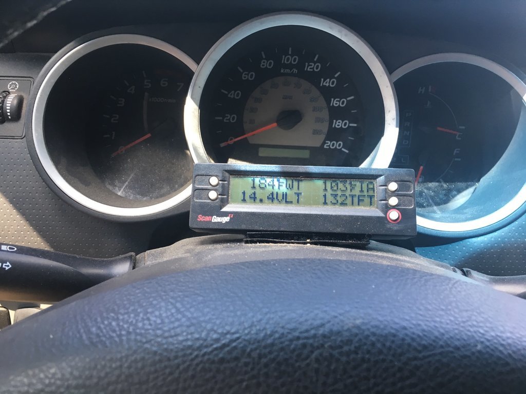

    No. I figured with the demands im putting on the system it wasn't too detrimental. I'm really only running the fridge off the second battery and the inverter and lights are only ran the odd time. The solar system gets it to 14.4 volt charge though (when the fridge is plugged in it varies). Then when the truck is on (engine running) it goes from 13.7-14.0 in the summer. Winter it tends to go a bit higher. I really only wanted the second battery to be topped up as the solar could keep up on longer trips (could run the fridge for 4 days continually on solar, but I'm sure it wasn't great for the battery).
    Do you see any flaws in not doing the unsmarting the alternator? I didnt read too much into it so I'm hoping I'm not messing anything up. I think this is one of the benifits of running the dc to dc charging.

    you are absolutely fine with your setup. A smart Alt. won't produce the full constant 14+ volts that a AGM style battery demands, but you are achieving that with the solar.

    Gotcha. If my batteries start dying prematurely I'll have to look into unsmarting the alternator. Thanks for the heads up.

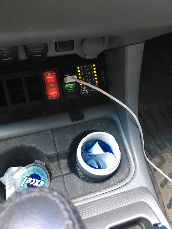

    I have mine mounted next to a usb and a battery voltage monitor, and have not noticed it being overly bright. Haven't had any issues with the ACR switch. Will double check the temp of the switch on a longer trip though.

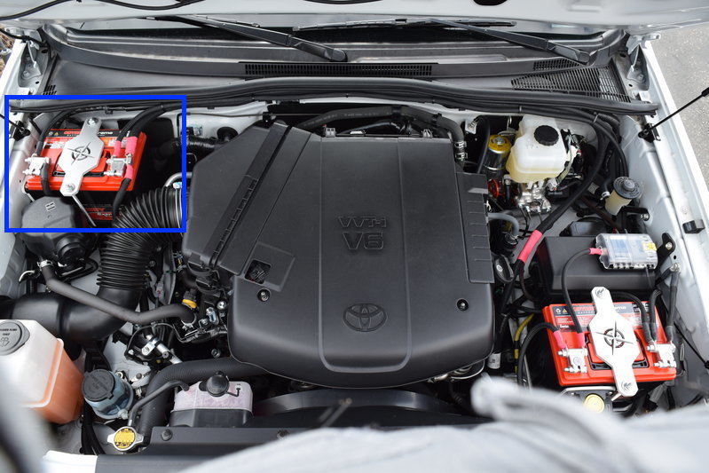

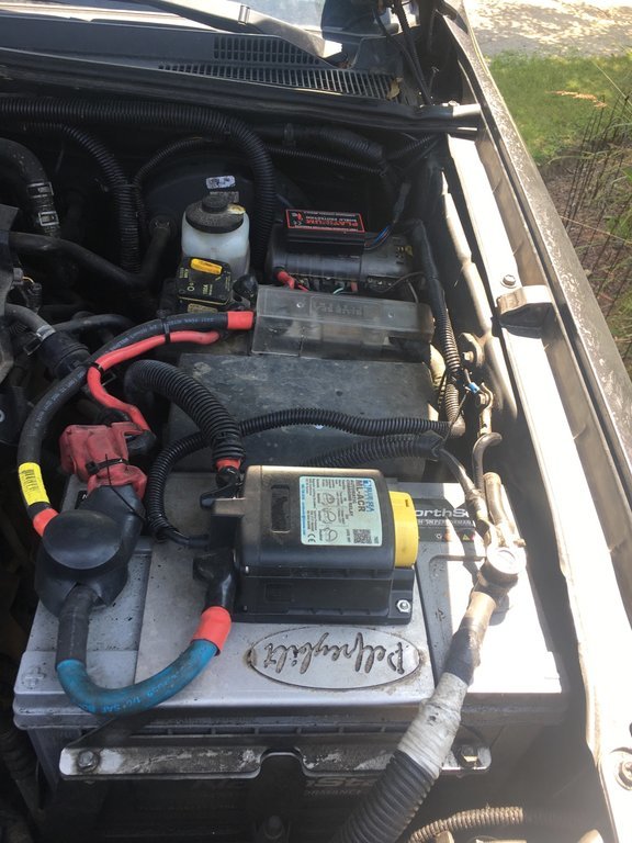

    So, after sitting on most of my parts for almost 2 years, I finally knocked this project out. Only ran into two problems. 1. My solder Fu is weak. 2. The battery base plate rubs up against a coolant hose. So, I did the best I can with solderless connectors and I'll have to wrap the hose with something to keep the plate from rubbing through and causing a leak.
    Other than that, I think it turned out pretty good. I didn't blow myself up and I didn't let any smoke out of the components. I'll need to get bigger batteries eventually, the Optima's I sourced were originally for another vendors battery tray. You can see that there's a couple inches of space on either side of the batteries.
    Many, many thanks to all my fellow TW brethren who've posted in this thread. More than a few questions I had were answered by using the search function. I still need to hookup my Peak DBI dual voltmeter and deal with the hose rubbing, but it took me about 6 hours to get everything done today. Very happy to have this mod finally done.
