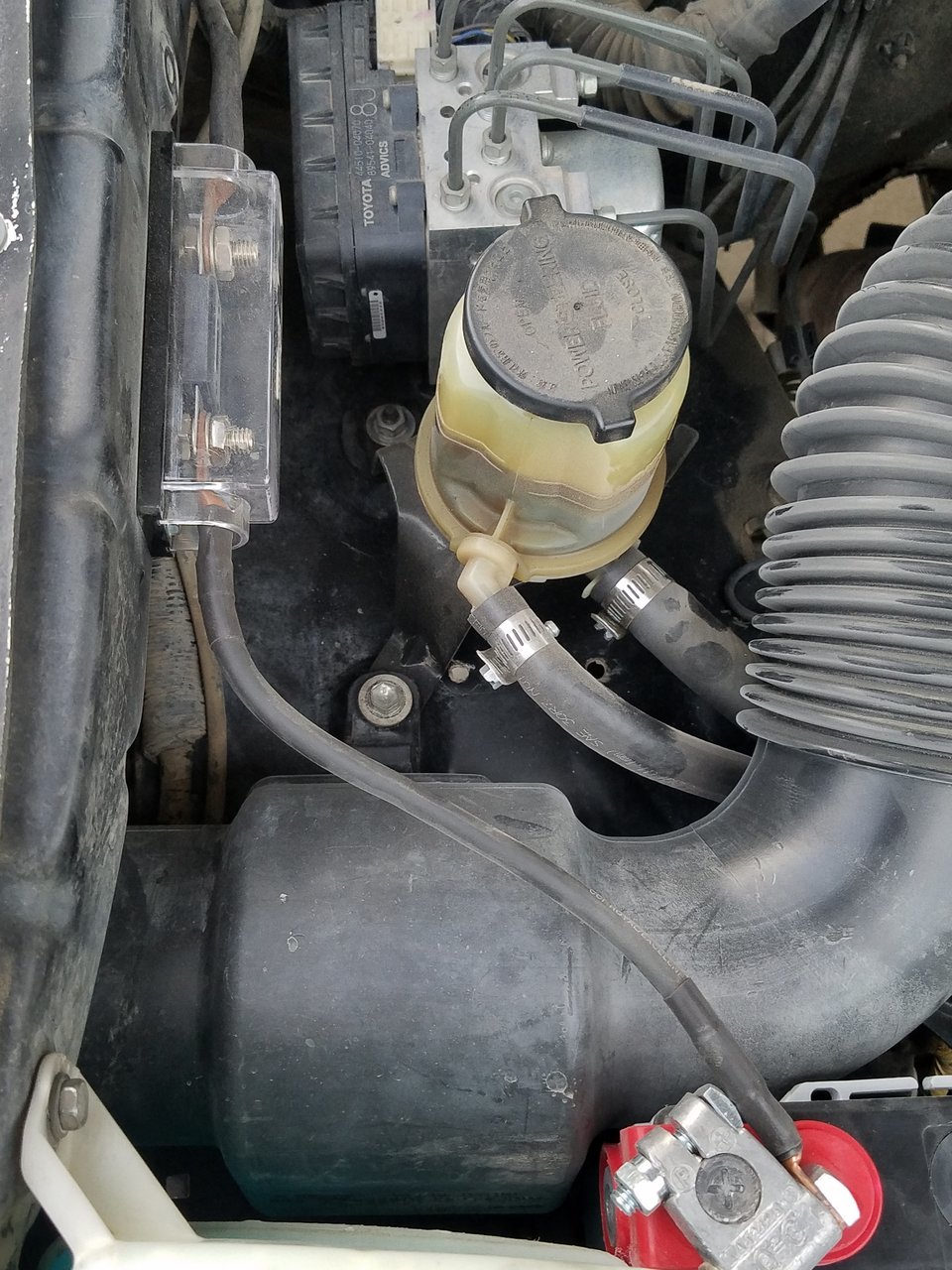

    MonkeyProof
    MonkeyProof Power Top
    Oct 7, 2008
    #9774
    12,825
    SoCal- SGV
    Power Steering fluid bottle bracket fits perfectly when relocating using part of the ABS Module and the air intake tube without modifaction to the bracket.
