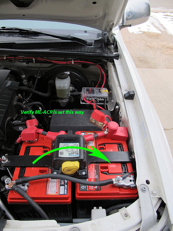

    Anybody with the duel battery running Blue sea ml-arc ? Think I am having issues. My ml acr is blinking twice not sure what this is indicating.
  19. Jan 19, 2018 at 5:00 AM
    #1819
    DaveInDenver
    DaveInDenver Not Actually in Denver
    May 18, 2013
    #104390
    3,619
    David
    Grand Junction
    2008 Super White TRDOR AC 6MT
    Unexceptional
    Is it a repeating two blinks then pause? That usually means you put the ML-ACR in manual override.
  20. Jan 19, 2018 at 5:41 AM
    #1820
    Manwithoutaplan
    Manwithoutaplan the full Monty
    Jan 30, 2008
    #4500
    54,643
    ID
    yea it is set this way ^
