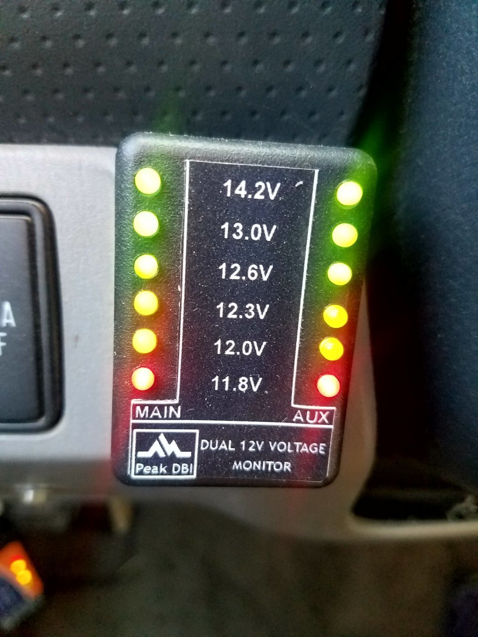

    Finally got around to hooking up the rocker switch for my ML-ACR.
    What does the led in the switch do? Mine doesn't light up in any of the 3 positions.
    I hooked it up per the wiring diagram off the Bluesea website. The switch does function properly, but the LED does nothing.

    The LED indicates when the batteries are tied together.
    Hit the switch on the ACR to tie the batteries together. If the LED does not light, there is a wiring issue.
