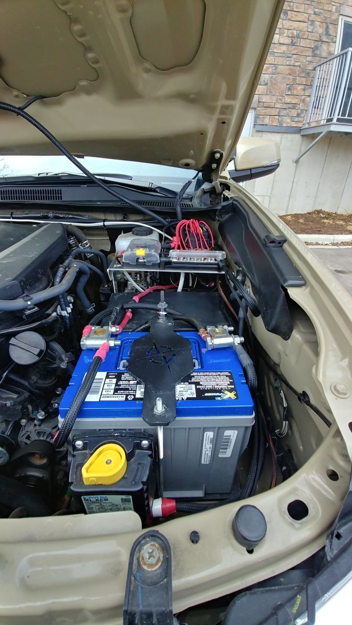

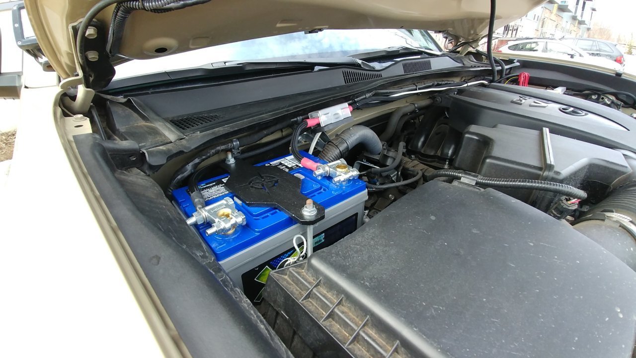

    Installed mine the other day.

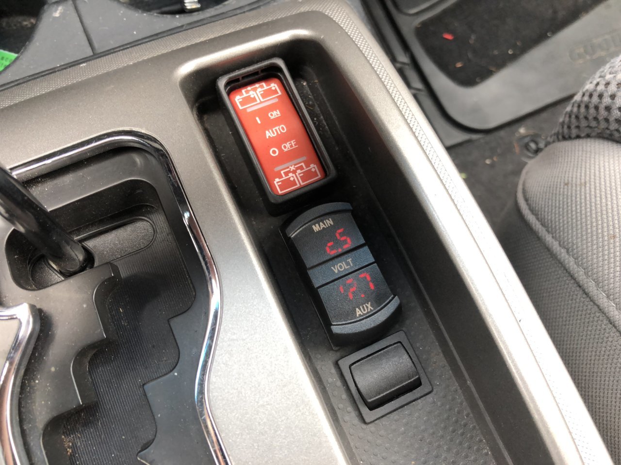

    I've had a dual battery setup for a while now, but today finally added a voltage meter so I can see where they're at. (Obviously the numbers actually work, but the camera shutter cuts some of them off):
    The little switch below turns it on and off. The meter I got here: [​IMG]$17 MICTUNING LED Digital Panel Double Voltmeter, Rocker Switch Style Voltage Monitor for Car Pickup Truck Dual Battery Pack (Red)https://www.amazon.com/gp/product/B077XDHQNR/ref=oh_aui_detailpage_o01_s00?ie=UTF8&psc=1 and the switch was from Fry's down the street.

    Its a Wurthco tray with new mounting holes drilled.

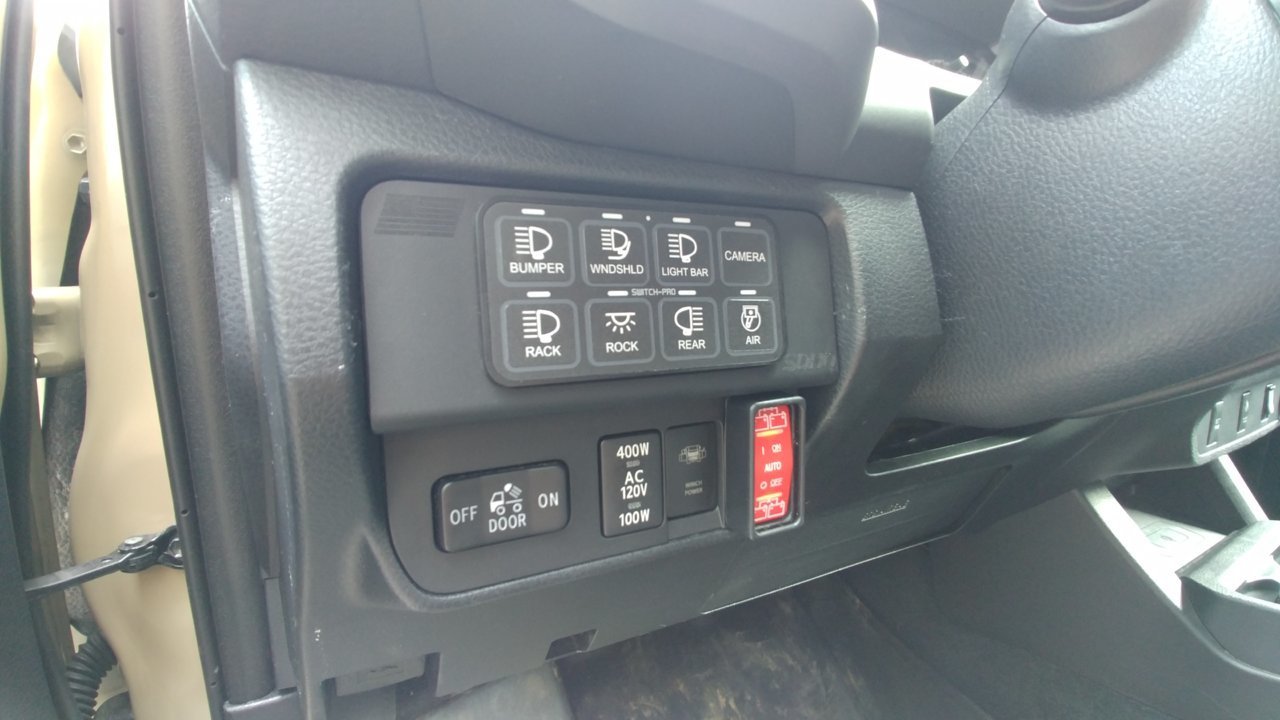

    Finally hooked up the Peak DBI dual voltage gauge.
    I bit the bullet and finally convinced myself to drill a hole in the dashboard to install it.
    Its wired to 12v+ switched source for the starter battery and 12v+ constant for the house battery.
    Has any one had any issues with this gauge draining either battery over a long period of time? I kicked around the idea of putting a switch on the ground side of the gauge but didnt.

    I got to drive the truck in the dark tonight. Fortunately the LEDs arent bright or obnoxious or really even in view from the driver seat. The steering wheel does a pretty good job of blocking them.
    I wanted to put the gauge somewhere where I could view it with a quick glace from the outside of the truck by looking into the window. This seemed to be the best spot.
