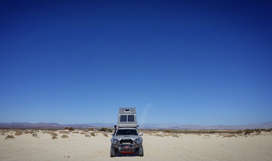

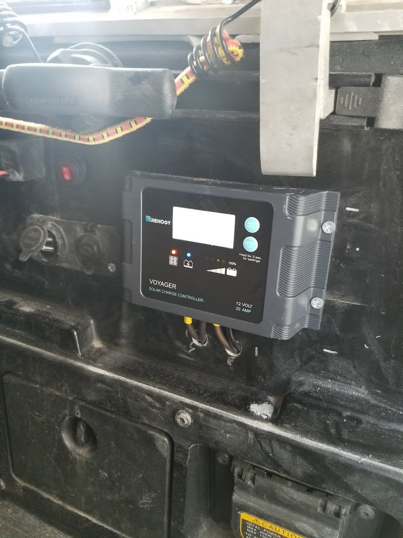

    dont know if i posted mine on here but here are some pics form my setup, acr on the passenger side, house battery is in the bed with the 2nd fuse box as well as the solar controller box -- solars on roof

    Thats nice, looking to do something like your setup with the compressor and solar. By the way hows the solar power?charge been?

    unless you running a fridge on freezer mode and a hungry inverter, i would just stick with one panel

    I had a single panel (and dual batt) with my old Edgestar fridge and it could barely keep up after 3 days of being stationary. I recently added a second panel and new Dometic fridge and I was able to maintain being stationary for 4.5 days. It stayed at 14v during the day and dipped down to 12v at night. Was awesome not to worry about it all and concentrate on camping/partying :cool:

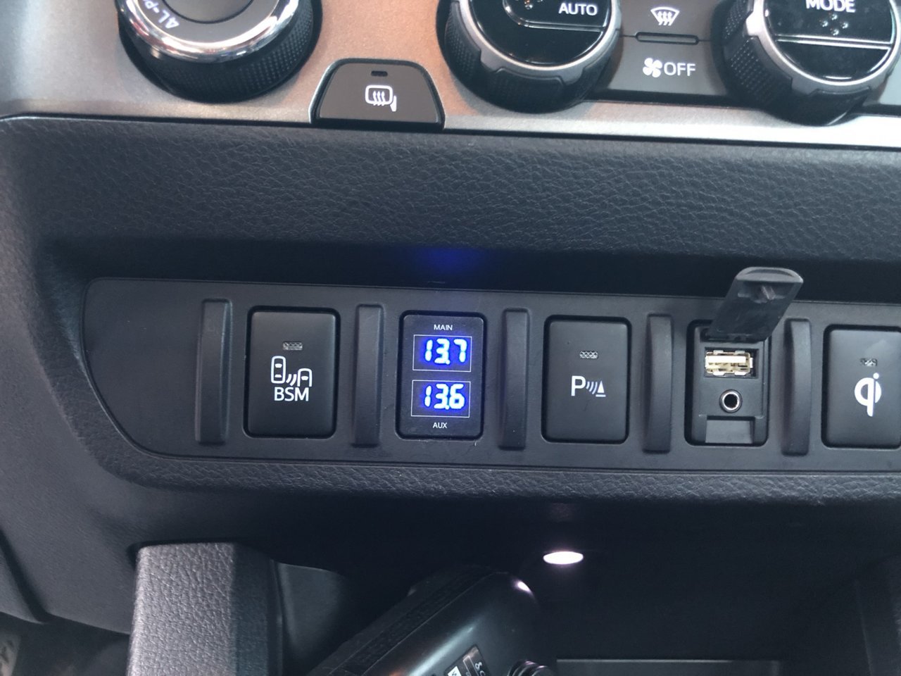

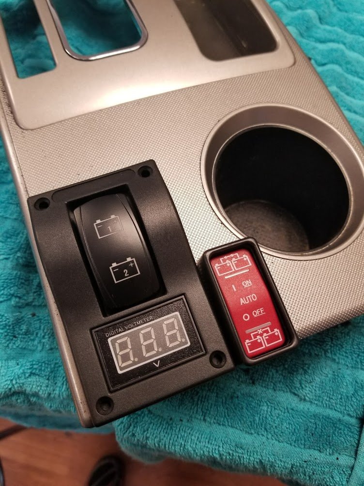

    Just installed my dual battery setup and found a monitor that fit in one of the blanks I had. Like the OEM look.

    link to this unit? do you have it switched or is it on full-time?

    Its on full time, and has in-line fuses. Also, the clear cover is made of no-glare plastic, and it's bright enough to see clearly in daylight. It's not cheap, but I think it's worth it. Link below.
    https://www.solidkit.com.au/product...ta-prado-150-landcruiser-200-2016-hilux-copy/
