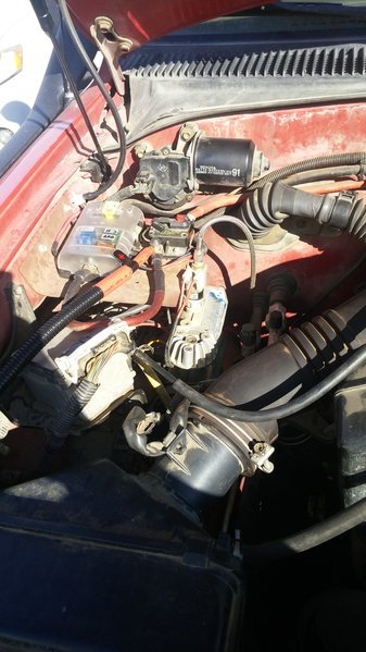

    Icon ext travel expo leafs rear billies 5125 10'' travel bamf bpv relocate Brute Force Fab Sliders allpro ss brake lines f/r LR UCA 22in wetokled bar RAT Products ifs skid ARB rear locker Ultra gauge Redline Hood Struts Blue Sea Fuse box smittybilt xrc 9.5 w/TJM synthetic rope trail-gear rock assault low profile bumper LED bed strip 12v/usb charger in truck bed
    I want a tray to mount where my fuse block is located in the top left engine compartment.1456615004053.jpg

    Come on up! You'll be a perfect candidate for a first-run test fit...

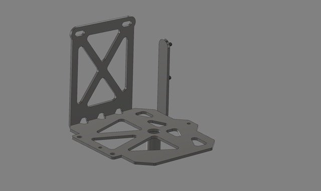

    Alright folks. This thread is becoming worthless without pics, right?!.
    Here is a teaser photo of the 2nd gen Tacoma passenger side battery tray. The tray will be cut from 1/4 inch aluminum and of course have a few other components (tie-down rods, tie down, hardware, etc.). It will require no permanent modification of the truck whatsoever. The fuel resistor that is bolted to the inner fender will simply swing 90 degrees and bolt to the new bracket.... and voila, room for your second battery. Questions, comments, concerns?

    ....what batteries do you plan on mounting in that location with this. Looks great!

    It is designed to work very well with the Odyssey Group 25 or 35 PC1400 batteries. I have also test fit an Optima Group 34 and 35. They also fit well. The Group 35 Odyssey battery will be the focus of most of my designs.
