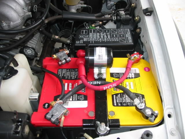

    You hit the nail on the head. Some people prefer to distribute the weight more evenly. The passenger side setup is ideal for that purpose. However, I have been running dual batteries on the drivers side fender for over ten years and over 300k miles. See below for my very first dual battery system that I designed in 03. This is the system that was featured in Overland Journal. (I guess the dual batts in the Taco were less common then). This system lived in my 03, and then was transferred to an 04, and now a very similar system in my 15. I've always run my batteries there and have never encountered a problem or damage to the vehicle. I also have never been able to notice a significant difference in ride height or quality.
    One of the most important attributes of a dual-battery system is a properly deigned tray in which to set your 100+ lbs worth of batteries. A flimsy tray or poor design will allow fender damage.
    So, in short, both methods are awesome... I currently run both! Dual's on the drivers side and single on the passenger side. This is for R&D of course... but it never hurts to have three batteries! haha
